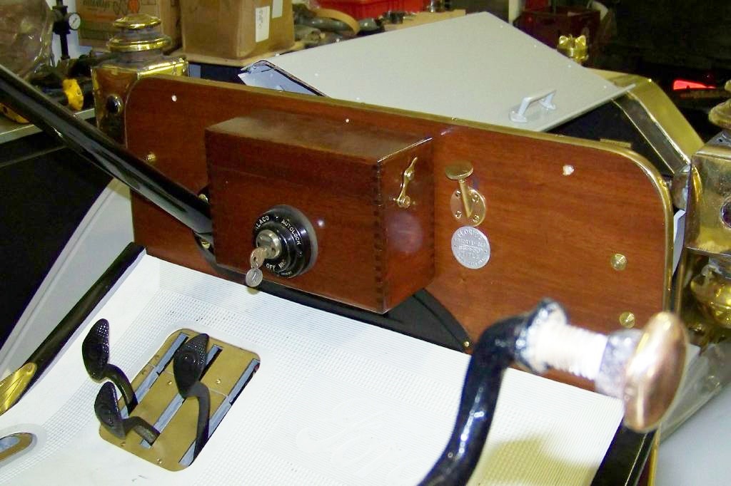

Can someone with an early brass T (1909/10) post a close up pic of their dash without the mat, so I can see how the dash guide and dash shield fit together and where they go? Thanks!

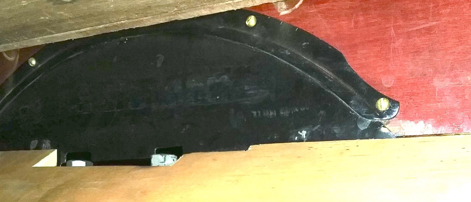

Don't have an early one to photo, but did put the two pieces on my Faux 1909, remembered that the shield screwed to the under face edge of the top floorboard, and the guide screwed to the curvature of the dash board opening. Then you fit the floorboard metal shield up into the guide to lock in.
Here is close of early brass guide on a two lever T

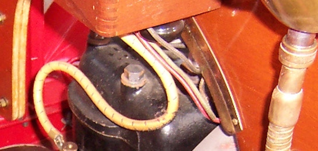

And this one, steel guide and shield later T, off the forum post of years ago, showing the pieces together, fit into one another. Interesting that Gail Rodda's terrific color booklet The 1909 Production Model T, didn't have a close up of those parts, his book has about every detail illustrated
