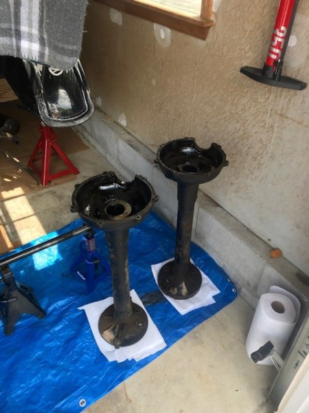

I am cleaning out the old grease from the axle housings after removing and separating them.
After removing the end caps and all of the felts,roller bearings and steel washers, I used gasoline (not near the house) to clean the steel washers and roller bearings.
The original Babbitt thrust washers were in remarkably good condition (for the moment) and are now hanging on the wall never to be used again.
Any preferred methods for removing the old grease and oil from inside the housings?
I am a weekend mechanic with limited tools and supplies but am willing to get a power washer or a good parts brush if needed.

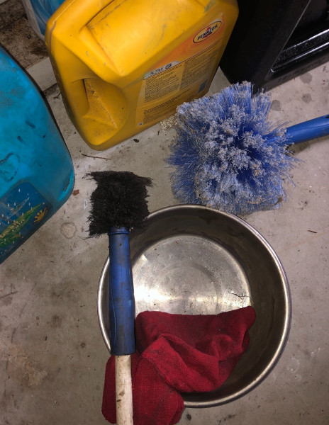

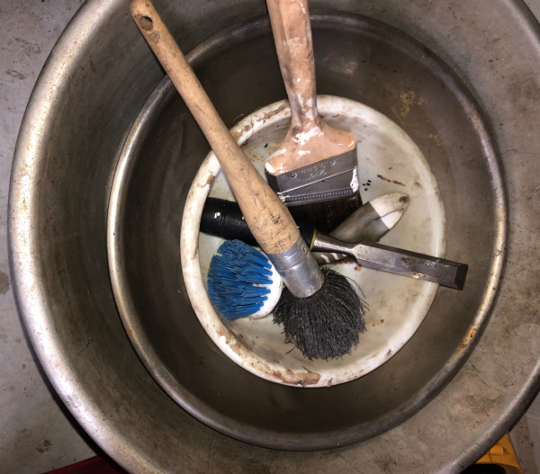

Like Ed, a brush on a long handle works, just used my tool yesterday, does both the torque tube and axle housings.
Dip it in cleaner of choice, kerosene or gas, many swabs, then finish with single rag over blunt end of long handle with lacquer thinner.
Wear your worst outfit as splash and spray will happen!
Cut down the end of one of the wife's used 'spider web' round brushes with scissors, fits into the tubes with ease.
The rest of the 'dirty tools', pans to hold liquids, scrapers, brushes, and all. :)
