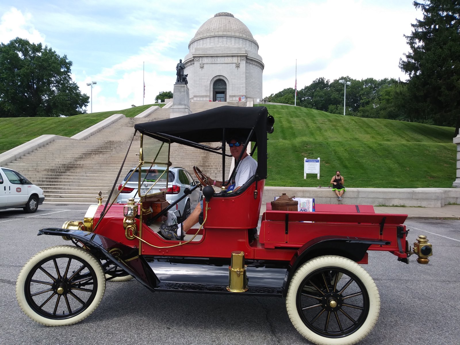

Well, at the risk of stirring up controversy and being the devils advocate, if the red spilled on the can is true, I'm not so sure that is "the Carmine Red" that Ford actually used. In the pic of my former '12 RPU, I sent a copy of it to a tech at PPG, and she quickly responded, "Oh, that's Carmine Red". A bit afterward I saw two very early Ts at the museum that the description poster stated were Carmine Red, and they were exactly as mine looked. Just sayin, not being contradictory here. When it comes to colors, I know how touchy the subject can get, just thinking about just how correct one wants to be.

Tim;
Thank you for posting a picture of your former pick up truck!
The vehicle in the post right above this one is the precise color I'm looking for; can anyone help me find this color?

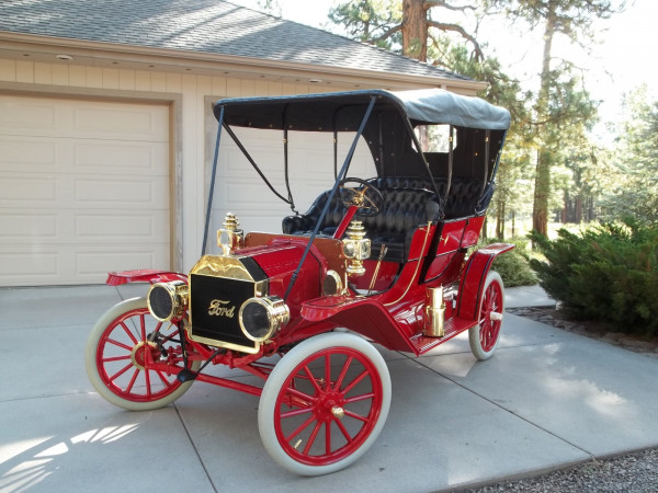

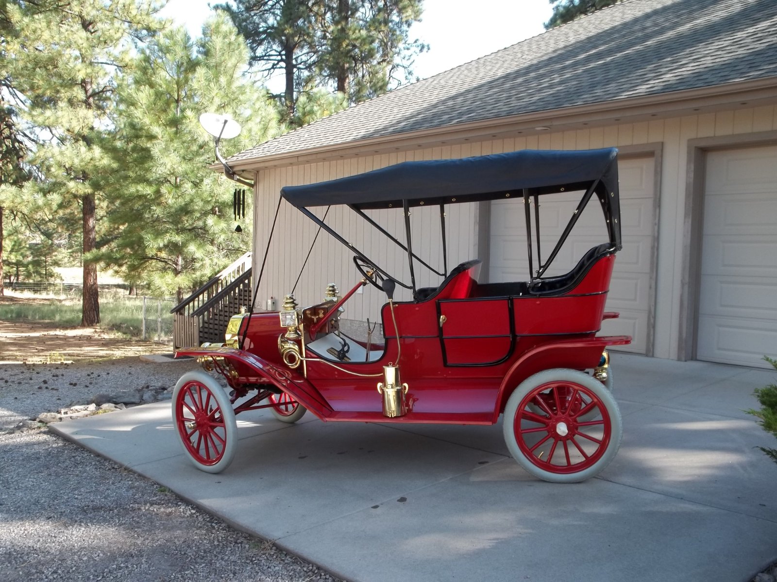

Here is another option for Carmine Red. My 1909 is painted with Nason Ful-Thane CG2911B, Red. I hope this helps. Russ Furstnow
