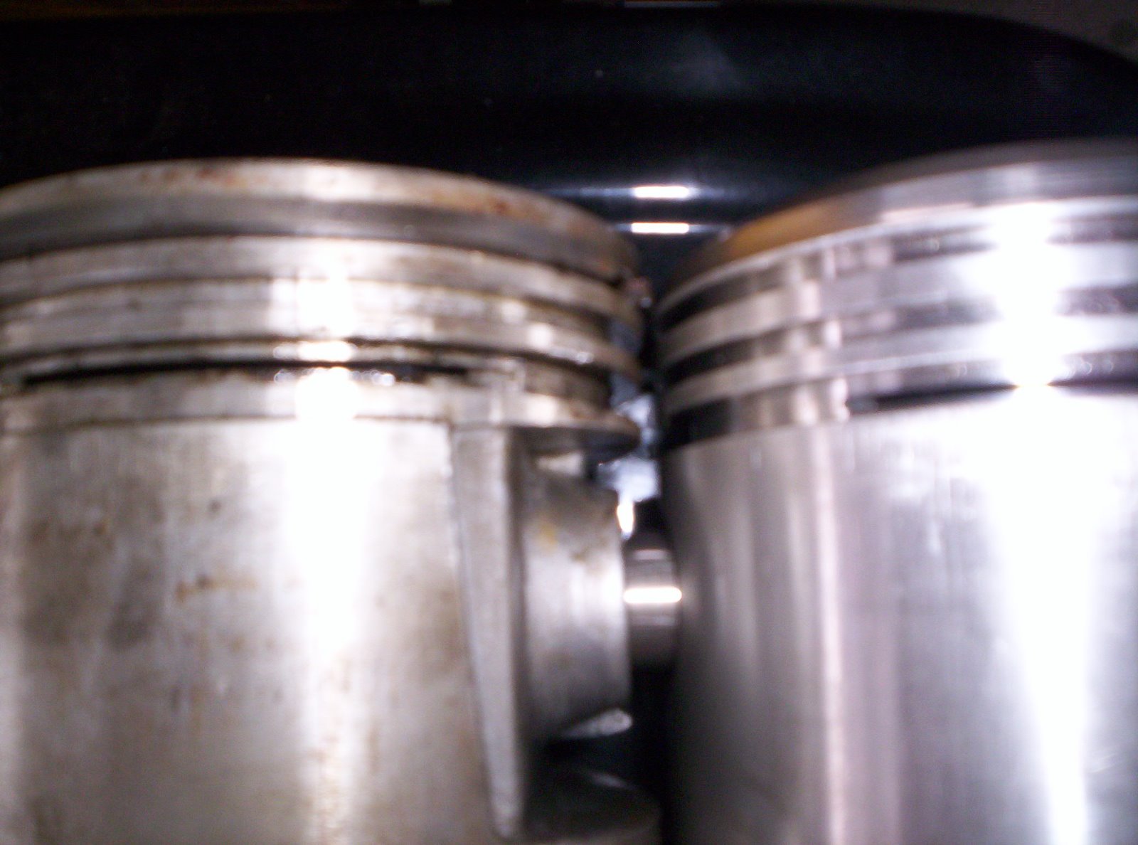

Re: Erosion of Headgasket Surface
Hand brake any idea that any more than a light decking would be a good idea for a T block
T blocks have no wear lip in the bore for a reason, the top ring comes up flush with the deck on cast pistons and only a small fraction off TDC on aluminium ones.
Depending on make of piston, always check;
This photo shows the piston on the left that popped the ring out at TDC

Kerry, In your photo the piston on the left looks to me like a Model A piston, I am unsure of the compression distance difference between the
A & T piston I know the wrist pin is larger in diameter on the A. The piston on the right looks more like the ones I have. Thanks for your reply. George
Kerry
- Posts: 1461
- Last Name: van Ekeren
George.
Don't know the origin of the pistons but are T STD bore size and wrist pin size.
The engine was recon many years ago and left in storage, brought to me to check out to be used. What a mess it was
never would have ran the way it was.
