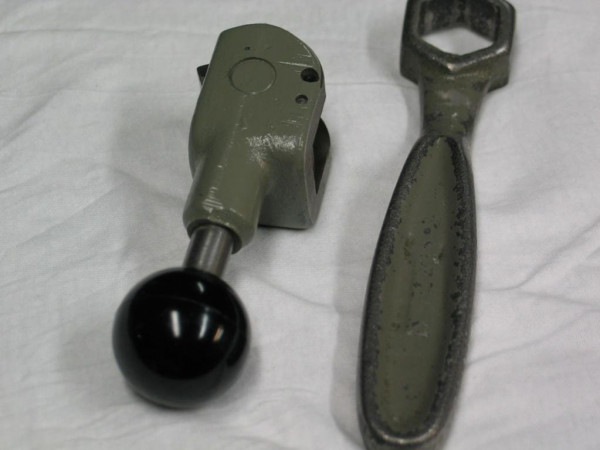

I looked Chad! That bottom Chevy engine pic of Ed's on RDR's thread and a couple I've seen over the years were painted a similar drab green.
The '28 Chevrolet engines here only show rust, best as I can tell. Hunter Green would be far too dark like you kinda mention.
Shoot, I've never even seen a Fronty head with my own eyes...
Would you tell more about "machine gray"? IF like a Battleship/City of Montreal gray there may be more blue than you wish for.

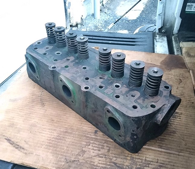

Another source emailed me stating he researched this over a decade ago and black was the color, but he forgot how that statement was backed up.
The black might make sense, under the layers of paint on mine was indeed much remnants of black paint that was on there like it was welded. Took the bake and blast machine at the machine shop to get the head spotless.
Duey, the "machine grey" I have seen over the years is just your typical grey, but has a slight olive drabe tint to it.
Remnants of black after the initial parts washer cleaning on my "T" Fronty head:
If indeed single port heads such as mine were a different color, I find that very interesting.
I know it probably doesn't matter to most, but now that I have been researching it, it matters to me. No one has documented this to the best of my knowledge.

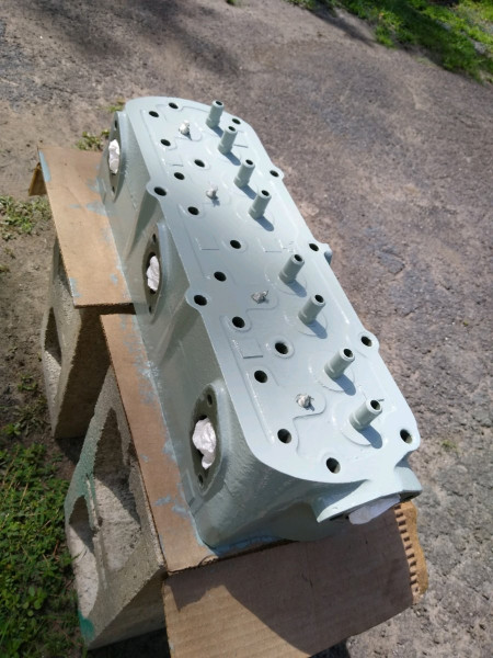

Just for future reference, The paint was mixed and while the color is hard to pickup with a camera and on screen, it is what I call "machine grey", or a very light mossy green. it is a grey green color, popularly seen on large shop machine equipment.
This is to my best research over several weeks, the correct approximate color for all the single port Frontenacs.

I kind of like the "no-nonsense" industrial look of that... So we have single ports at Greenish Grey, and (I'm assuming) a reddish Chevy Prange (?) on somehting like the R's and SR's?
Curious, as I have an SR head that might start the long road to recovery as time permits. (right now it's just the head itself - no towers, valves, etc.) It looks like it was painted on the outside with white Sherwin Williams House Paint, which I was pretty sure not right.

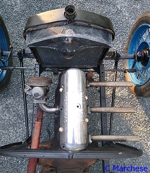

I do agree, The shop bill wasn't hard to swallow, about what I figured actually. Plus add in all the rest of the parts, It adds up real quick. I don't think alot of the people consider the total costs to do machine shop work. I didn't get the head cheap, but I think the price was definitely fair (even though I had to scrape the couch cushions to come up with the money).
If you don't need dead on accurate period looking fasteners, ARP Fasteners makes quality stuff, I just ordered up head studs, nuts, and washers. Alot of people say the long Model A studs work fine, To me they came up a little short on the length. I bought 6" long studs, everything shipped was $170. It has been pretty well documented that using head bolts usually results in leaks at the head gasket, but the studs work out fine.
Oh, I wasn't trying to talk you out of it, I just wanted to say IF you ever decide, give me a jingle. I know these parts are precious commodities.
Mock up pic from a couple months ago. I just ordered the custom pistons from Ross Pistons, 7.5 to 1 compression.

OoooHhhhhh Eye Candy! The American Dental Association approves as a "NO CAVITIES"!
