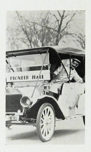

About five years ago, I found a photograph of Darel Leipold's 1910 touring taken in 1937, taken long before he purchased the car in 1946.
I was at a Twin Cities thrift store and I spotted a 1938 University of Minnesota yearbook so I decided to browse through it.
I kid you not, but when I opened the yearbook, the very first page I landed on had a picture of a Model T taken during the 1937 homecoming festivities. I immediately recognized it as being Darel's 1910 touring so I purchased the yearbook.
When I got home, I went on the Minnesota Historical Society website and searched for photos related to the 1937 U of M Homecoming and found a photo of the homecoming parade, which included Darel's car, taken in downtown Minneapolis.
A week or two later I saw Darel, put the yearbook in front of him and had him look at the Model T on page 40. He immediately recognized it as his car. Darel had never before seen the yearbook or parade photos; he now has possession of the yearbook.
1) 1937 homecoming photo, page 40 of 1938 University of Minnesota yearbook (Pioneer Hall is a dormitory)
2) close-up of the above

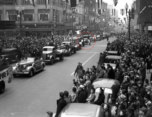

3) 1937 homecoming parade in downtown Minneapolis - Darel's car is circled in red

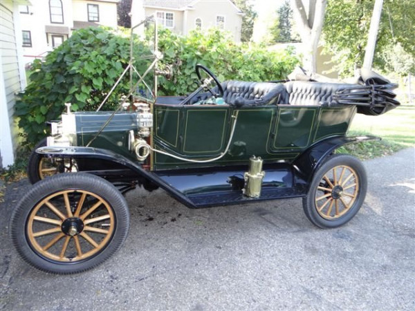

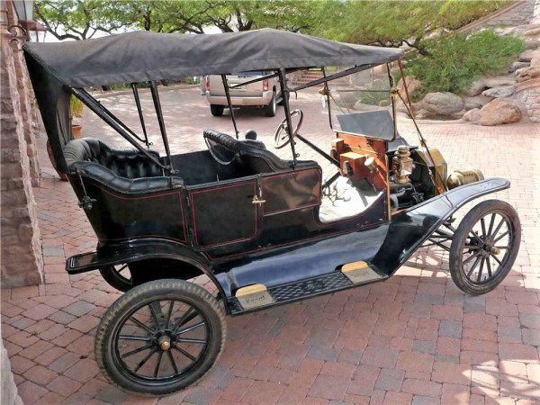

Googled 1910 Model T Touring - picture titles are not confirmed to match photo.
The circled one sold for $18,700 at auction https://www.barrett-jackson.com/Events/ ... ING-117665 Their description says its Black but its not - as seen in one of the detail photo's attached

Re: Color for my 1910 Touring
That’s a1911, metal covered door.Some of Ts at that time were “midnight blue”
- Posts: 6338

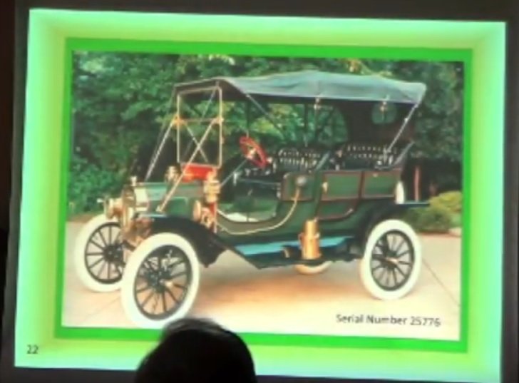

The photo I provided was listed as a 1910 by Barret-Jackson and sold
wonder if the sale was disputed. Anyway, I dug up a photo of some of Craig Beek's cars here in town. I am certain that the colors are 100% correct.
