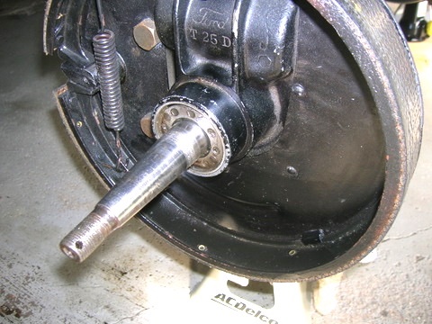

John,
you may know it but it missing one spring in your brake shoe... Just in case. That occure to me sometimes forgetting things like my keys, wallet, phone or a cutter pin as well. :lol:

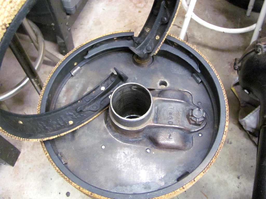

Have good success with the brass fiber woven stiff like linings from the vendors.

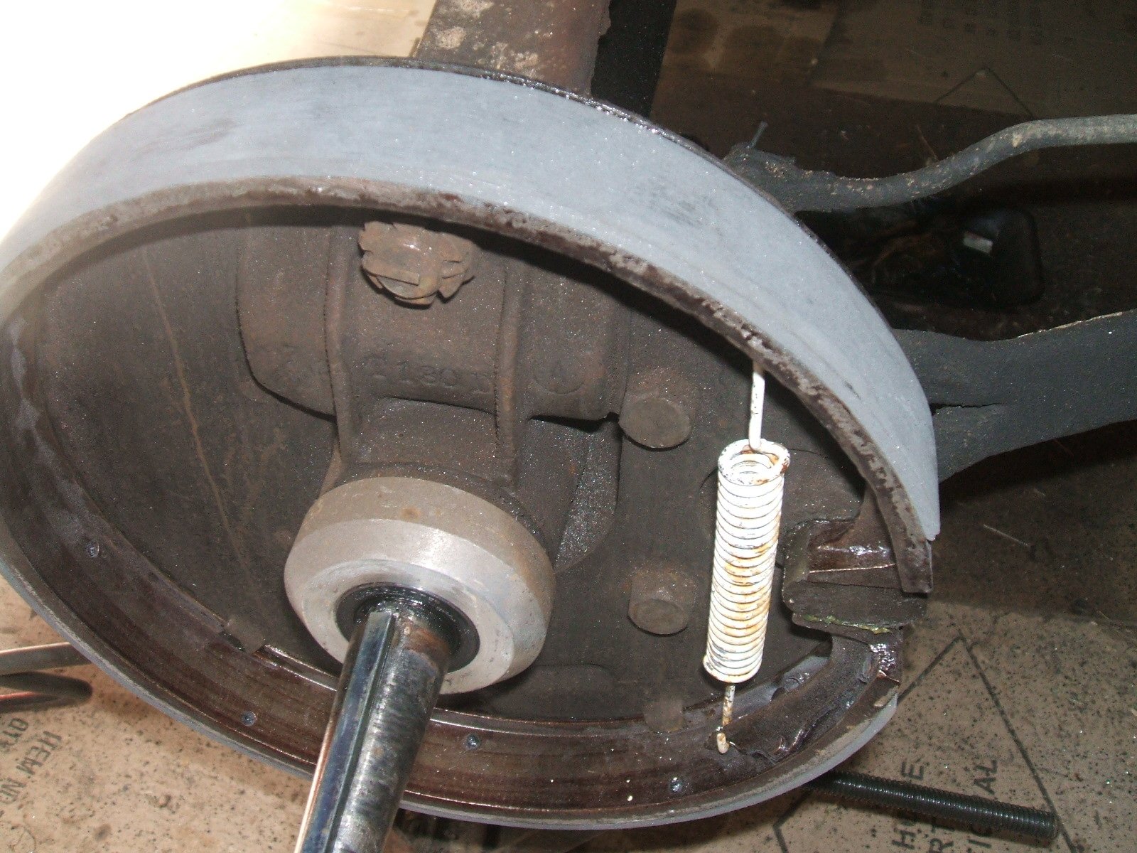

And these large drum emergency brakes for the '26-'27 only use one large spring.
