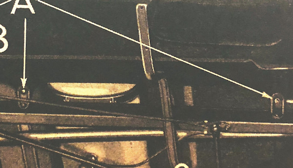

Likely an early T assembly process to place the bolts up into the body. Sure seems difficult, but maybe the early bodies were easier to fit that way.
Here is photo of and award winning 1911'ish, note the bolt head is under the body bracket.
For later production, shown and described in Ford Service, the step @ paragraph 135, " Insert the six body bolts through the body and body brackets, running down the lock washers and nuts on the ends of the bolts." Appears to have nuts under the chassis.

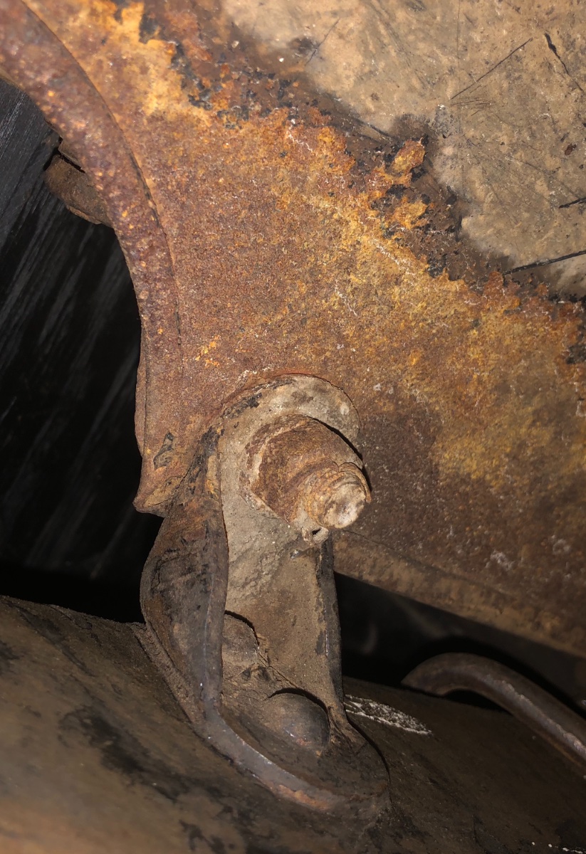

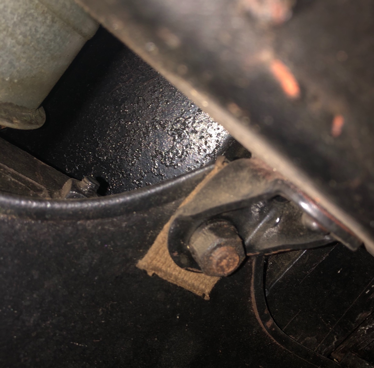

My '25 was like that when pulled for restoring, put the lock washer and hex nut back as original (fabric webbing is add on for anti squeak.
However, the '23 cutoff is all original, never had body off frame, it has hex nut with lock washer under, but the bolt had hole and it got a side ways cotter key! How the Ford was assembled is a big guess on some of the details
