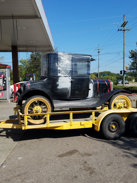

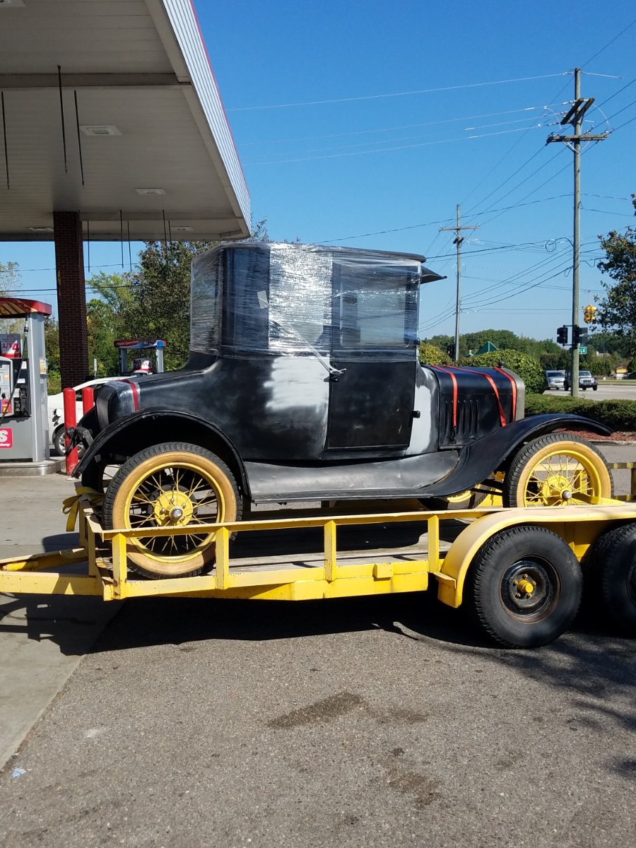

Here is my coupe. 70 mph all the way home.

In the picture of Dallas' coupe on the yellow trailer, The cars engine is over the front axle of the trailer and the rest of the car's weight is forward of the axles. This probably towed nicely, and may have actually had a little too much tongue weight. It appears to be about a 20 foot trailer with tandem axles and brakes. Load a car backwards like this on a short "T" size trailer of 14 feet or less (like many people own) and the towing dynamics change drastically, especially if it is a single axle!
