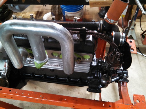

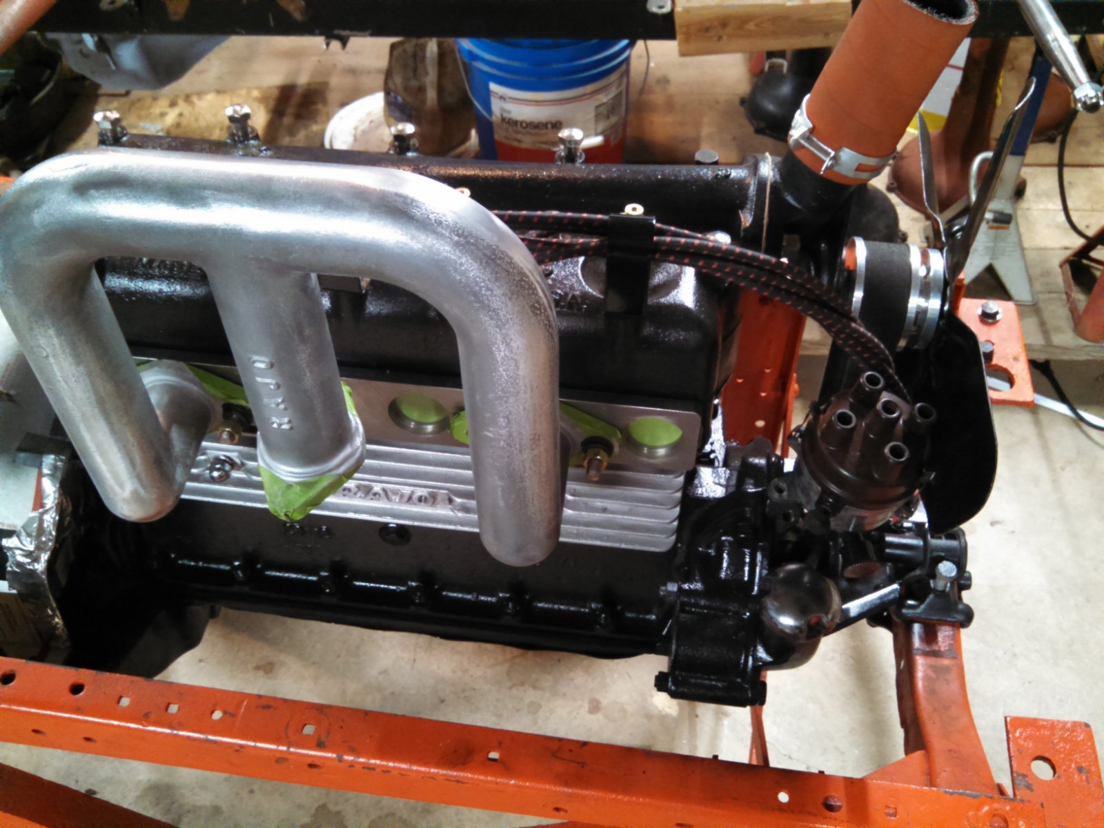

Post by TRDxB2 » Mon Feb 18, 2019 10:27 pm
I am using these Rust-oleum Clear products as appropriate; manifild and other engine parts as I go.
In the process of a build so I have no results from heat exposure. The engine enamel is good to 500 degrees and the High Temp to 2000. Hard to get locally - online at ZORO (500) and Summit (2000)

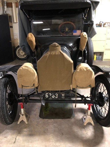

Re: Brass radiator... clear coat?
Post by rnkugel » Thu Feb 21, 2019 11:04 am
Greg-
This is what I have. I do have 14 headlamps, that's why those covers look bigger than for a 15 headlamp.
1915 Touring
1926 RAJO Speedster

Maybe one other note. I do not put cover on radiator after use. I wait until the next day so it can cool down.
