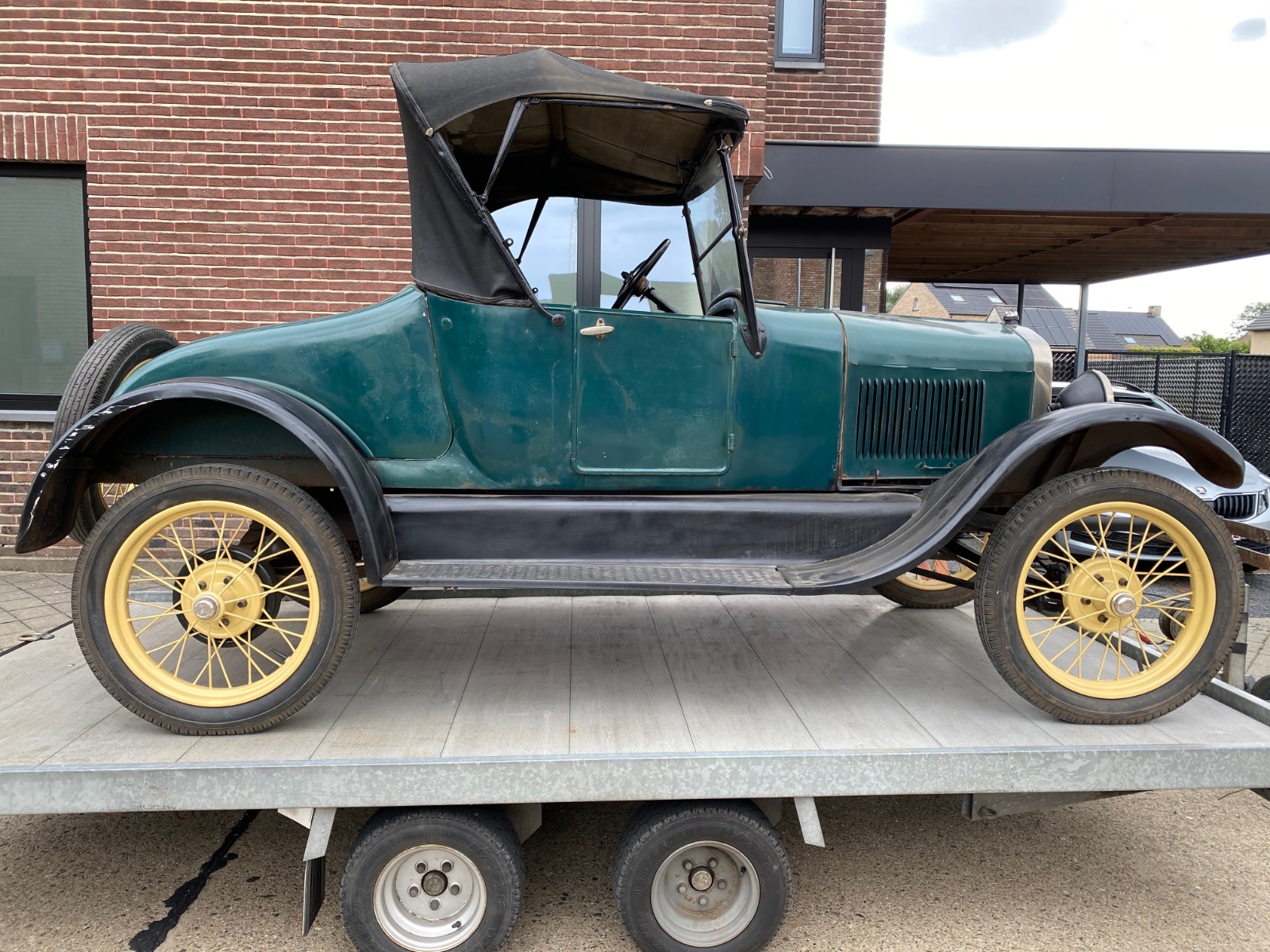

I picked up this 1926 roadster last week. It came without a battery. I’ve read here that model T is negative ground. The battery clamps however suggest that mine is postive ground (one connector is slightly bigger).
I hooked it up as negative ground. Engine starts, if I switch on the headlights, amperes go into minus, so it seems that I have done it correctly. I cannot imagine that an engine would start in opposite direction?
Is there another way to check?
Thanks!
Thanks!
