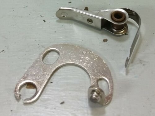

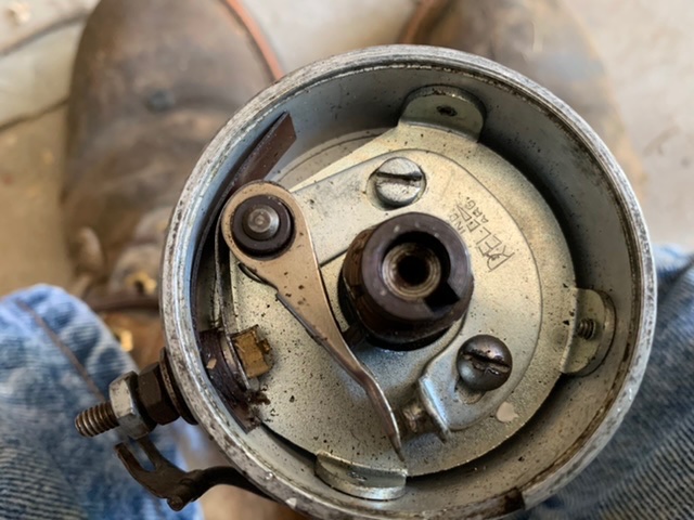

Anybody here know what these points fit? There are in distributor for a T. Made in South America.
Has RELO Ind ARG stamped in points. Nothing on distributor.
Any help appreciated. Thanks Dan

looks like they fit old Delco distributors.
https://www.ebay.com/itm/332654003503
Posts: 5564
Last Name: Hatch
Location: Alabama
Re: Looking for info on points
Post by Dan Hatch » Sun Aug 02, 2020 12:44 pm
Think you nailed it!! Thanks

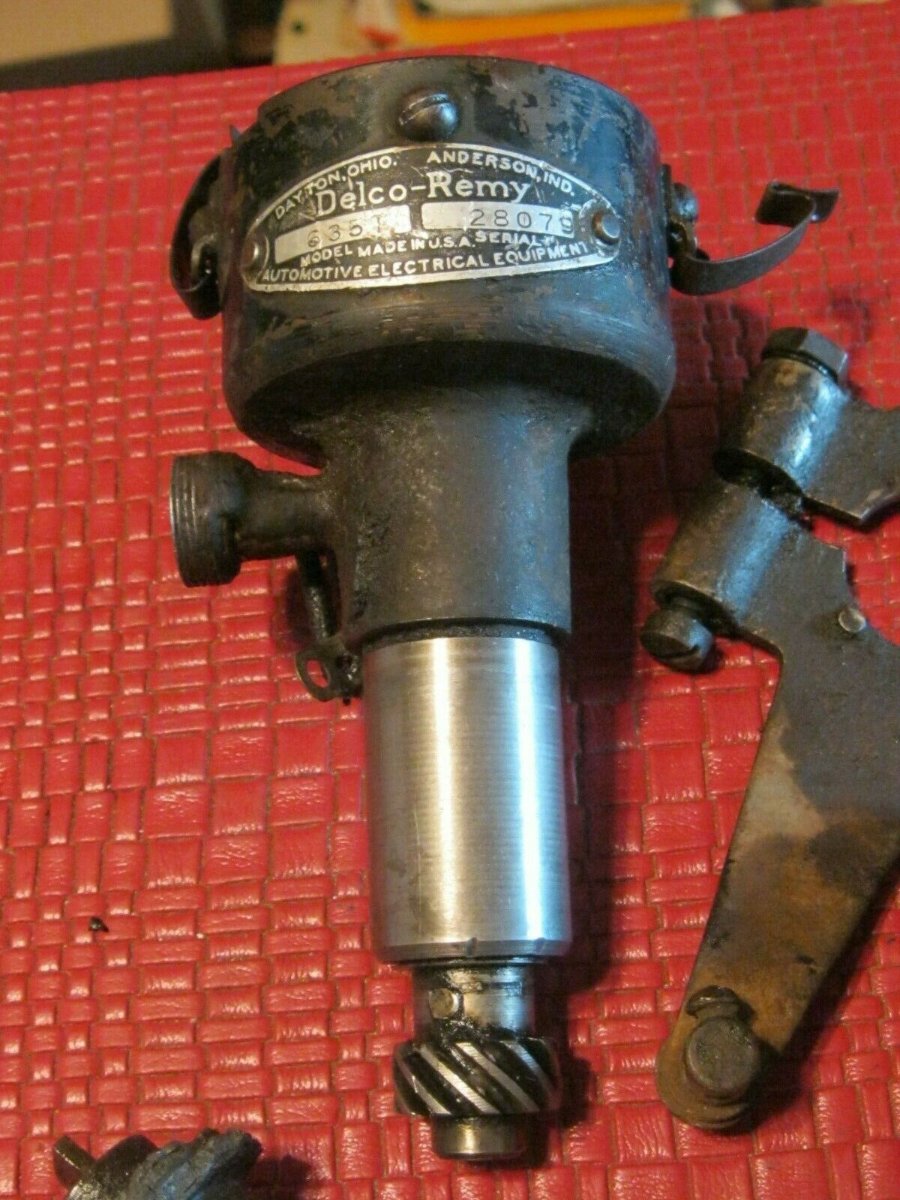

Dan, The 1929 Plymouth U distributor number is 635T. The Delco Remy part number for the points was 1855520. George

Does anyone have a distributor drive off of one of these. I am wondering if the gears Plymouth used are the ones I am looking for.
From what I have seen, they used a right angle drive for this distributor.
Thanks Dan

there's also one of those on ebay, lots of pictures
https://www.ebay.com/itm/193590783720
