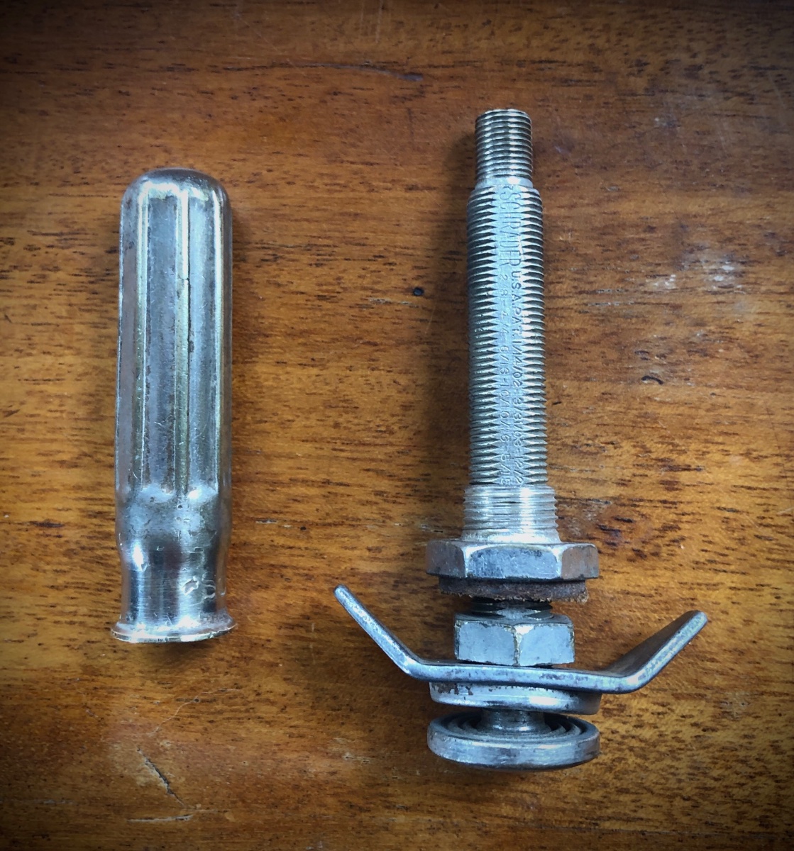

Well, I can tell you about the original style. I just started cutting off the rubber factory stems and installing vintage Schrader type 777 stem assemblies and caps. A lot of fun.

That's a problem. If you can find them, old metal stems are the way to go. They don't have to be vulcanized.

- Posts: 3913
- First Name: Larry
- Last Name: Smith
