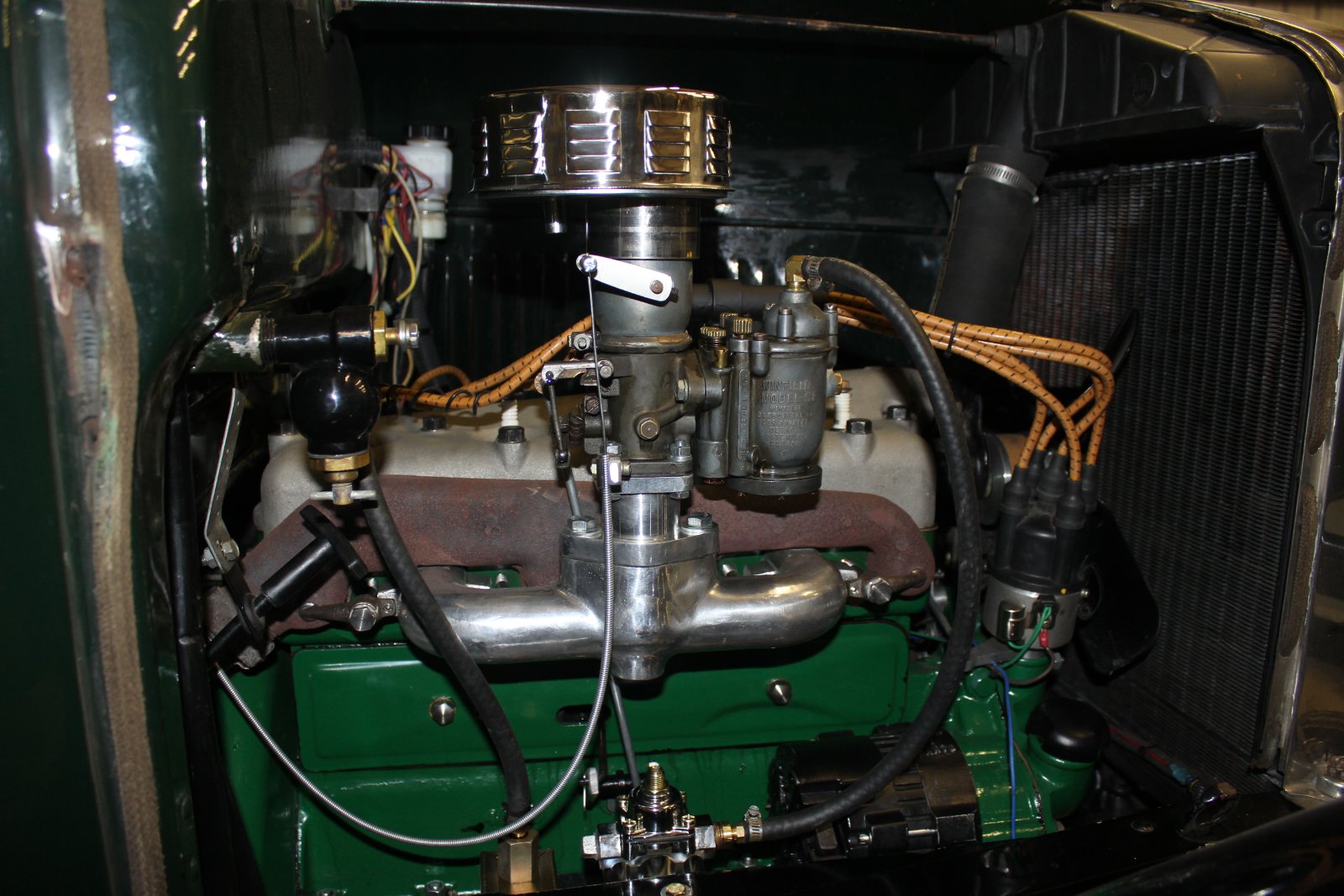

I thought I'd try a downdraft set up for my 27 Tudor. I used a Antique Auto Ranch 300 Race cam, chevy valves, Prus head 80 over pistons and every engine and trans part is balanced. The carb is a Winfield RS. The intake manifold is one of the simi finished parts and is larger that the stock manifold. The exhaust manifold is stock but the pipe is 2". I also put a large oiler to the front. It pulls mountain grades as I had hoped but is a little temperamental on the idle and when cold. Sense we have guys with lots of experience on this thread anyone have any ideas on the low end issue?

I run a SRBD on my RAJO BB and with the humidity here on the coast, I had to run a "heat" pipe into the throat of mine. The SR's seem to be a bit finicky anyway !
