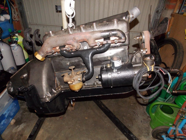

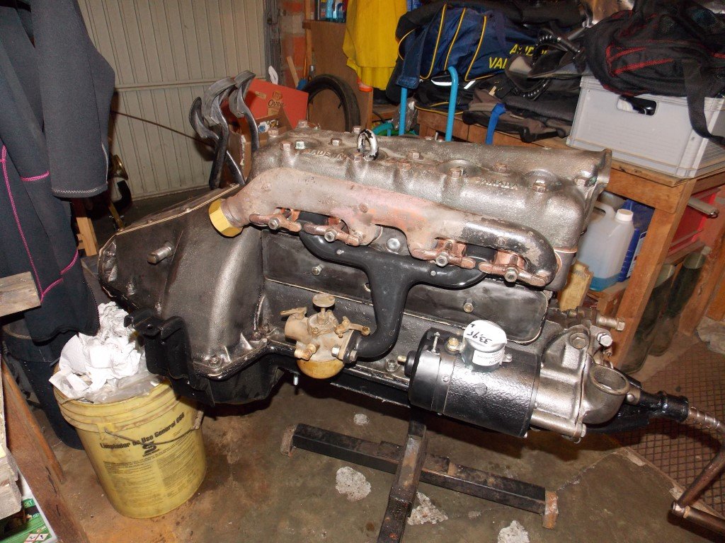

If your engine is a 1927 you can easely find a good working generator and mount it on the engine the original way. No belt needed!!!
Andre
Belgium
