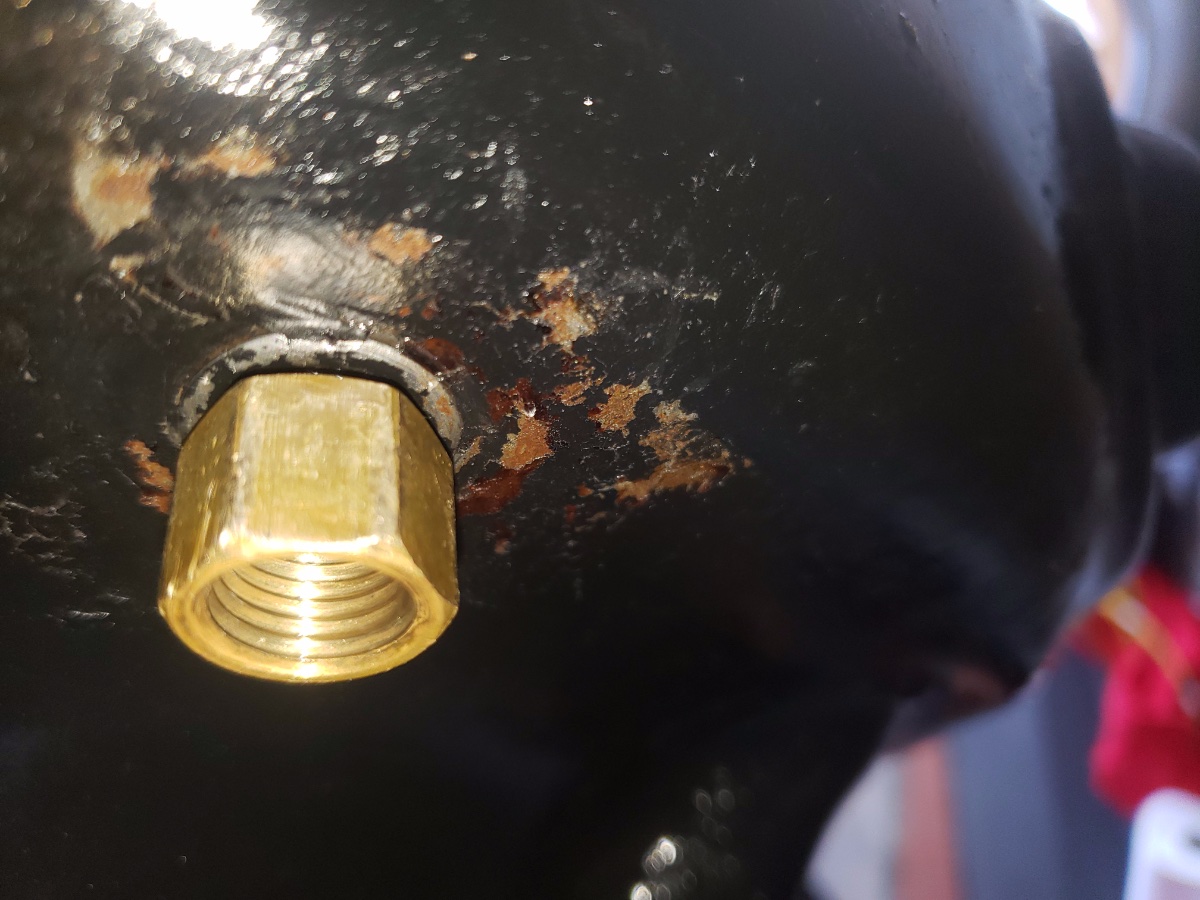

Here's a picture. This Forum will not allow me to post a video of the insert spinning around as I turn the brass fitting counterclockwise.

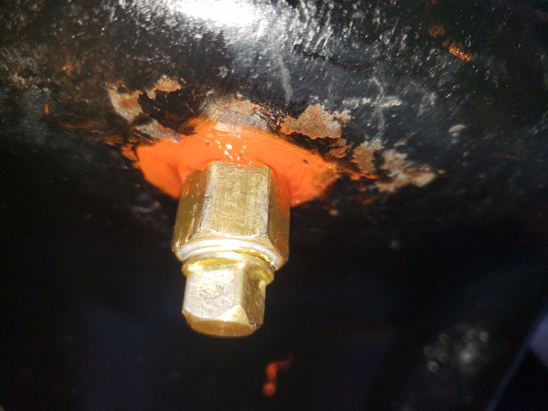

I went with the "Romona T.B." temporary-permanent fix. High temp gasket silicone. So far it's not leaking. I will fill the oil pan up to the upper petcock until such time I need to pull the engine for other reasons. Thank you all for your generous guidance.

These were inserts that were swedged and brazed until sometime in the mid teens. Then they were inserts that were swedged and NOT brazed for a few more years. Then they were changed simply to a hole that was punched inwards and the “bent in” steel hole was threaded.
The one you have is the “un-brazed” insert. There really isn’t anything you can do with it other than the temporary repair you just made. If it spins, it will leak. Levering around on it or fooling around trying to “fix” it from the outside could make it fail altogether, so you probably did do the best thing.
Every time I work on that style pan, I braze them in place from the inside.
