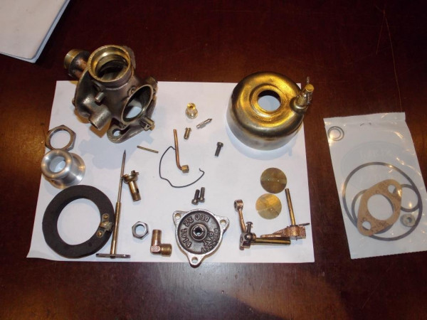

Nevin,
silicone is not the right stuff to use when rebuilding a carburetor. What you need are the right gaskets and parts.
What looks great on the outside isn't always right on the inside.
What you need to rebuild your carburetor are in the photo.
you can do the rebuild yourself but do not use silicone.
Good luck
