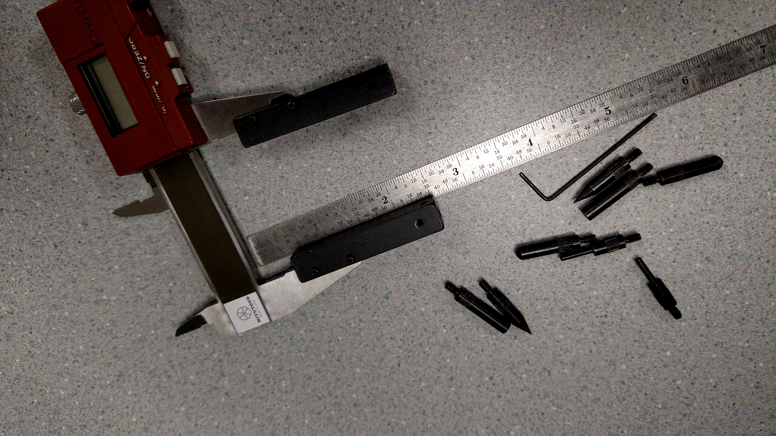

I have a caliper accessory kit to extend the reach of my calipers. It extends the jaw's reach to 2 1/2".

0-200-mm-outside-groove-caliper-with-flat-points-vernier-caliper-stainless-steel-measuring-instruments.jpg_350x350.jpg
0-200-mm-outside-groove-caliper-with-flat-points-vernier-caliper-stainless-steel-measuring-instruments.jpg_350x350.jpg (6.79 KiB) Viewed 3965 times
I did not know they made a caliper like this. Might be the way to go. Another suggestion came in to pull off the ball cap to see what the inside dimensions are. If worn, then a standard size would work to reduce the leak, even if the shaft is worn.
