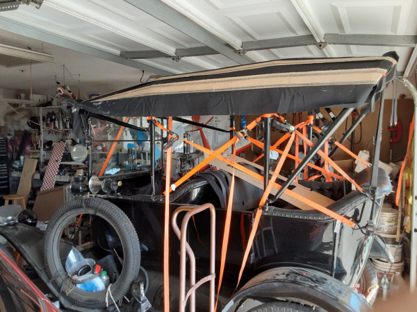

With no experience with upholstery and "backyard" and motorcycle tech training in repairs, I put a top on my 23 touring. I agree with the concerns about the cold winter work. the fabric should stretch as it's put on. That being said, you can certainly do all the preliminary work, setting up the bows, tacking strap across the underside of them as you anchor them in place, then heat the shop to 75+ degrees on the day you install the fabric. Good luck. I'd consider giving a hand if you weren't so far away.
