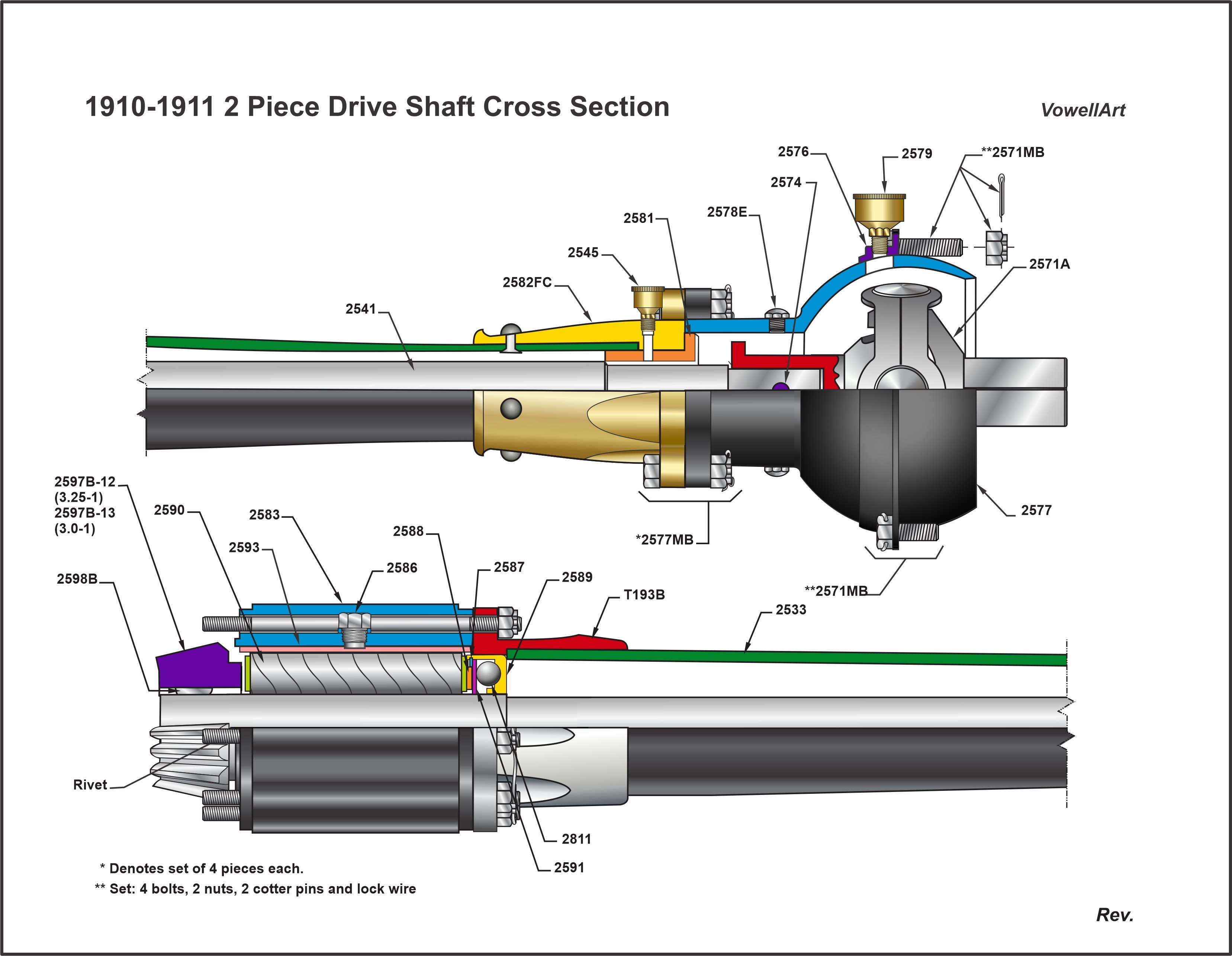

The hardened sleeve 2596 didn't appear until 1911 with the tapered end driveshaft, where the pinion gear is held by a nut and cotter pin, instead of the pin rivet arrangement.
The Driveshaft has a hardened end step that the roller bearing 2890 ran on (not sure how, probably case, it would be easiest). I'm assuming that it was deemed much cheaper to make a separate sleeve, harden it and just press it onto the end of the shaft rather than this method, which I can see there being some problems with, especially fitting that rivet.
***1910-1911 2 Piece Driveshaft Cross Section***

Re: ***1910-1911 2 Piece Driveshaft Cross Section***
Slight change, had to change the lock screw 2586 (a bit too short).
Slight change to spool and thrust bearing.
I think this may be the what this looks.....
Doesn’t the Universal Joint run against the bronze thrust / bush in the earlier units?
Martyn.
Looks perfect to me! Thank you for the great work you do with your drawings
Alan in Western Australia
