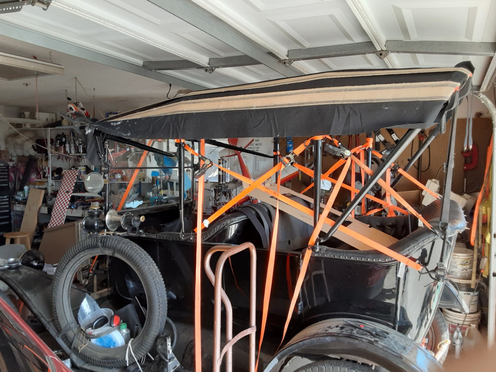

Just received my Classtique top in the mail last week and am working on laying out everything needed for installation.
I'm definitely thankful for all of the videos and writeups there are out there! I feel like I've virtually installed the top several times already!
Good luck with yours:)
