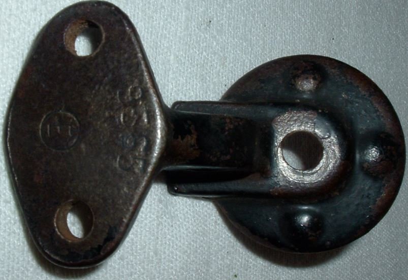

What is this light bracket for?
I just saw this on the internet and thought I could find out what it is for.

Re: What is this light bracket for?
1915 or 1916 Ford roadster tail lamp bracket. It's missing the license plate bracket.
I was thinking more like the side light bracket off a TT.
Erik is correct.
Actually - it's a '15 - the 1916 brackets were riveted together.
It looks like a sidelight bracket to be bolted onto a flat front aftermarket body.
A good picture from a side angle would confirm it either way. To me it does look like the '15 runabout tail-lamp bracket missing the license plate extension (I have one for my '15 runabout). At this angle, I cannot really be sure.
I believe it is like these.
http://www.mtfca.com/discus/messages/29 ... 1205786476
I agree with Wayne. From the above photo, it looks to me like it was made that way.
