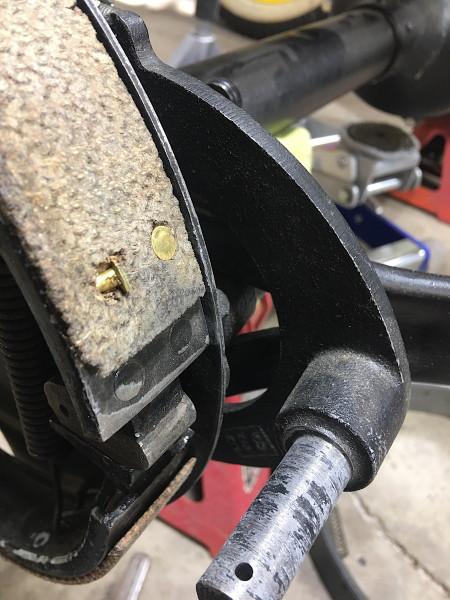

I am examining everything the previous owner did while restoring a 1927 Tudor
When looking at the rear emergency brake, I found several rivets that were bent and dragging on the drum. But i was more taken by the direction of the rivets. Instinctively I would have wanted to put the rivets in the other direction, with the head on the metal band side and the split rivet through the band material like is done on the transmission band. This way would seem to leave a lot of head to drag on the drum as time goes by. Obviously he didn’t sink the head at all, but even then, the other direction would seem right to me.
Which way is correct for the rivet? Thanks

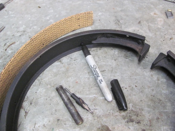

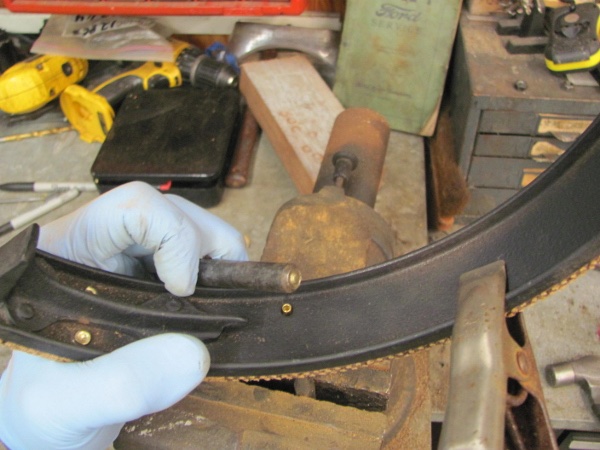

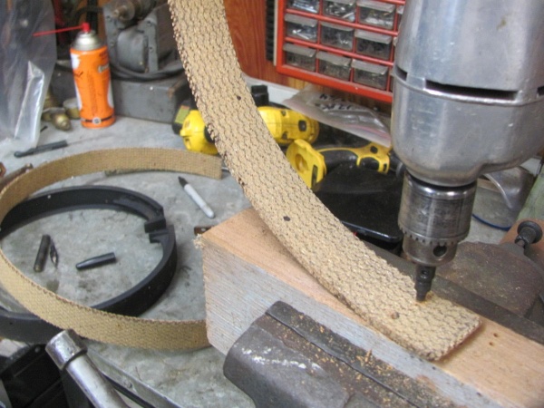

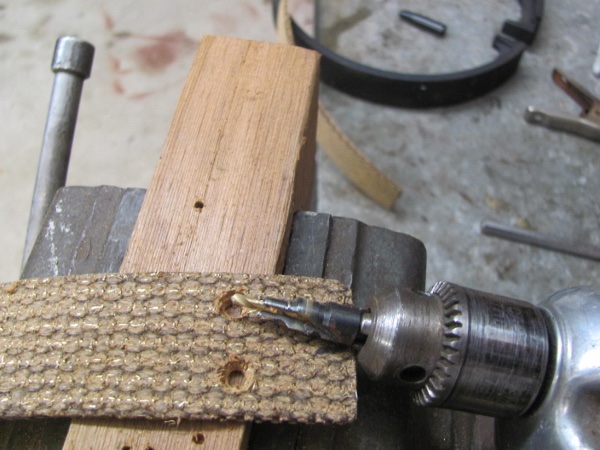

For a quick photo look, mark the hole locations, then drill pilot hole thru lining, then countersink hole 1/2 way into lining from top side. Rivet with head sunk in top side, and crimp the special hollow rivets on the brake band side.

Pre-drilled linings used in any other application come with a hole which is flat on the bottom. This allows the head of the rivet to sit well below the surface of the lining. The countersinking tool provided in the Lang's kit looks to be an ordinary wood screw countersink, which will not allow the rivet head to seat far down in the hole. I would be sharpening a drill bit at a much lower angle to correct this.

The 1926-27 hand brake lining kit I bought years ago, from Synders I think, came with the correct flat bottom counter sink, worked great. Current example of repo parts shows the problem with some of today's stuff !
