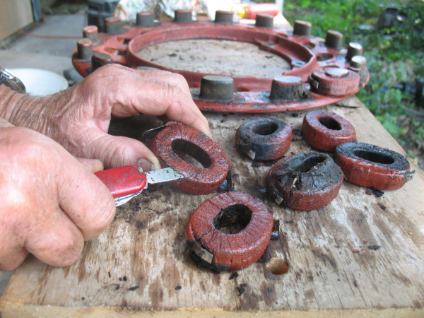

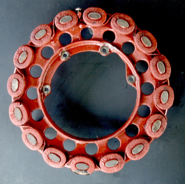

This week I made some boxes to hold magnets.

Oh, that is NICE!! Well done, and somehow I suspect an improvement over the original!!

Thanks Susanne. I haven't built any bodies or coil boxes lately and had to get my woodworking fix. Those rusty coils don't deserve a box like that.

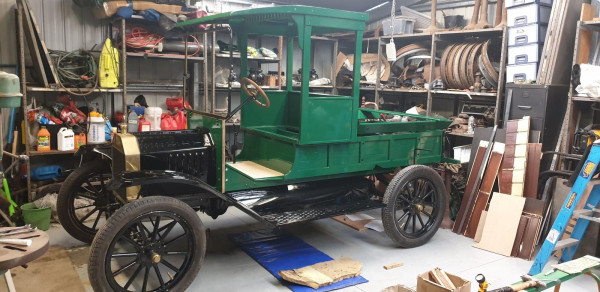

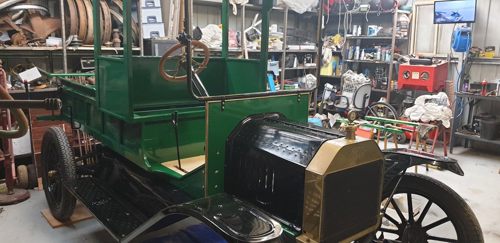

Been working on finishing my 1916 Pickup project.Hopefully will be driving soon. Need to get the rear fenders on, glass in the windshield, windshield support rods fitted,fit all the lamps and do some wiring.

Looking good!

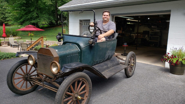

After body being separated from frame for a little over a year, we placed them back together after a thorough mechanical review of the chasis. Fenders, running boards and splash apron were removed when i got it. This the the first time this cut down touring has had the body and those parts on the frame together since sometime in 1965.

What a terrific little pickup. You have a great sense of proportion and detail. Well done!

It really has a great look to it Andrew....I love it.Retro54 wrote: ↑Mon Aug 10, 2020 12:24 pmAfter body being separated from frame for a little over a year, we placed them back together after a thorough mechanical review of the chasis. Fenders, running boards and splash apron were removed when i got it. This the the first time this cut down touring has had the body and those parts on the frame together since sometime in 1965.

Thanks! It's going to be a fun little pickup once we are done with it, wearing it's working cloths just like a farmer in 1920-somthing would have done. And likely did do.

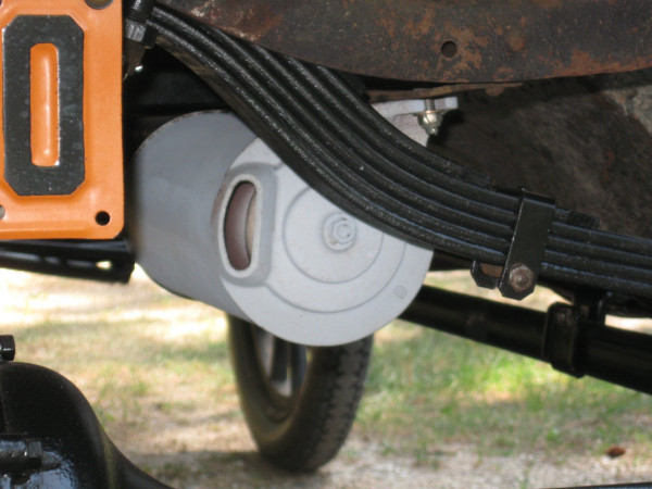

So far this month I've added a battery disconnect under the vehicle, doing it on the battery is a real pain in the butt. I learned along time ago on the farm never store a vehicle with the battery connected. Fire can happen, damn chipmonks.
I also change two bad springs on the transmission. I wish I had done it when I had the hogs head off but didn't realize how bad they were until I went to adjust the new band's. I want to thank who ever it was that suggested stuffing foam in the transmission when doing this. This kept me from losing the nuts and washers. If I ever do this again I'm gonna hire a child to reach in there and put those things back on. Ugh

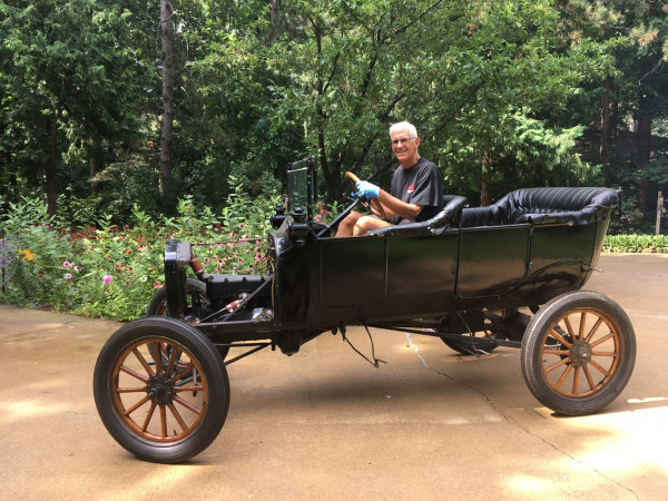

Yours looks somewhat like mine....I like your cut off touring!Retro54 wrote: ↑Mon Aug 10, 2020 12:24 pmAfter body being separated from frame for a little over a year, we placed them back together after a thorough mechanical review of the chasis. Fenders, running boards and splash apron were removed when i got it. This the the first time this cut down touring has had the body and those parts on the frame together since sometime in 1965.

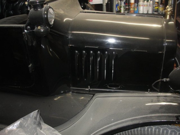

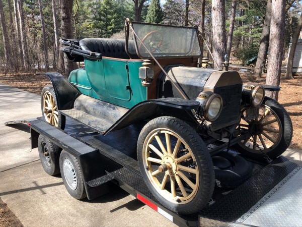

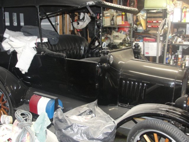

After a 20+ year hiatus I got this recently purchased 1919 running......

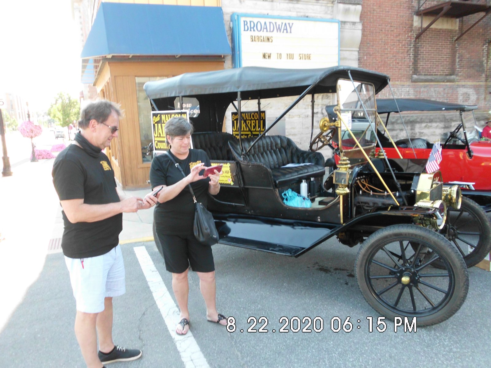

Today I bought a new battery for the old Coupe. The old one was working fine and 4 years old. I needed a battery for a later Ford I'm playing with and it doesn't need a new one, just one that works for now. The other car is positive ground so maybe I will gain something with the juice flowing the other way.
OK. Maybe not.
It seemed like a good idea to be changing it while the weather is good too. Usually they go bad when it is cold.
When I went into the store a youngster about 12 or so and his mother asked if they could look at the Coupe. They were still there when I came out so I told him he ought to get one and there were always some around for sale. He had the look in his eyes. There is always hope.
Between driving the Speedster earlier and then the Coupe we had a lot of people smiling, waving and taking phone photos. I'm glad others enjoy the cars too.

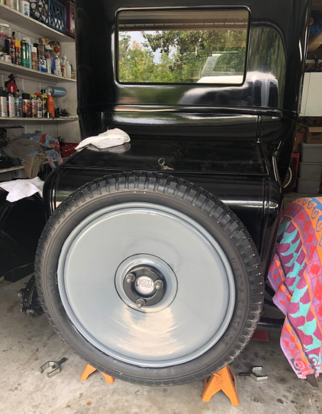

My son and I replaced a hub. Nevermind the Chevrolet hub cab. It's a Model T wheel.

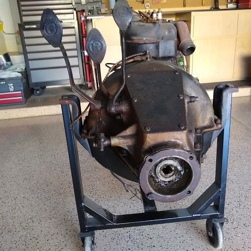

I'm preparing to remove and rebuild my front axle. I decided to loosen a few fasteners before raising the car to use its mass against stuck fasteners. I loosened the nut at the bottom of a spindle bolt, which took a long wrench for leverage. When it finally started to turn freely I noticed a gap between the lower spindle bushing and yoke that was wide enough to insert a nickel, about 1/16".

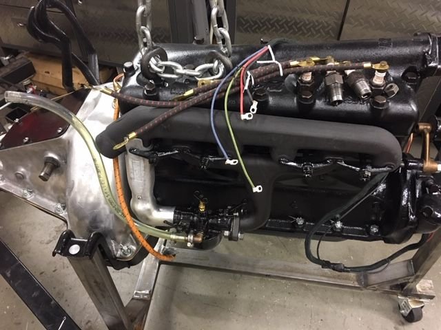

Re: What have you done with your T in August ?

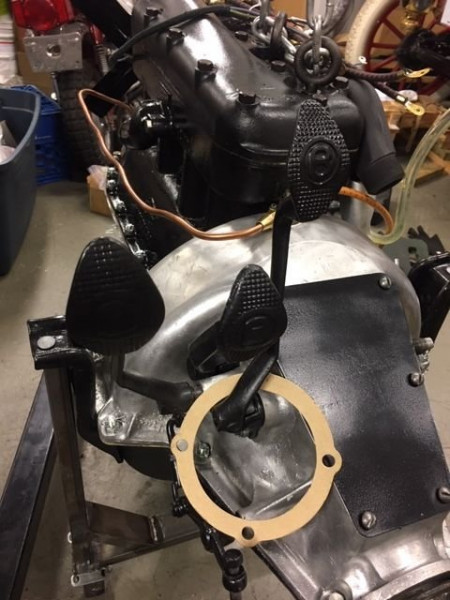

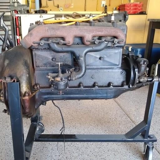

I finally finish my 1913-14 complete engine restoration.
Super Mario Bross
1911 Touring
1914 Speedster
1911 Touring
1914 Speedster
Quickm007
- Posts: 1202
- First Name: Mario
- Last Name: Brossard

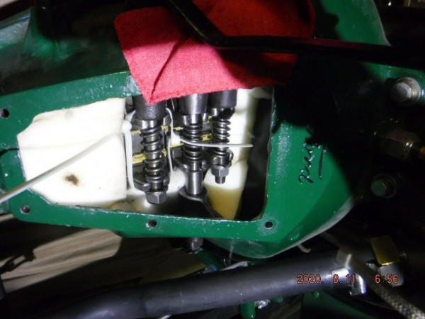

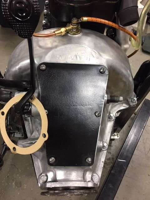

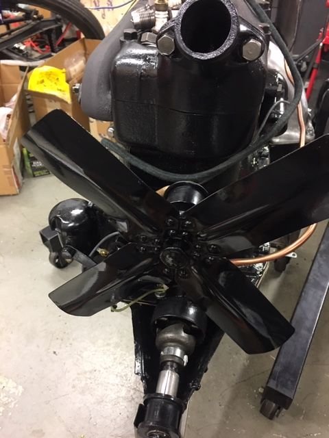

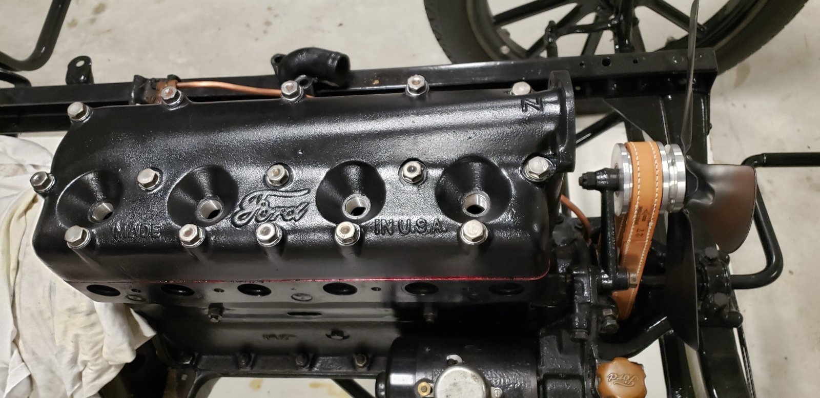

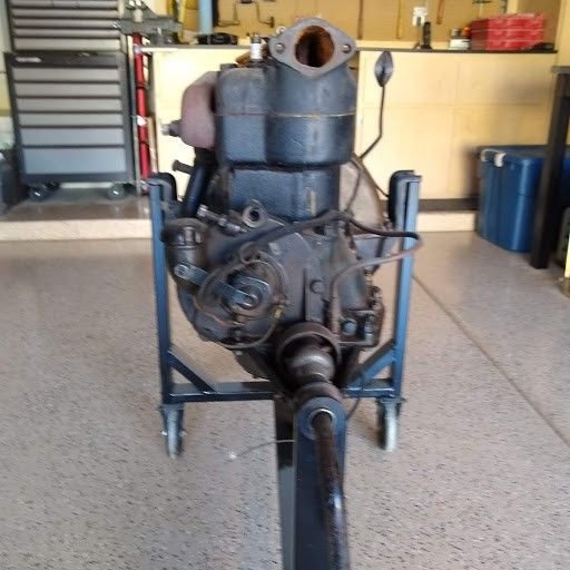

Here bellow picture before restoration
I complete last night the restoration of the 1913-14 engine. I'm pretty happy. I changed the magneto with a new one made by RV Anderson. I recharged all magnets at 4 pounds instead of 2 pounds in the goal to have more power. I used a brand new restored NH and also a new day timer. All new wires were added. I cleaned and polished the aluminium cover transmission. I cleaned the head engine and redone the all holes and used new head bolts. Sandblasted the head and repaint it. I kept the same head gasket, it is in pretty good shape. I change the intake manifold because it had a leak which I wasn't able to resolve. I kept the Exhaust Manifold no matter is not straight, it work and that keep is charm. I sanblasted both Manifolds in the goal to remove the rust and repaint both. I also clean, sandblasted and repaint the engine. Piston and valve look pretty decent so I kept them as is. In the transmission side, I never saw WATT discs before so I asked advices to RV Anderson because my research told me something look unusual the way it was put in. I was right, it missing 2 small steel discs. But no matter that missing the transmission working good but it was slippy. So On early (pre-’16) transmissionss, I proceed as follows: I Installed the thick steel spacer disc first, then one Watts Style disk, then 2 original “small” steel disks. Repeat with another Watts Style disk, then 2 more “small” steel disks, and so until I have installed all 8 “small” steel disks and all 5 Watts Style disks. The thin Watts Style disk must be the last disk in place. When we install each disk, it need to apply a good film of oil to all surfaces. Do not flood the clutch with oil but a good, medium film is necessary. So I learnt something new again about T, Thank's RV, I like it. I kept the transmission band they are in pretty good shape. I changed the transmission clutch spring and all band springs too.
I'm gonna try the engine this week-end and keep you posted. As you see, the engine it will be good for another 100 years. I will keep you posted for all progress.

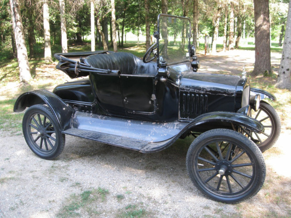

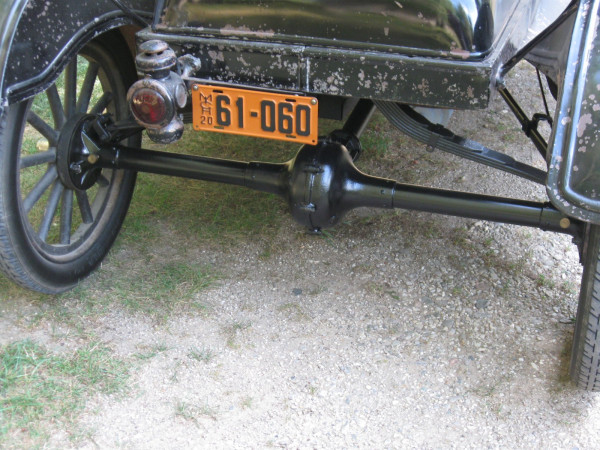

I finally took the car out for a long drive after a freshly rebuilt rear axle, rebuilt/refurbished rear spring, new front spring and shackles and a new (to me) original muffler (compliments of Joe Bell, thank you sir!). There was a big problem with the new front spring right out of the box when I got it, I will post about that later/separately. Everything went so well there was one thing I did not think of, I ran out of gas. About 110 miles in all and only about 3 miles from home when the cough started. Except for that one issue it was a great drive.

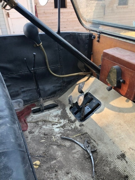

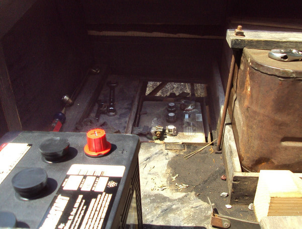

Pep, i just about had my Lizzie trained to run without gas, then the same thing happened to me !
She takes a twice-daily run around the hayfield to make sure the irrigation is running. Sprinkling up new seeding is a muddy job. She's about due for a mid-season cleaning.
The other day she was a little balky to start. I have a 12v ATV sealed battery for ignition only, it's about three years old. I put the charger on it, hot spark sure makes a difference!
"Get a horse !"
Topic author - Posts: 6895
Rich, I enjoy seeing some earth on the floor mat.
Nice to see the old hand.
Pep, that Runabout has a lot of class!
Pep....I like that old original muffler.
I need one for my car. I have a repro that's connected to a repro exhaust pipe and I also have a very old, very solid generic pipe and muffler set (that I'm running now) that was on a parts chassis I bought.
The old generic set has a crusty look that matches my car, but I don't like the way it sounds. I like the sound of the repro set better, but it looks....well...repro.
So, like I said, I need to find an old original muffler.
1924 Touring
- Posts: 7127
Best of luck Don. The correct muffler for your car has pressed steel ends, and they, along with the steel shells, do not last long The cast iron ends are earlier. When You team them with stainless steel shells, they really do last, but then they don't look 'right'. I compromised on Henrietta and used second hand cast ends and ordinary steel shells. They have rusted nicely, But the bronze repair to the back cast shell has not.

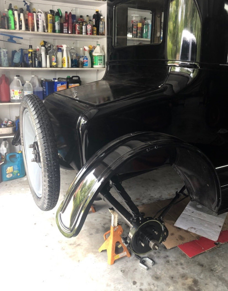

Tire mounting Thursday
New Wards Riverside going on set of Disteel disc for the ‘25 Coupe.
Flaps and Custom Classic $15 tubes, they weight 2 1/2 lbs. compared to the 2 lbs. of the Hartford $30 tubes, and those Hartford have tapered rubber stem that is .690” and too thick to seat in the rim hole. Stem stands too tall and won’t seat. Can’t ream hole larger as it compromises the rivet heads .
The Custom Classic rubber valve stem fits fully snug into rim hole as a tube should to prevent stem tear!

Nice ! Dan, I hope you'll post some pix of your coupe when you get them mounted. Discs are seldom enough seen, I don't think I have ever seen them on a coupe.
Thanks Rich.
Started with the spare tire first!

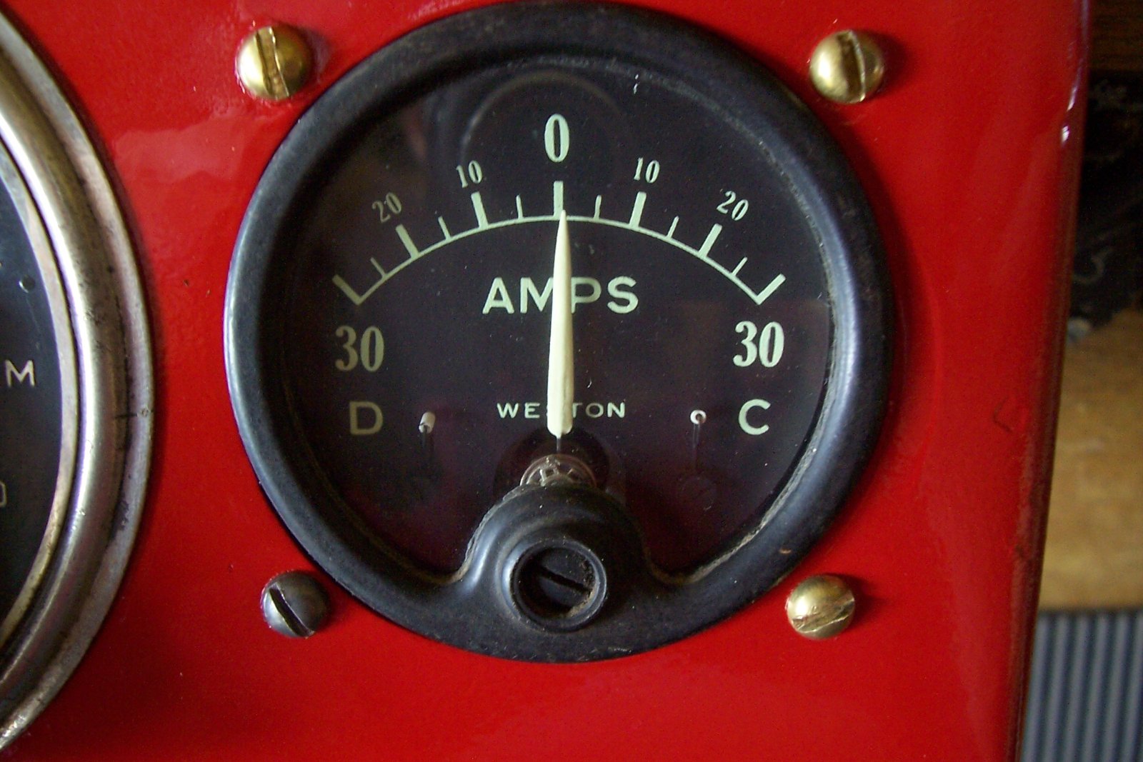

I replaced the repro ammeter on my speedster with this vintage Weston aircraft meter. These aircraft meters are very high quality and easy to read.

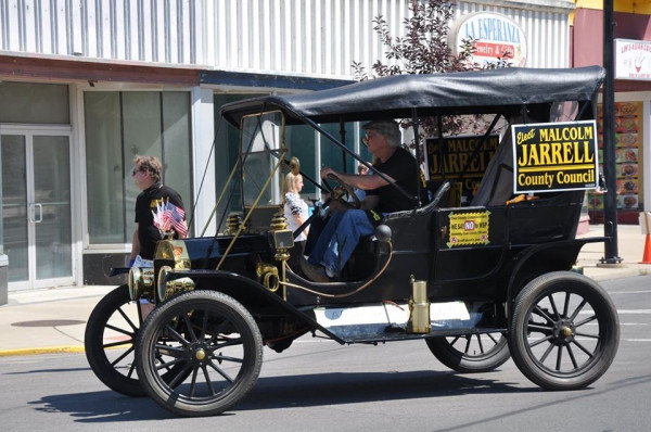

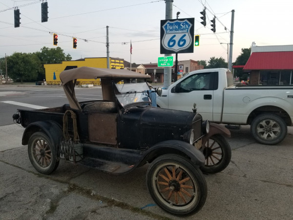

Did two events in one day, parade at noon and then a car show at 4 PM. First time this year to do any event and only 3rd time out in the car.

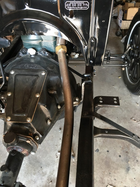

I installed the exhaust pipe and muffler on my 1926 TT chassis. The exhaust pipe is one of Larry Smith's fine reproductions and the muffler ends are originals. The two outer shell pieces are from a reproduction muffler while the inner shell is part of the exhaust pipe. The fit was great, making for an easy assembly and installation.

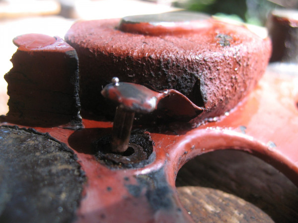

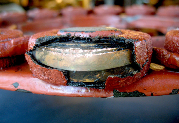

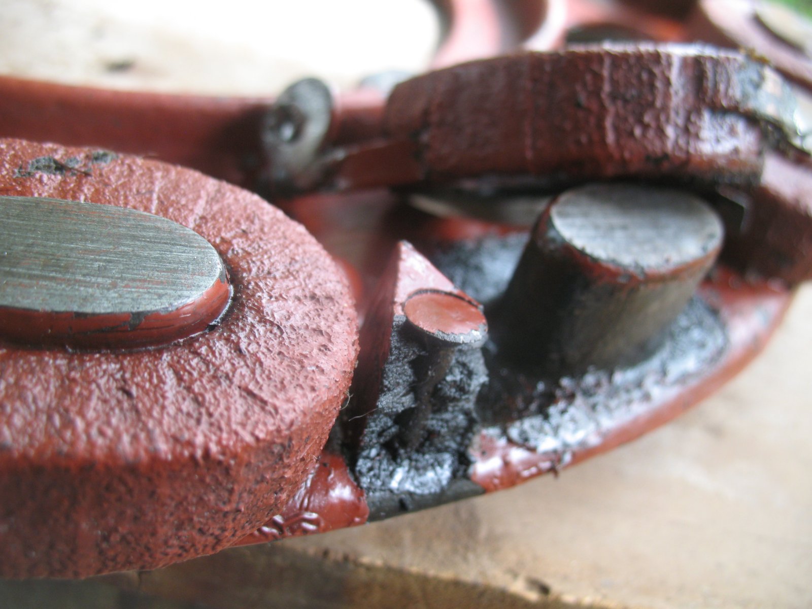

It's been quite a while since I posted anything here, but I've been doing some work, rebuilding the mag coil ring from my 1915 runabout. I think it was done previously about fifty or sixty years ago. It may have been OK with just a patch up job, but the insulation is pretty brittle so I'm redoing it.
It was insulation off the bottom coil that prompted this project.
Looks like it might be friction tape.
It will need a new contact button.
The old insulation is brittle, but that doesn't make it easy to remove.
I thought the last coil would be soldered to the ring, but it's attached with a brass rivet.

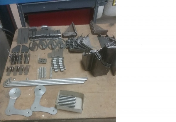

Been working on the bits and pieces for the screen sides. About ready to start assembly.
