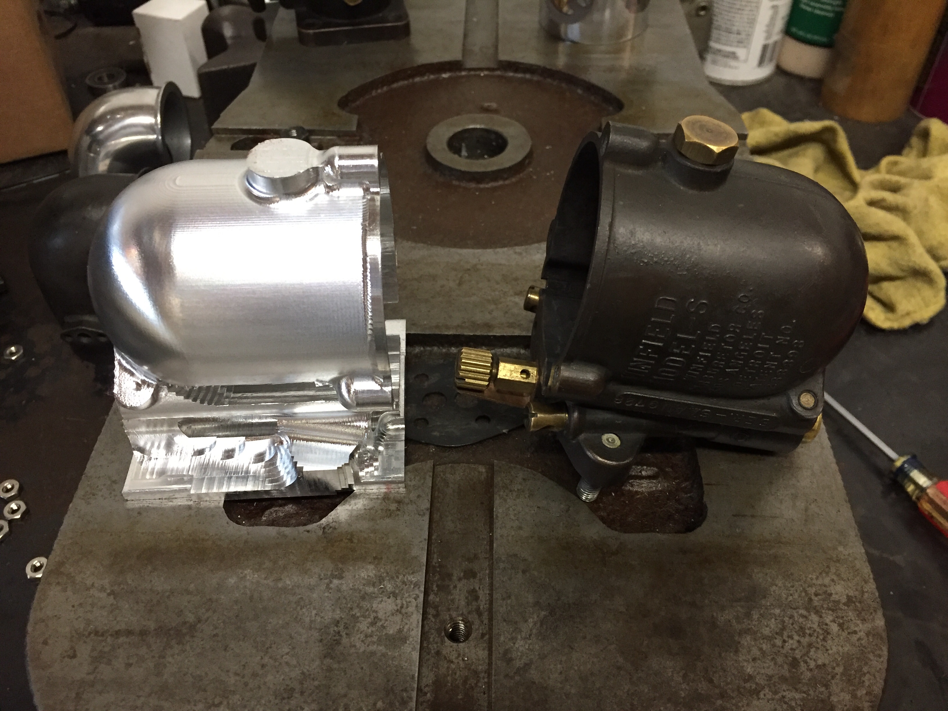

Post by Kevin Pharis » Sun Aug 09, 2020 7:13 pm

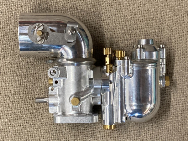

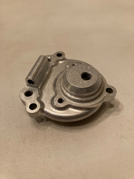

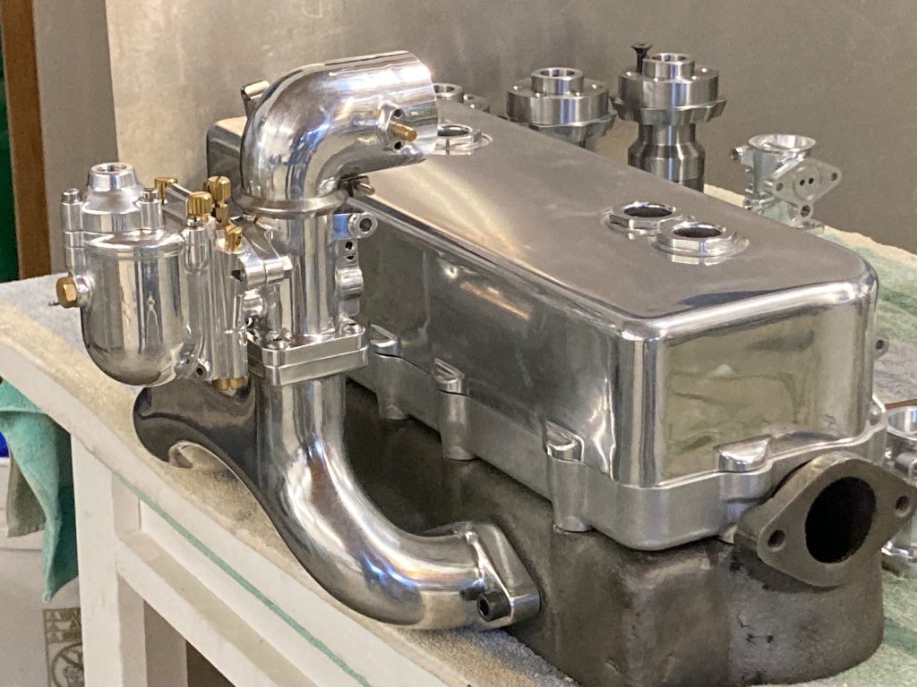

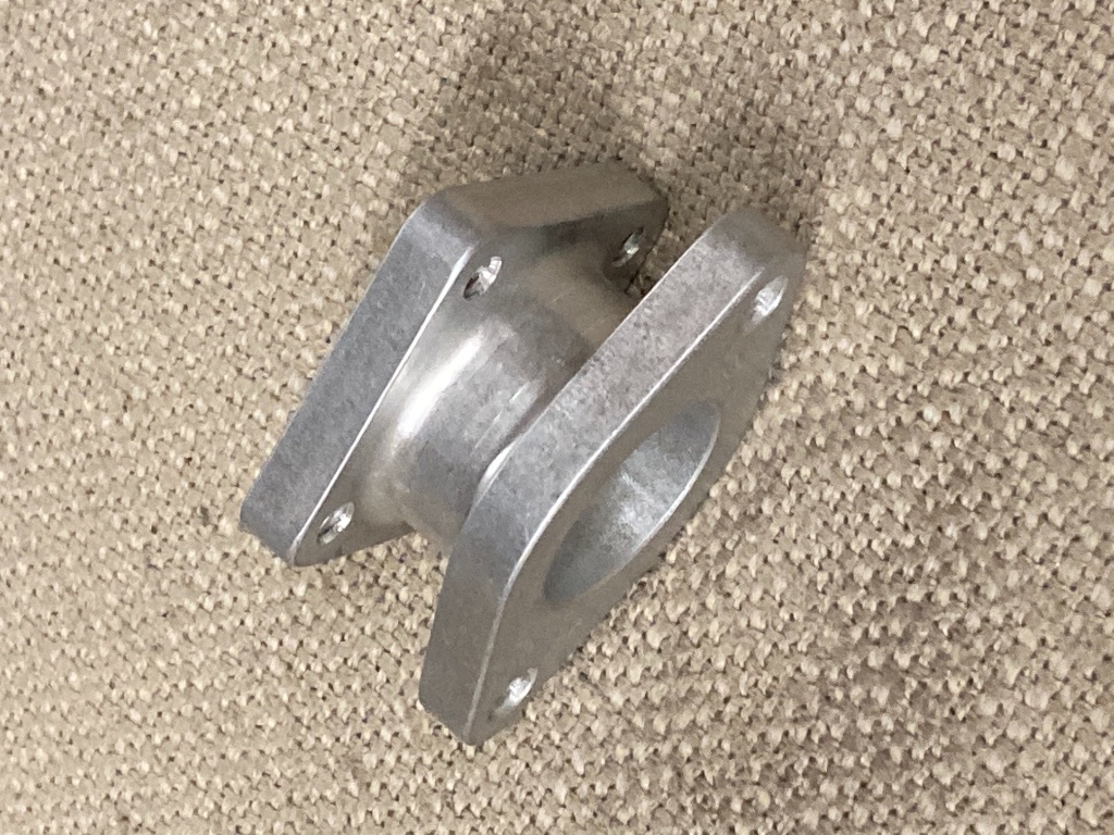

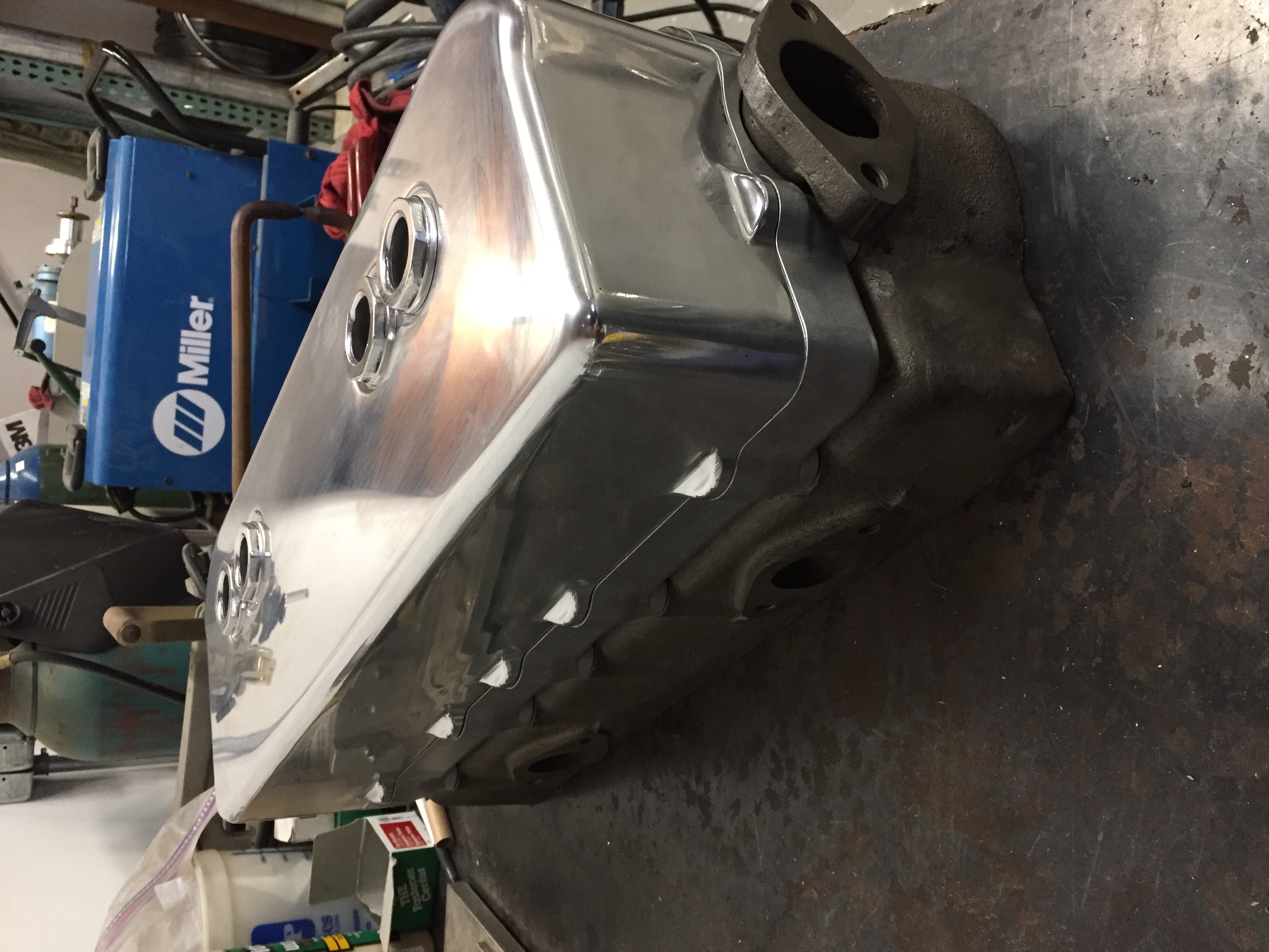

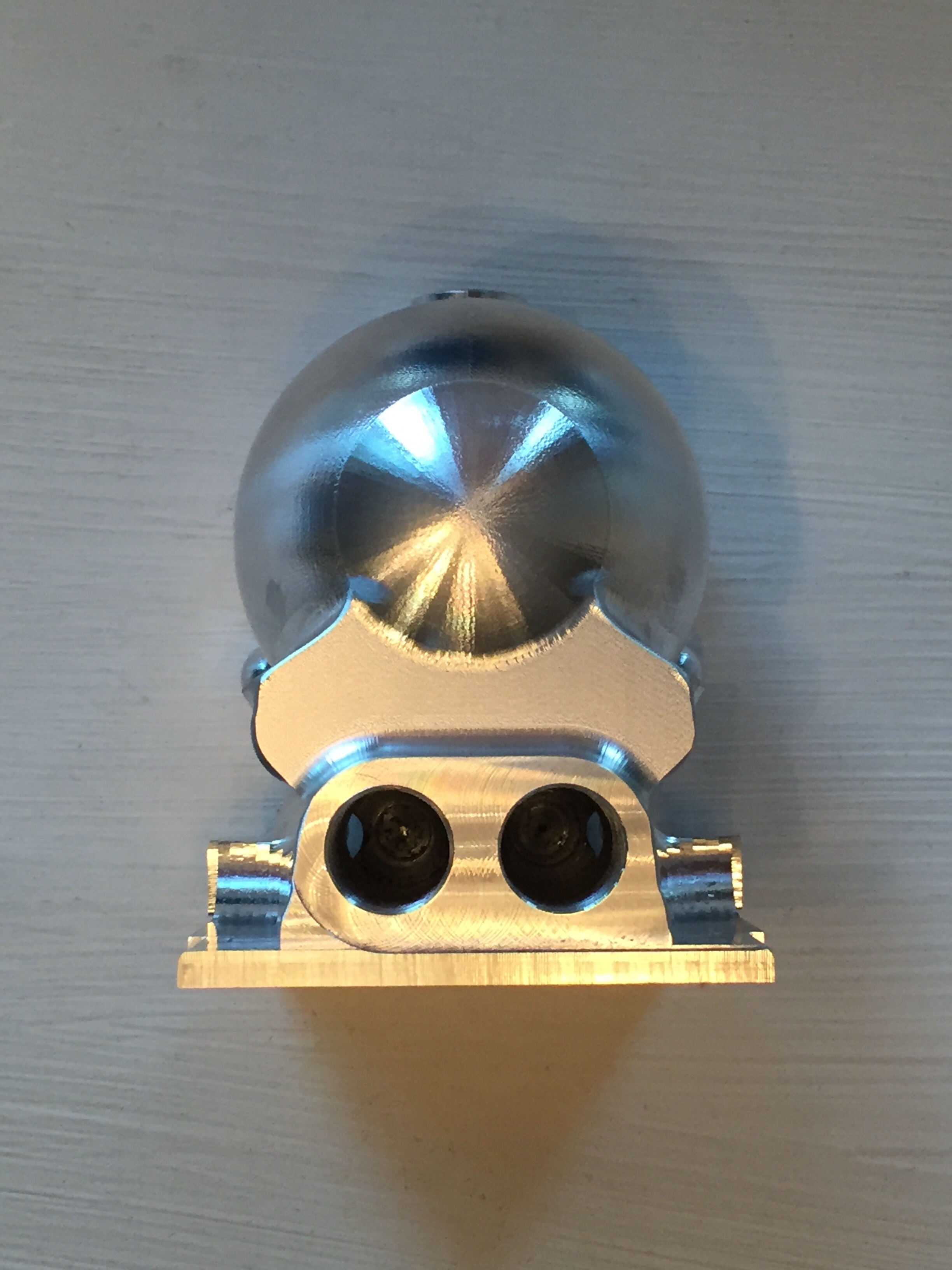

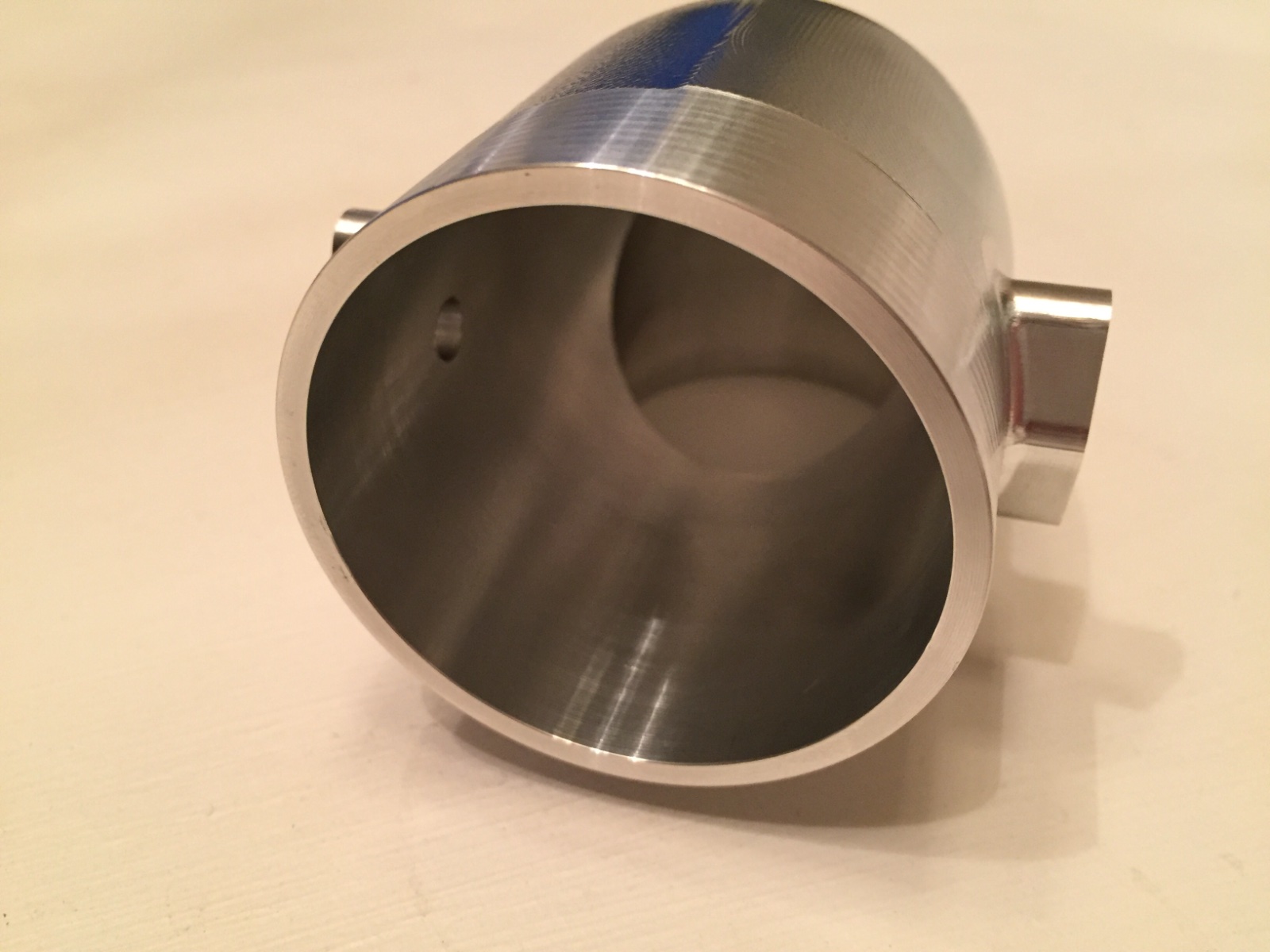

Amongst all the other projects... not sure why I felt the urge to make this...
I had a couple bad numbers along the way, so this one isn’t perfect or finished... but will correct on the next one. This one is for a size AA-B, and is just about identical to the original.
One piece at a time I’m getting closer to a complete pair of S-B downdrafts for my Akron conversion

Awesome workmanship!

Nice Kevin, well needed item!

Post by Kevin Pharis » Sun Aug 09, 2020 8:17 pm

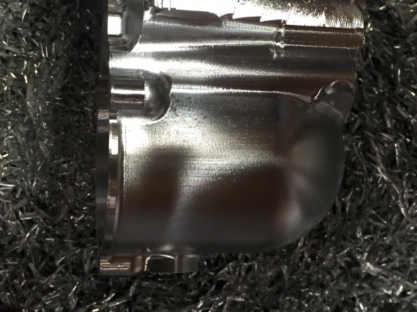

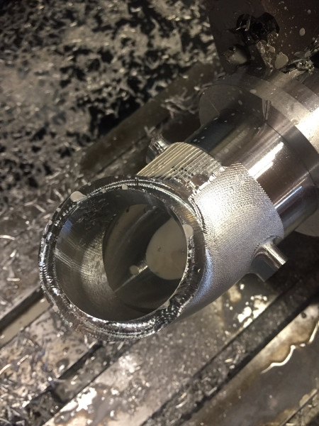

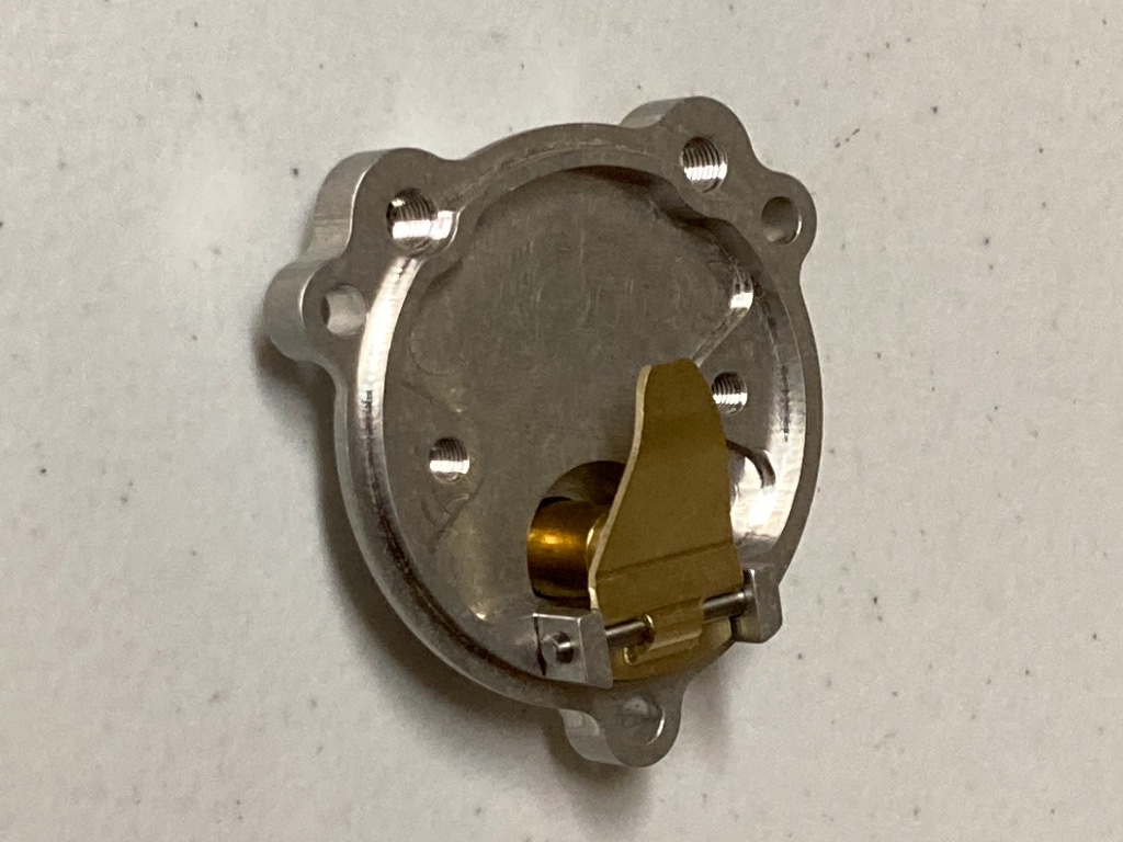

Here is a shot during the machining... started out this morning with a piece of 3-1/2” diameter round aluminum

Ed Winfield would be proud...
As for me.. I'm super impressed. Ed made some of the best performance gear to be had, and I keep thinkng if someone would have kept his dream alive in the 30's and 40's, he would be a name to fear on tracks even in this fuel-injected era...
IF you decide to make these to sell, PLEASE let us know!!!

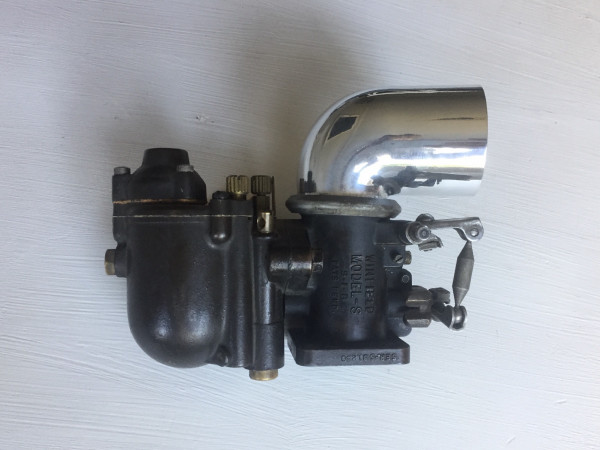

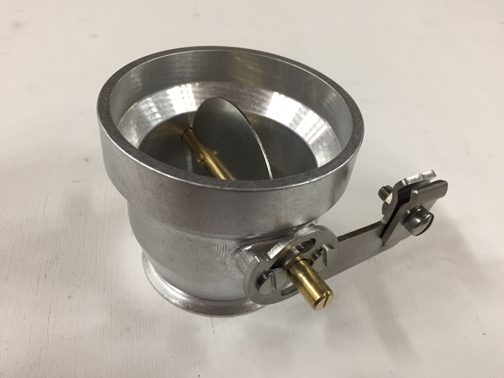

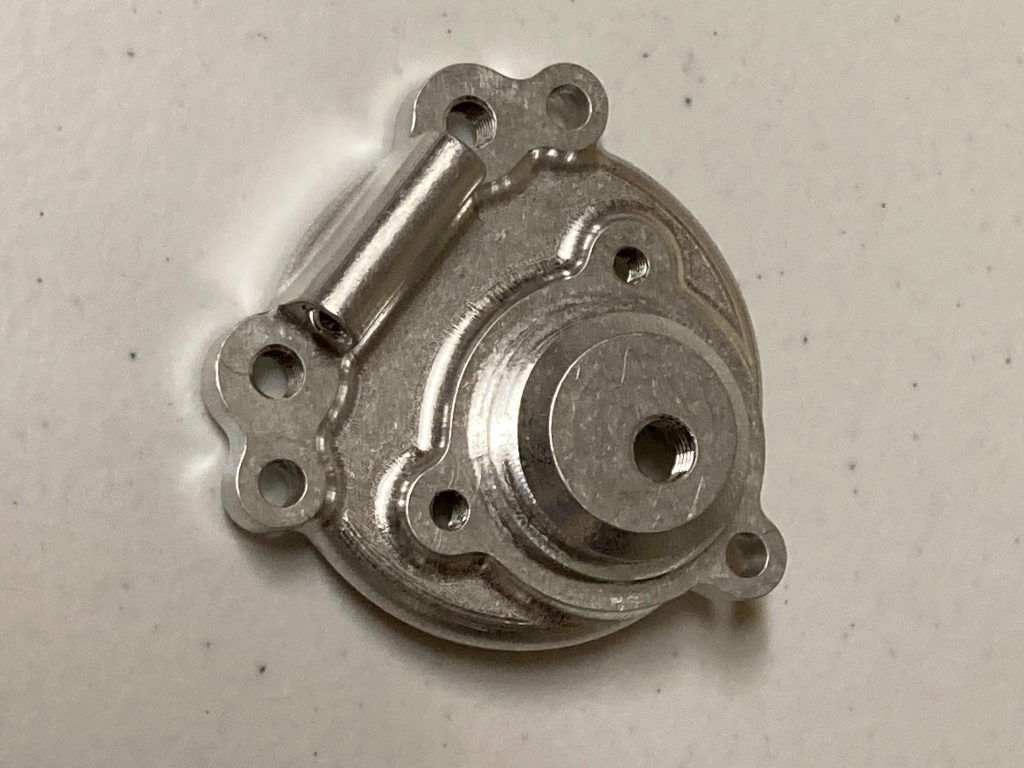

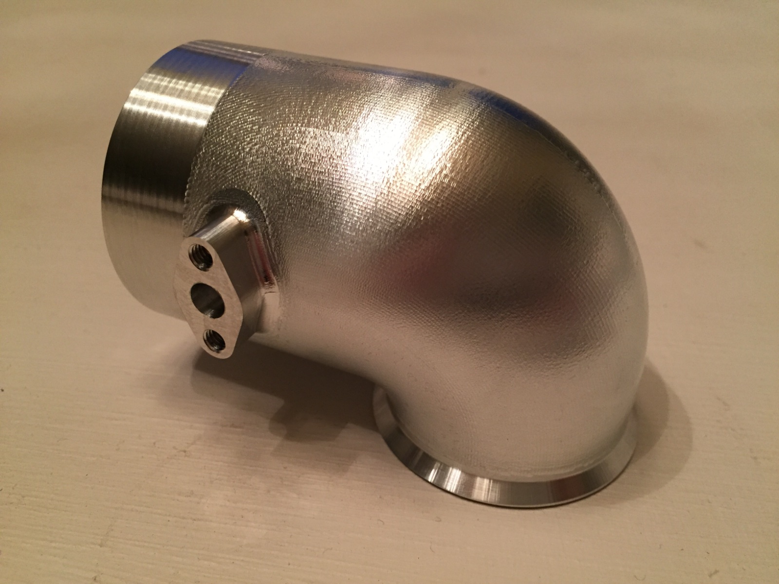

I made some AA-B straight choke housings a couple years ago, along with the butterflies, shafts, and hardware to complete
I considered making these choke elbows back then... but started looking into investment casting as the machine work is not exactly simple. Still not sure exactly what came over me today... but a day well spent!

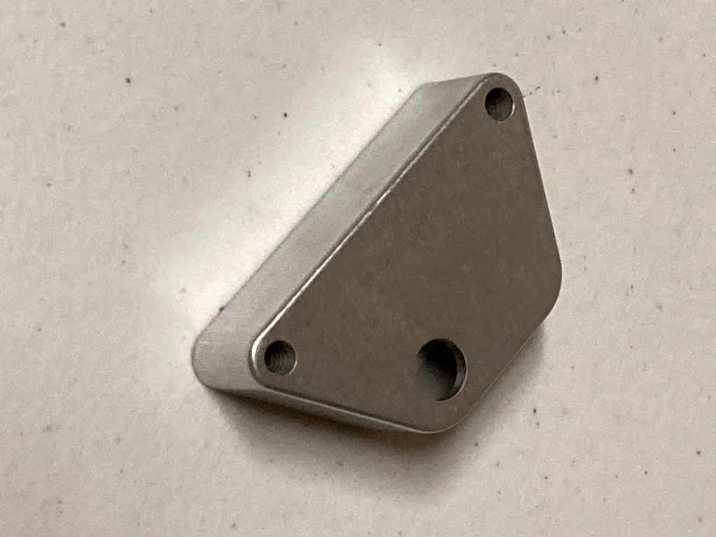

Since the bosses for the choke shaft were cut wrong anyway... I though I would just cut em off and give er a good shinin up...

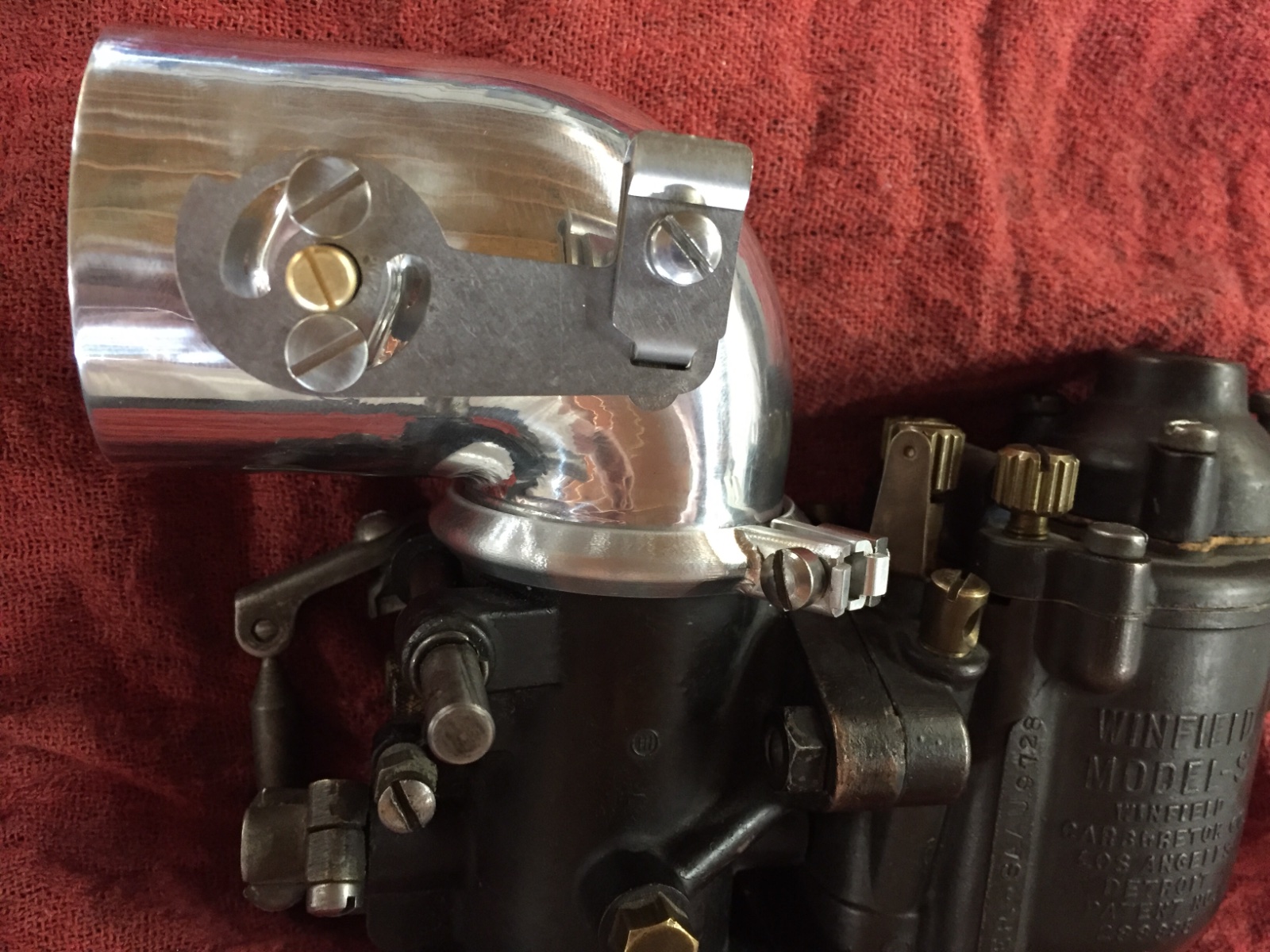

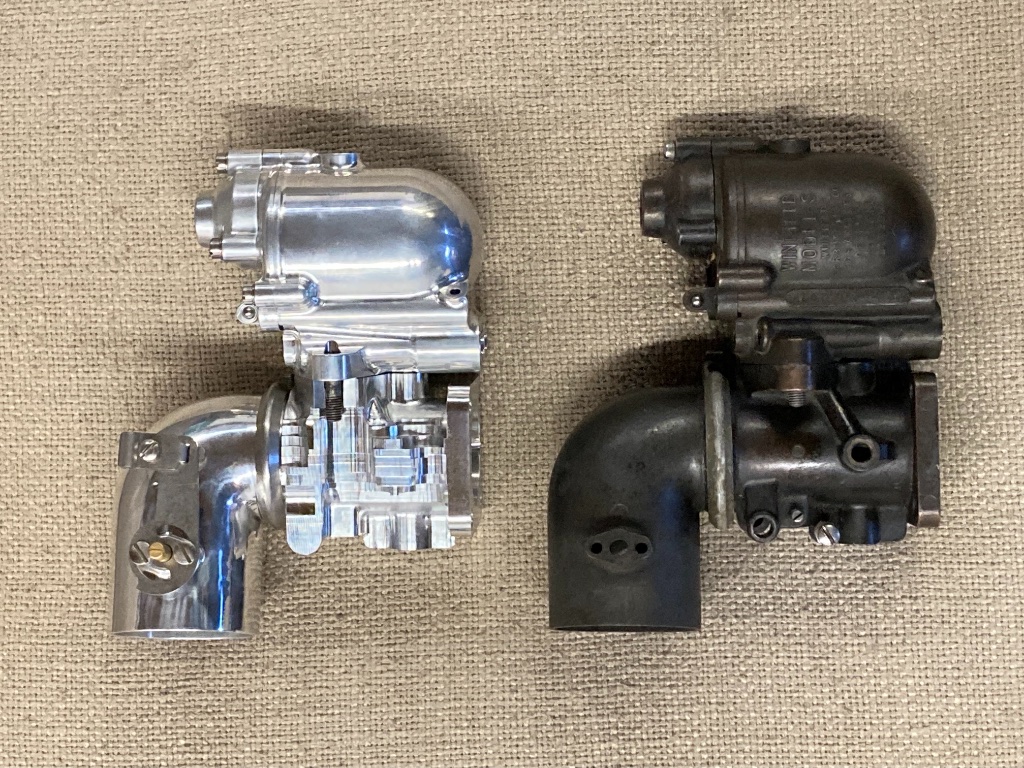

Post by Kevin Pharis » Thu Aug 13, 2020 11:21 pm

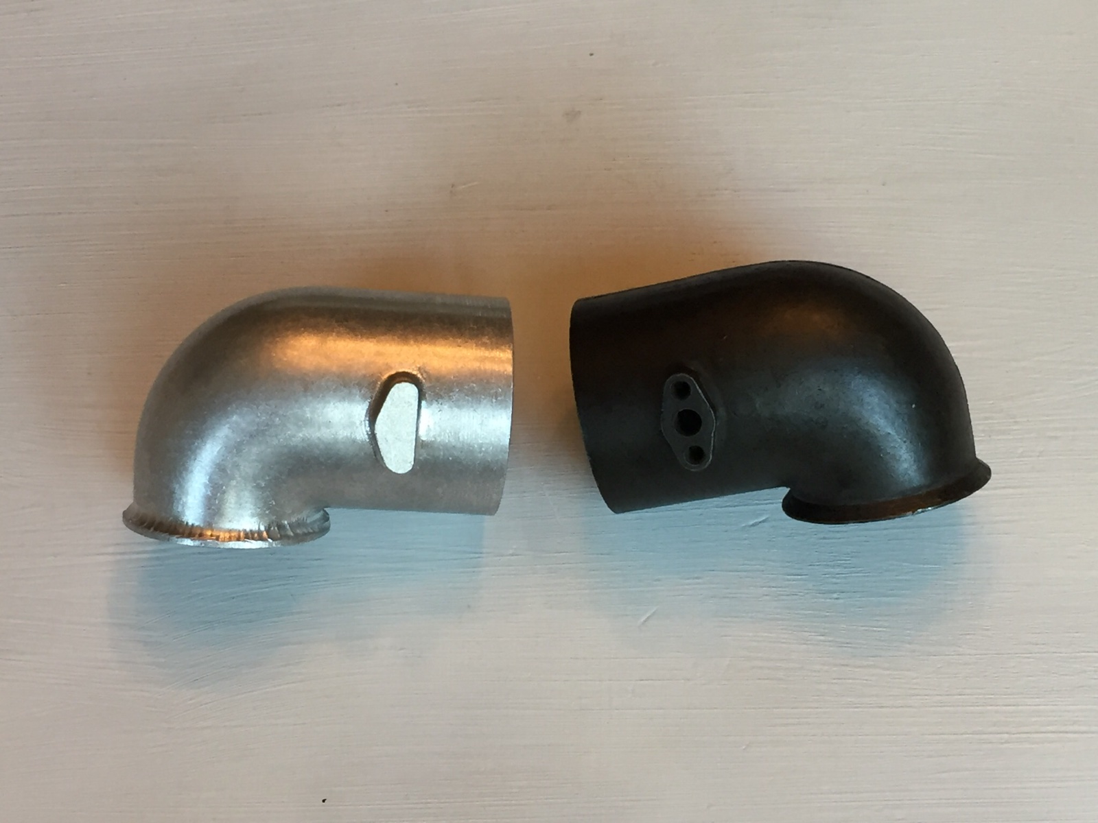

Received the tools to finish the choke elbow today. Hoping to finish the polished one... and also make a couple choke elbows complete with the butterflies this weekend
Looking forward to finishing up this project so I can move on to the V band clamp to attach the choke elbow. Thinking stainless...🤔

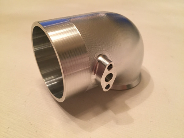

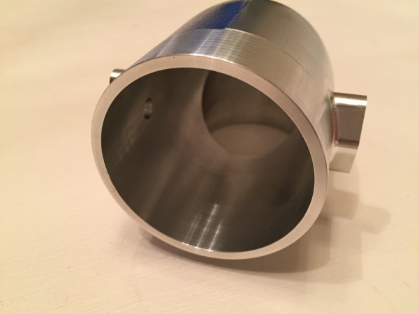

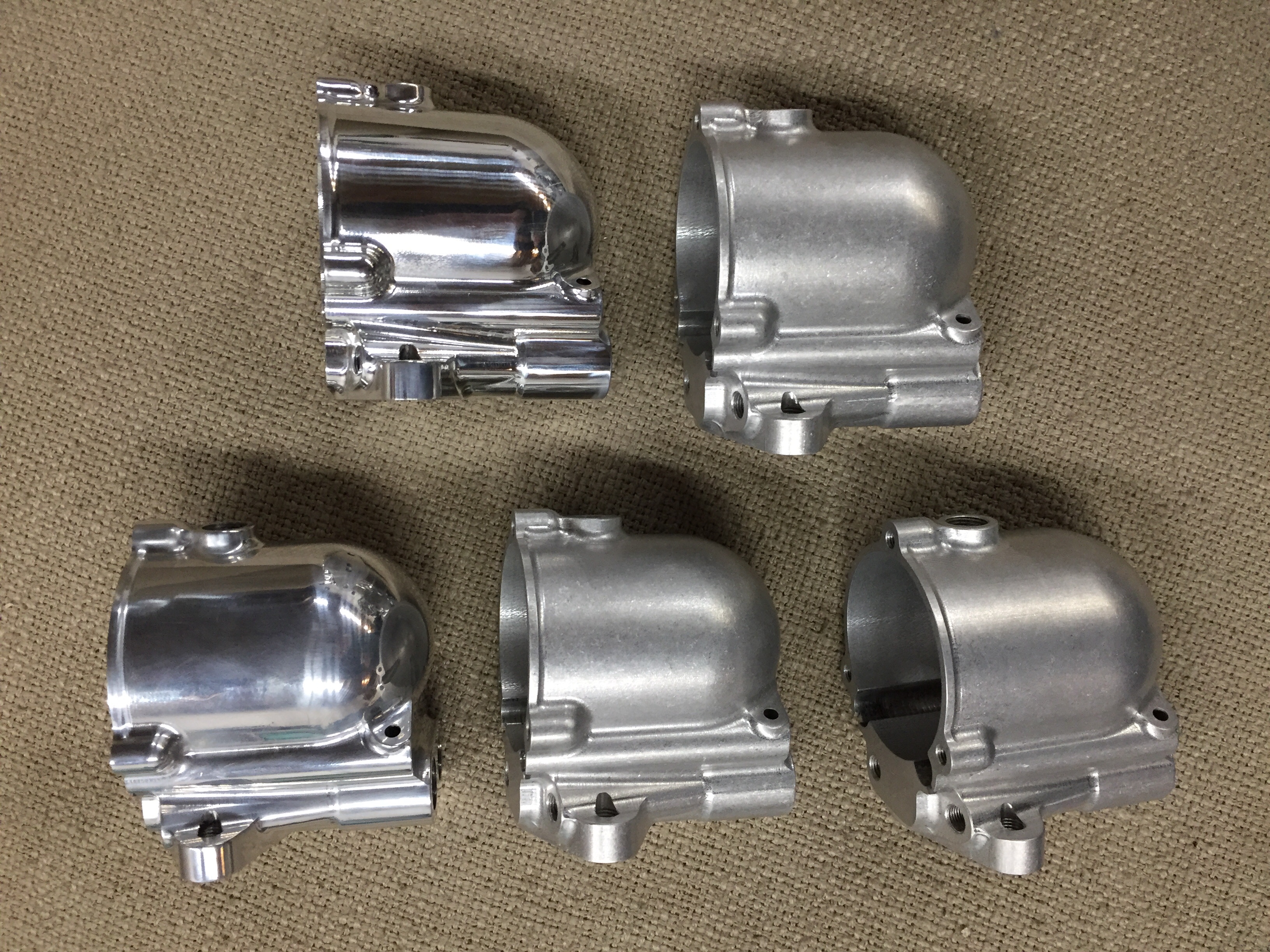

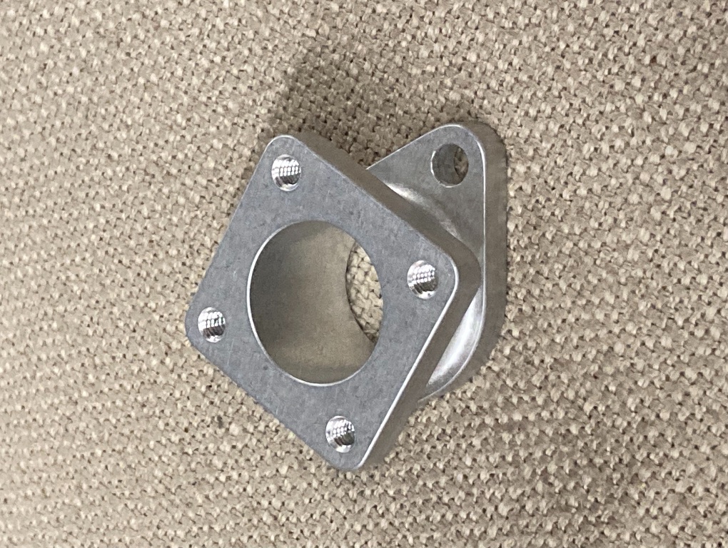

Here’s one fresh off the mill... a bit of blending and it’ll be ready to run!

Post by Henry K. Lee » Sat Aug 15, 2020 6:38 am
Well..., as the ole sayin states, try try again! Looks Great Kevin!
As I found out years ago, sometimes the wallet goes empty but the scrap metal pile grows.

Post by Kevin Pharis » Sat Aug 15, 2020 3:09 pm

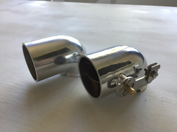

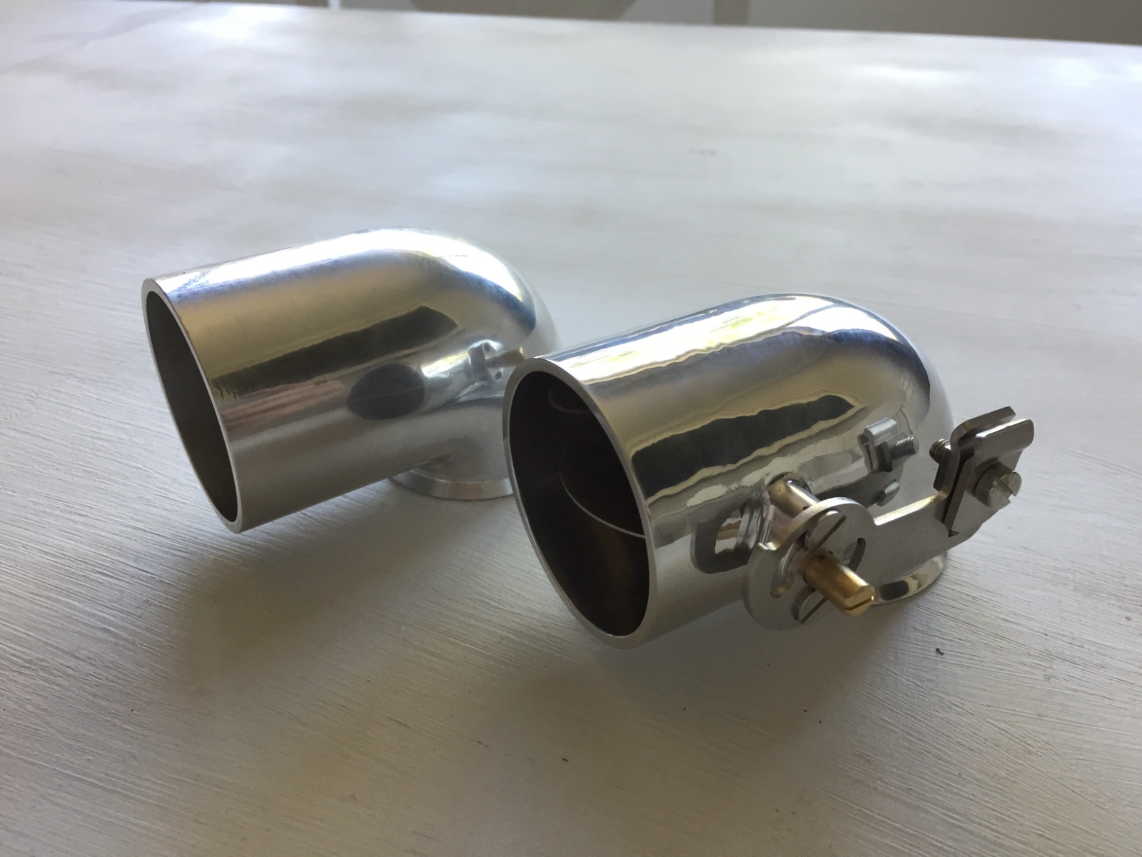

Was goin to make a few more of these this morning... but as soon as I turned on my machine there was a power glitch and I got spooked. Maybe it had somethin to do with the 100 degree heat at 10 am...?🤔. Only supposed to get up to 108 later...🥵
So I decided to do something that didn’t require any electrically sensitive equipment today

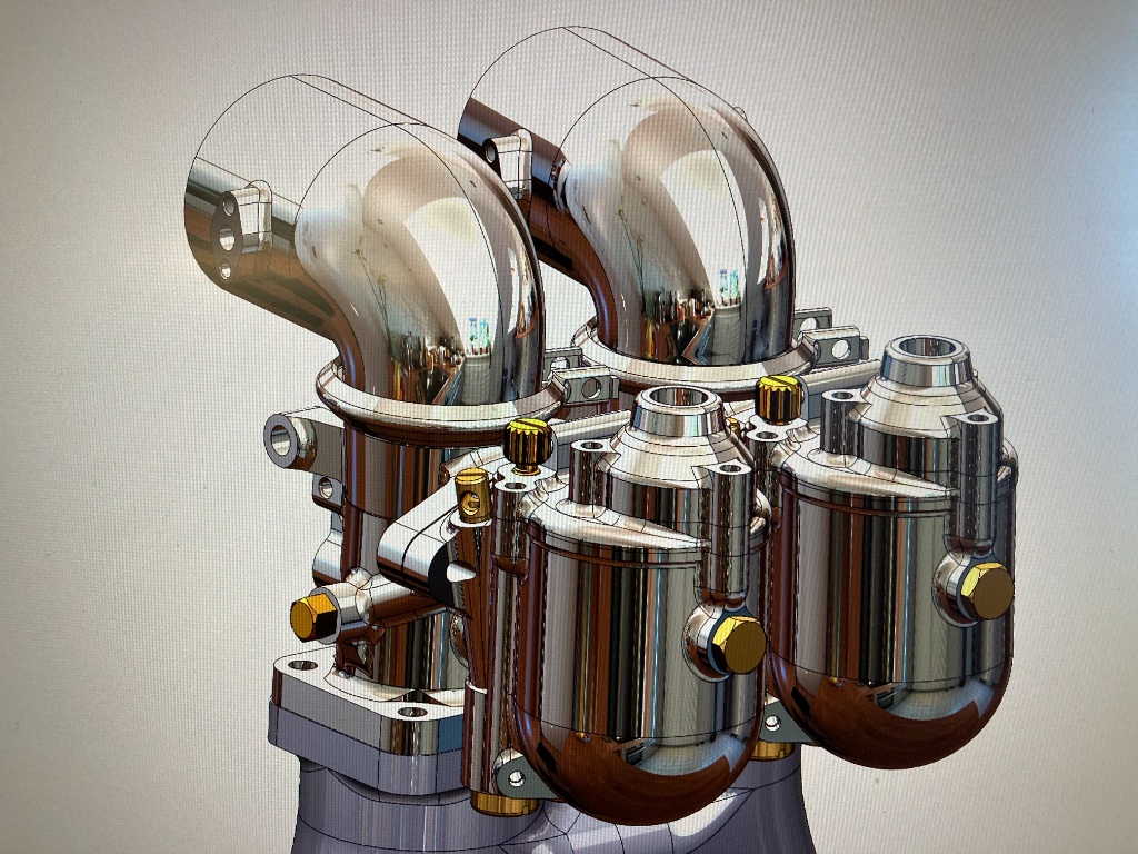

Now I have a matching pair of choke horns for the pair of Winfield S-B downdrafts that will eventually fuel my Akron-Hed motor. Even tho the one horn is technically “wrong”, it’s going to work out perfectly. When a pair of Winfield’s were purchased originally, only one choke elbow was complete with butterfly
When the weather changes back to liveable... I will continue with the V band clamp to hold the choke horn onto the body, and the choke lever.

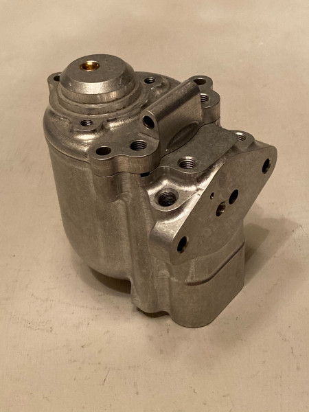

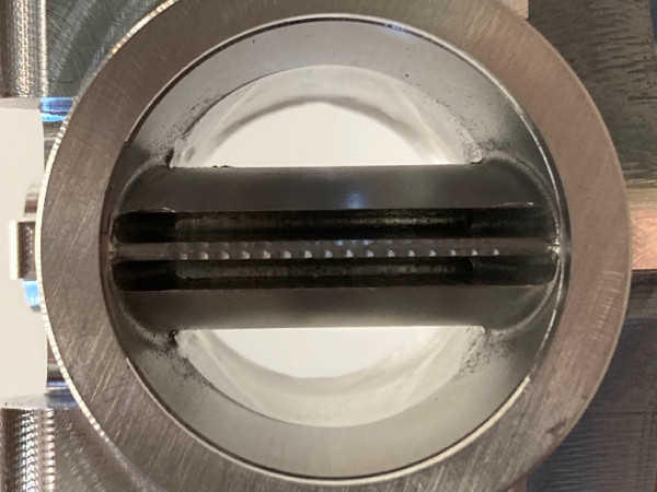

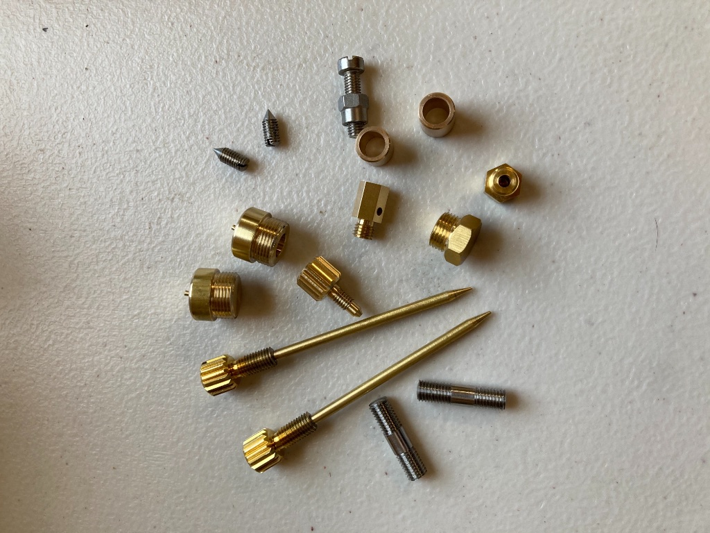

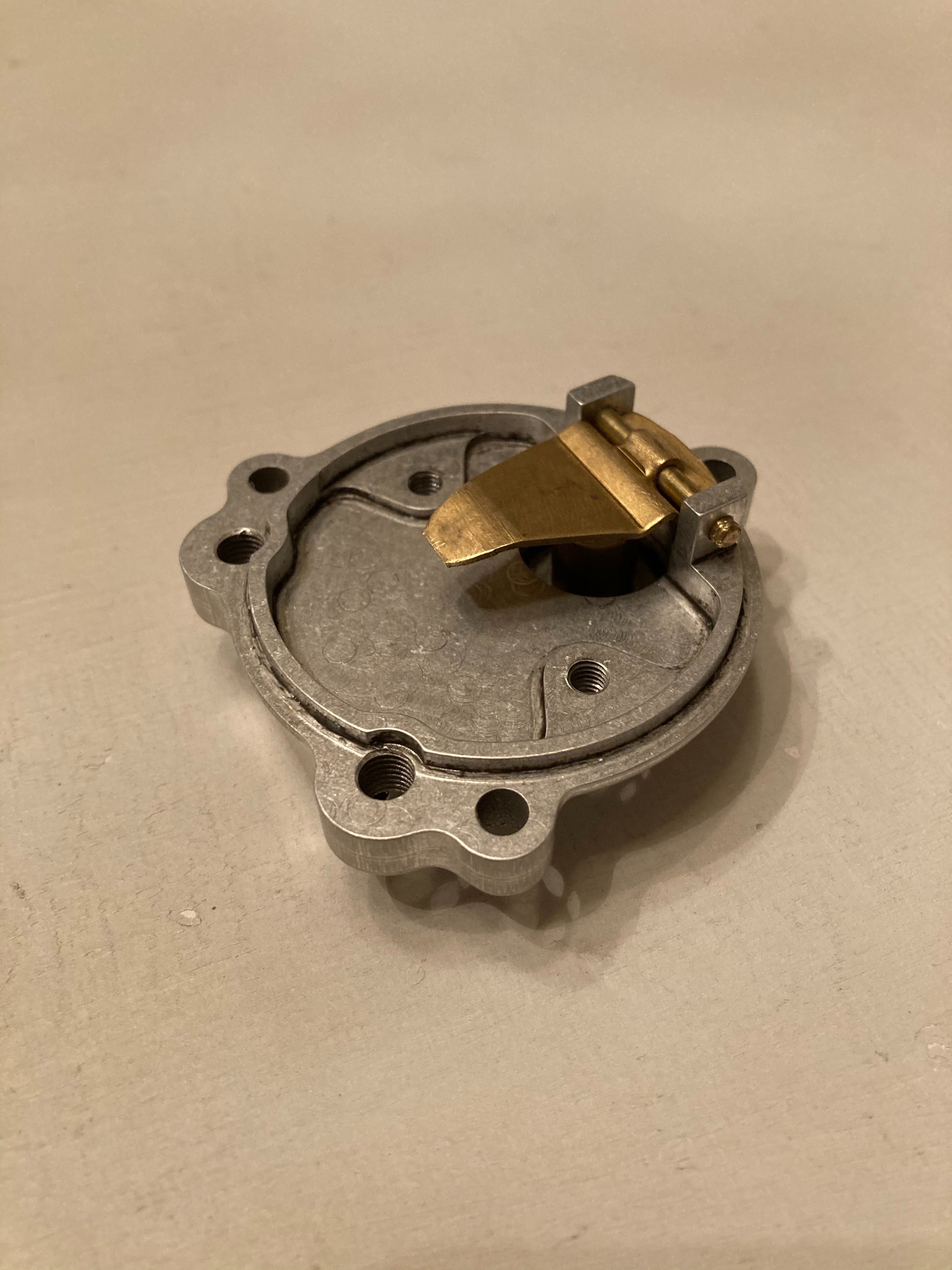

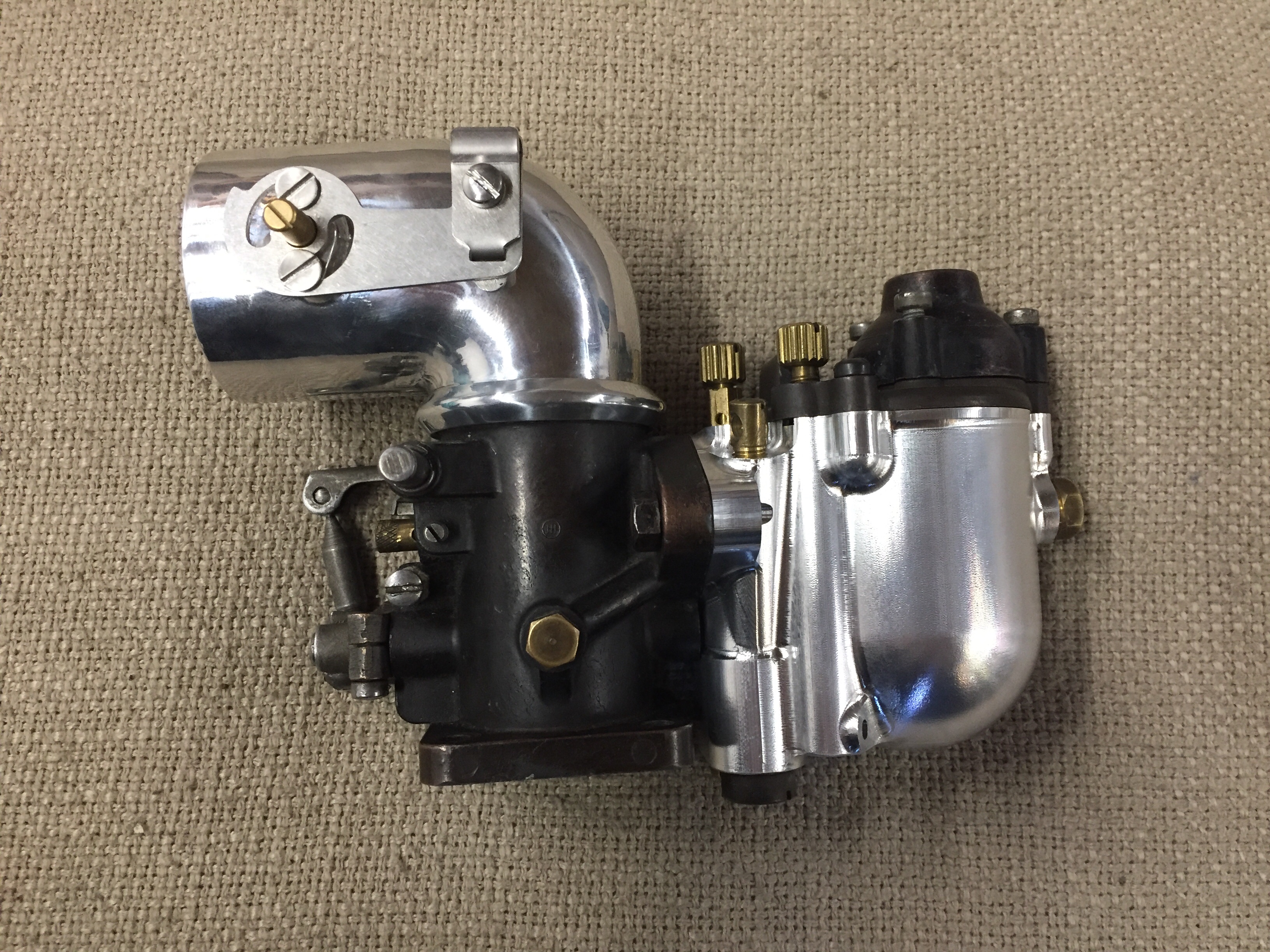

Did some more playin last nite... I haven’t got the right size material yet, so used a piece of stainless that was a bit undersized to prove the program would work, and hopefully do a fit check.
Other than the part being incomplete due to the undersized material... the program ran good, and the part fits good! Looks good too👍.
Now just have to patiently wait for the right material to show up...!

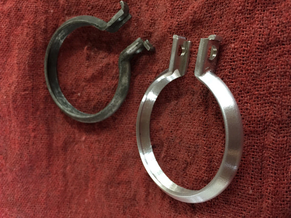

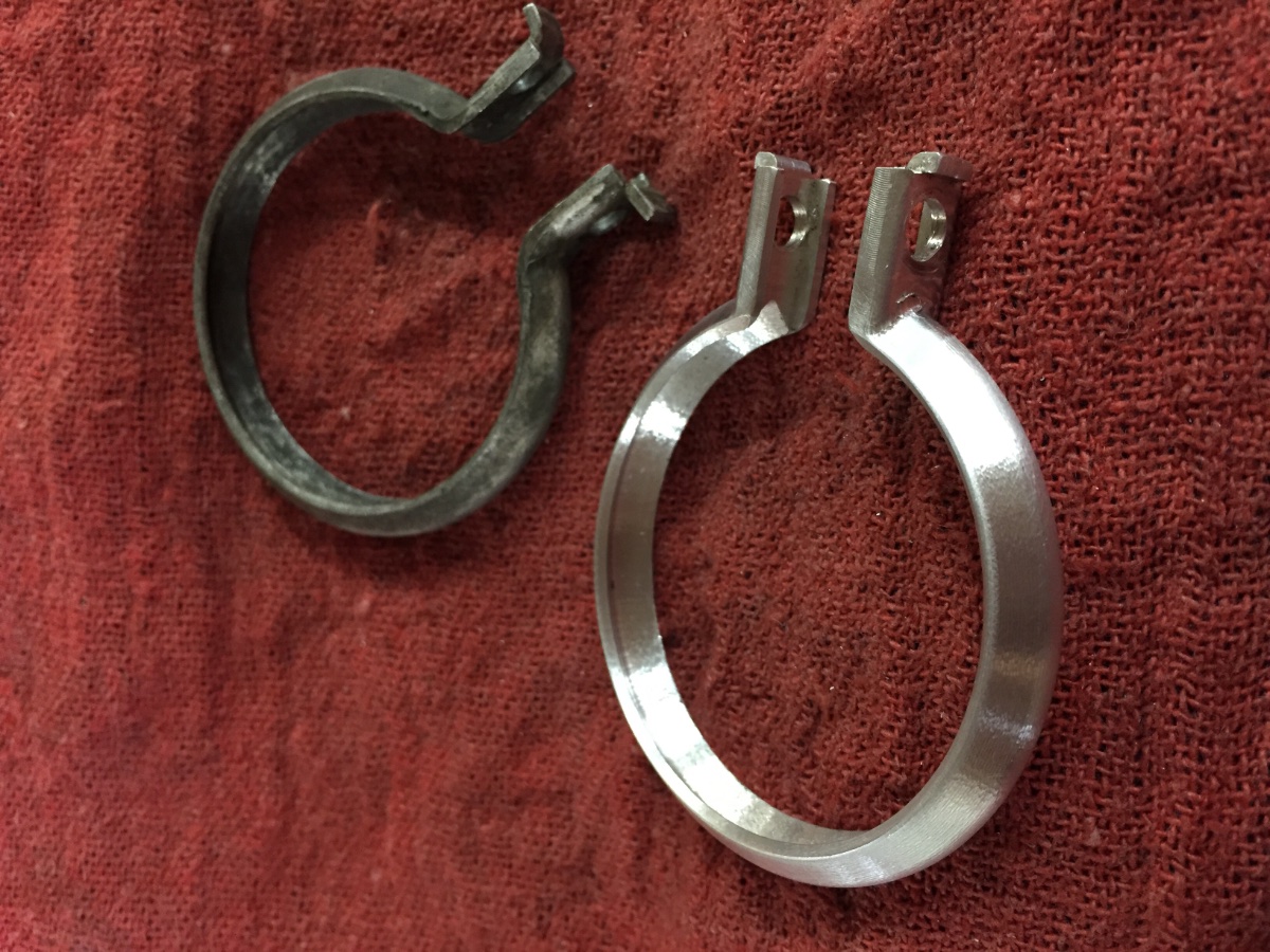

So while impatiently waiting for material... I made an aluminum V clamp to verify fit and completion. All good! Now back to “patiently” waiting...! :roll:

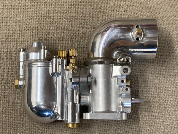

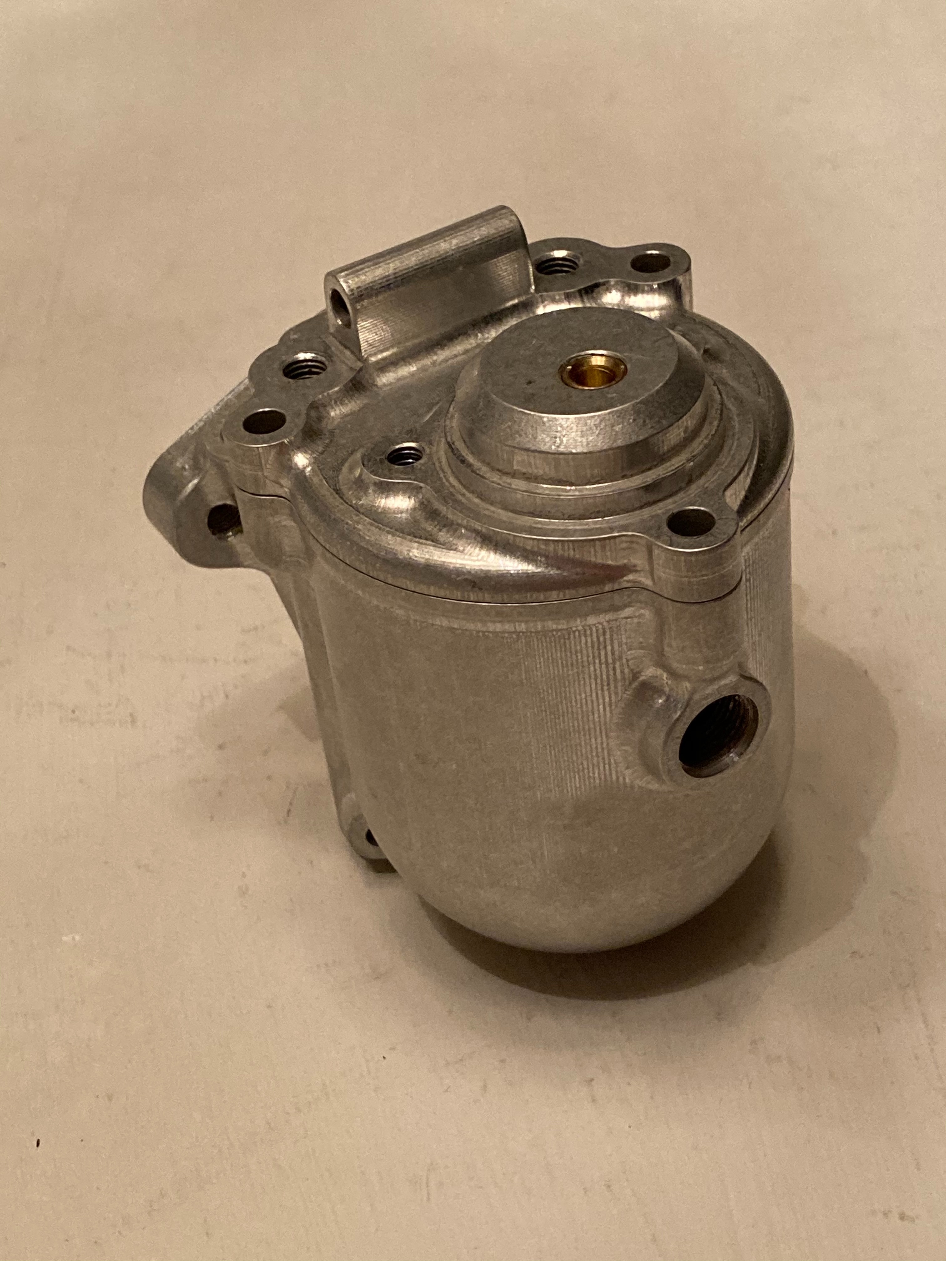

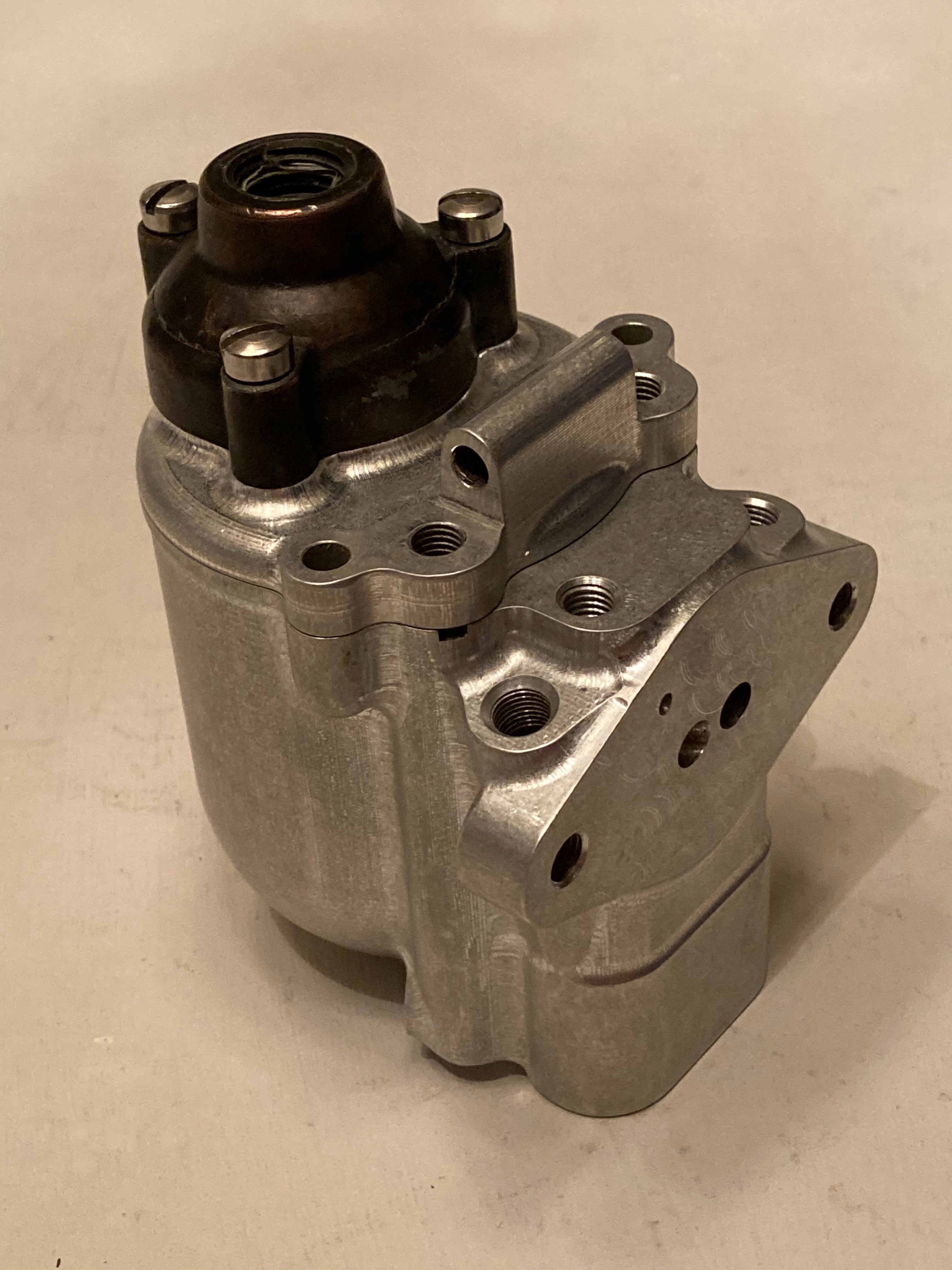

Post by Kevin Pharis » Wed Oct 21, 2020 10:35 pm

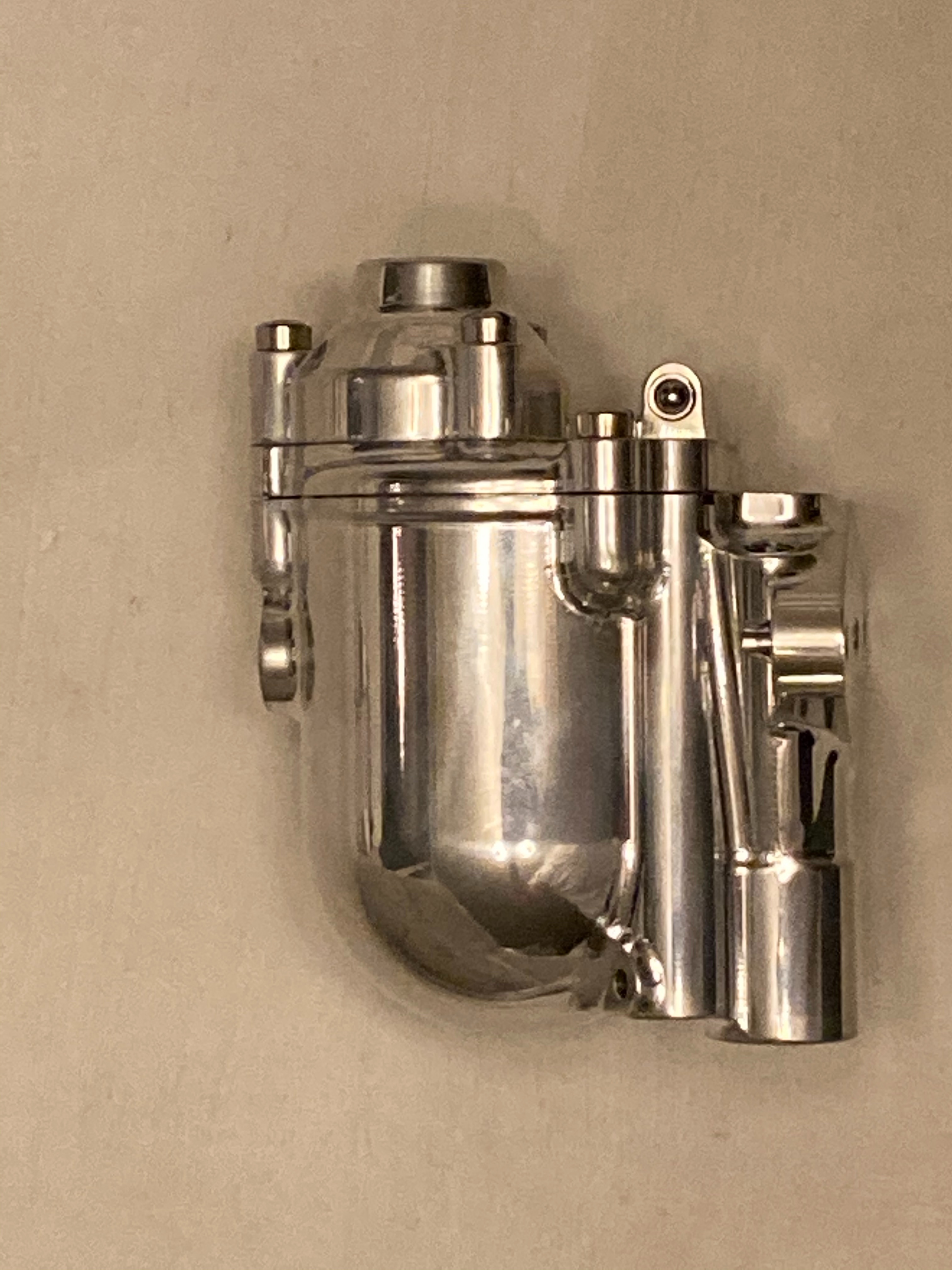

Continuing to play in the shop today...

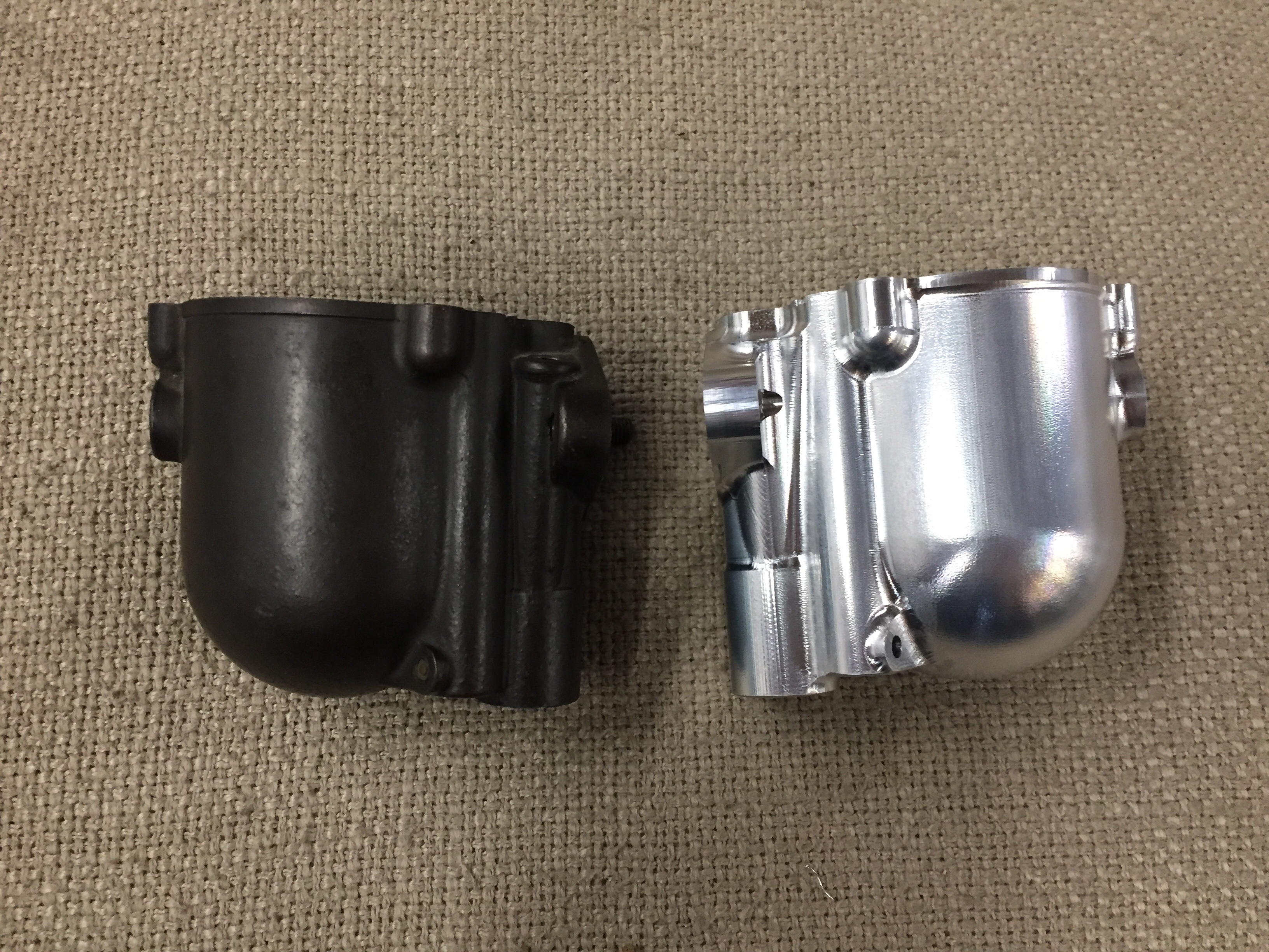

I have never seen one like that. What kind of car does it fit? Is it for a Model T? Were the cars ever fitted with that type from the factory?
I'm sure others on this forum would also like answers to these and possibly other questions. It is beautiful, but just don't know the use?

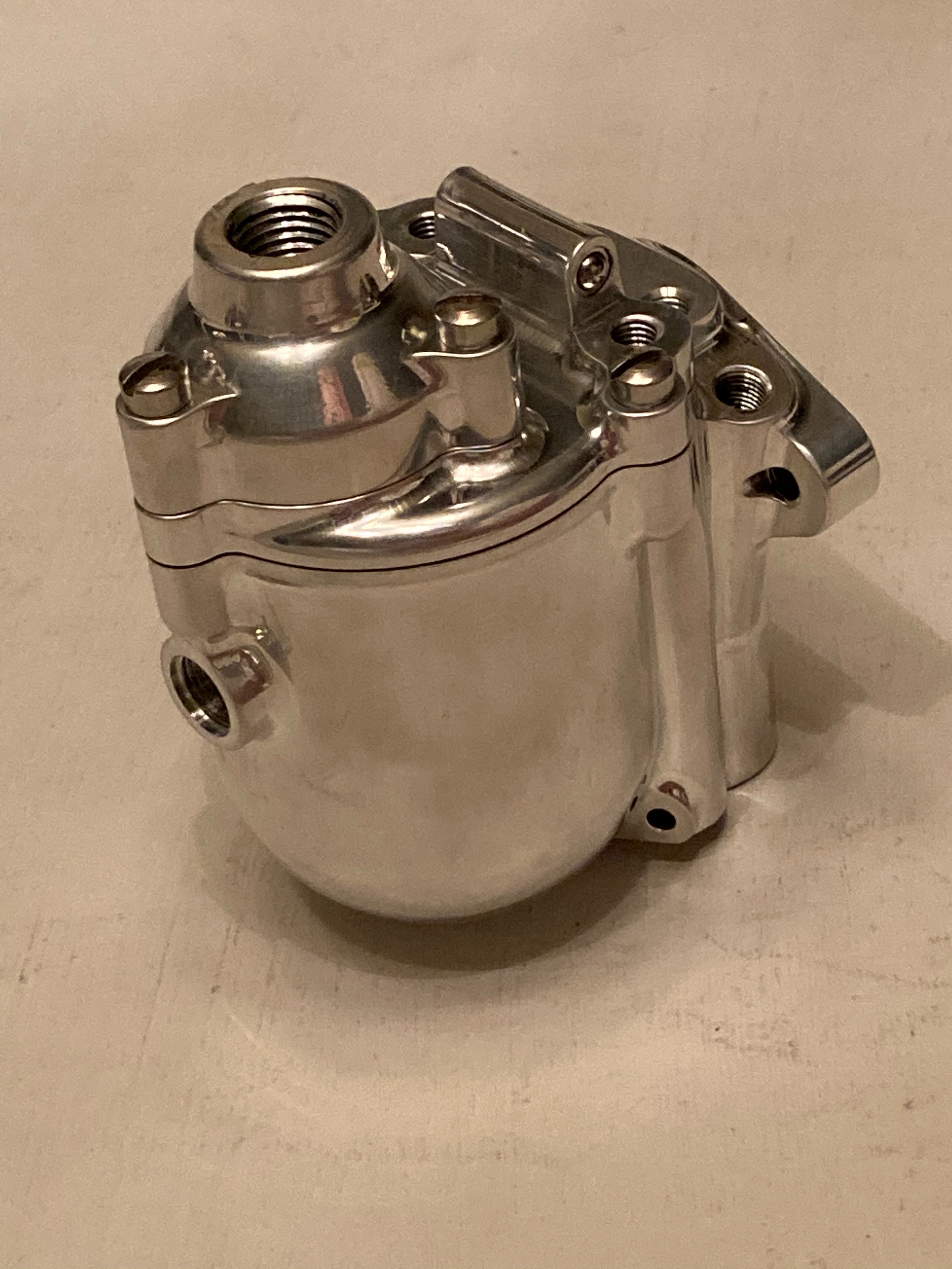

Norman- Kevin is making a float bowl for a model S Winfield carb. The S and SR Winfields were made after the Model M barrel valve carburetors.

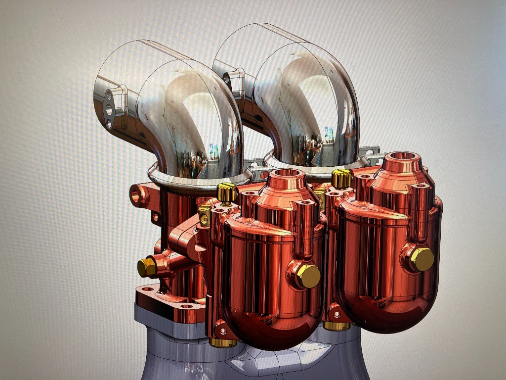

Norman, the Winfield carburetors were an aftermarket accessory, and were not factory equipment on anything as far as I know. They did offer a number of carburetor sizes and manifold/adapter options to cover most production cars, and of course... performance applications.
My hope is to build a pair of carburetors from scratch, to run on the soon to be Akron-Hed equipped motor in my speedster😁

Post by Kevin Pharis » Mon Oct 26, 2020 8:41 pm

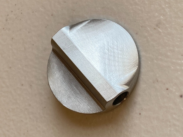

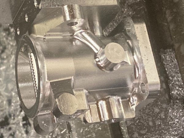

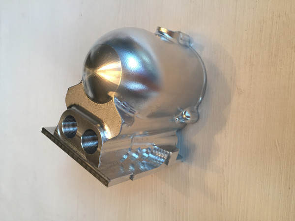

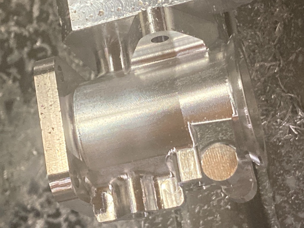

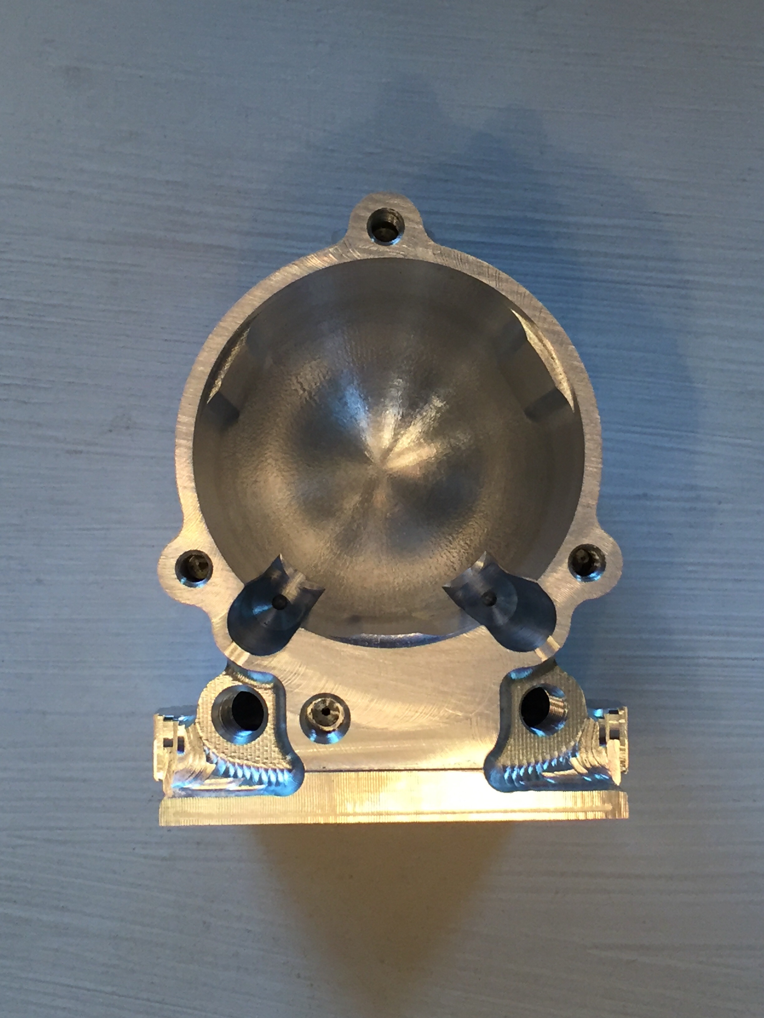

A closer look at the first operation. All the bowl cover screws and jet holes will be drilled and threaded before this operation is done. Next, the bowl ID will be held via an expanding mandrel so that I can cut the mounting flange and drill the last few holes

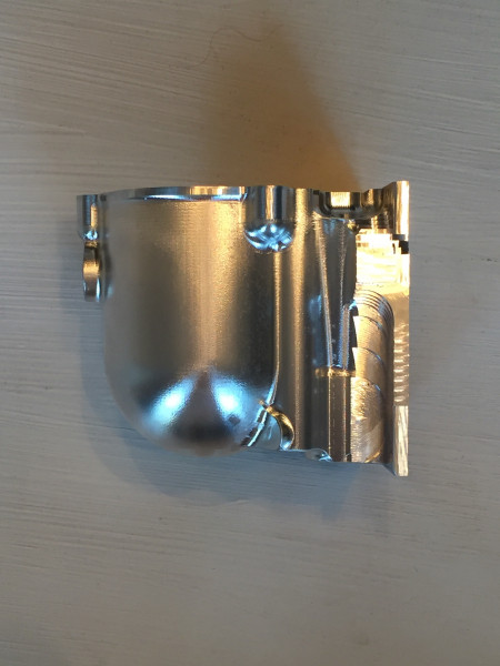

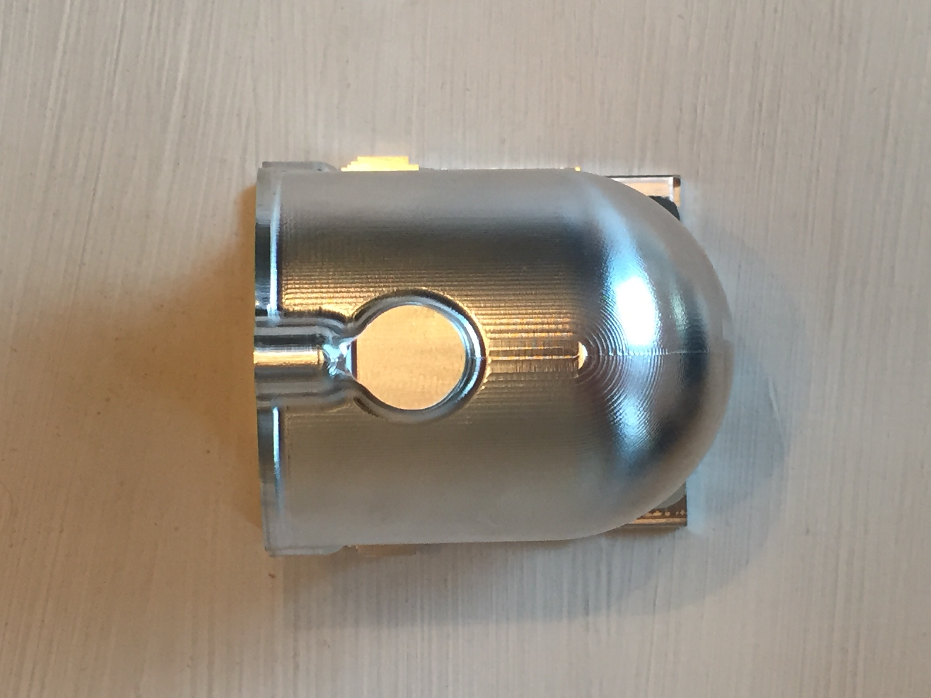

Post by Kevin Pharis » Sun Nov 01, 2020 8:28 pm

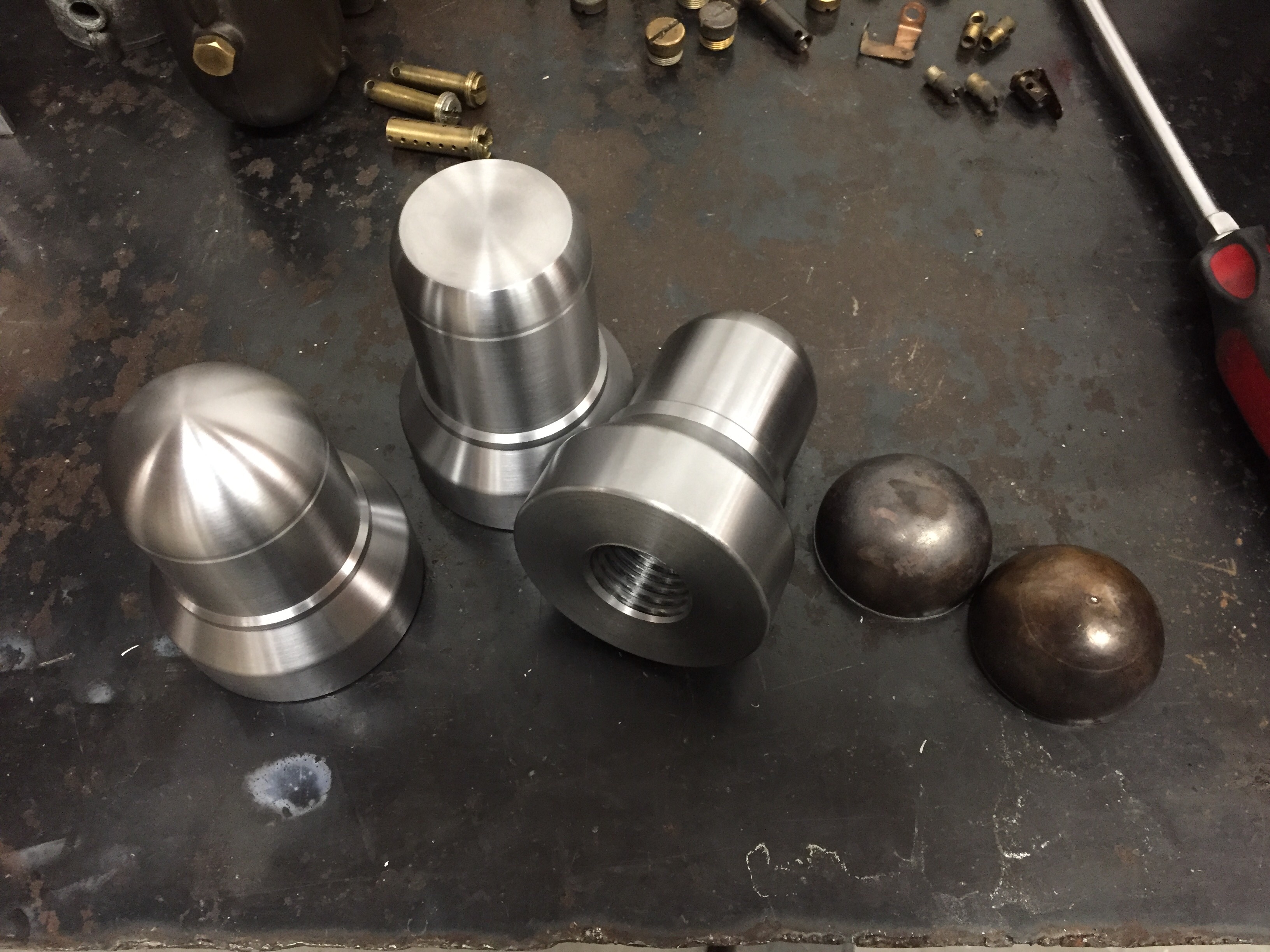

I know how y’all like progress pics...

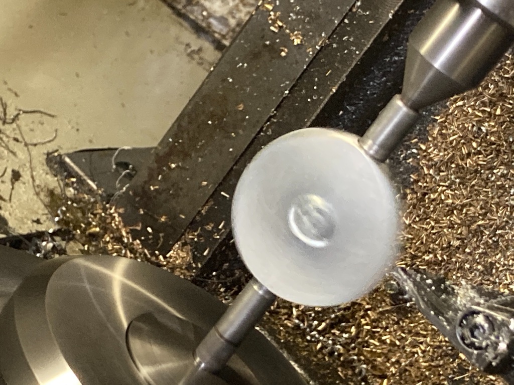

Finally scrounged up the time to finish the first operation of the Winfield model “S” float bowl. The bowl is designed to directly interchange with the originals with the exception of the float ball. I intend to incorporate a readily available replacement float... but still have to figure that part out😬

Nitrophyl ball.

Post by Kevin Pharis » Sun Nov 01, 2020 10:38 pm
big2bird wrote:
Sun Nov 01, 2020 10:20 pm
Nitrophyl ball.

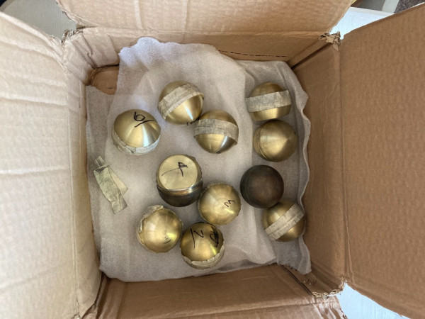

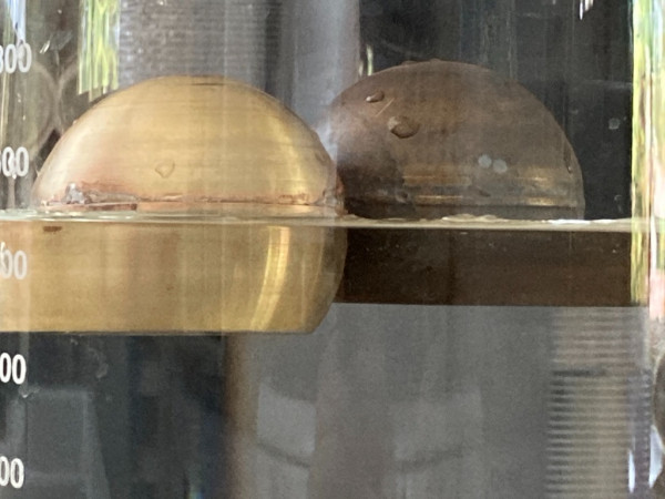

That was the original idea... but Nitrophyl is only available in 1” thick blocks, and I need a 2-1/8” sphere. I haven’t made up my mind yet, but am currently considering a readily available 2” stainless steel welded sphere. Having a special run of Nitrophyl floats is very unlikely to be cost effective. And spinning and soldering floats doesn’t sound like fun either. If the S/S float doesn’t work out, I’m thinking of laminating Nitrophyl sheets and cutting into the sphere, then riveting together with a special made rivet...

Post by big2bird » Mon Nov 02, 2020 6:22 am
Nitrophyl ball.

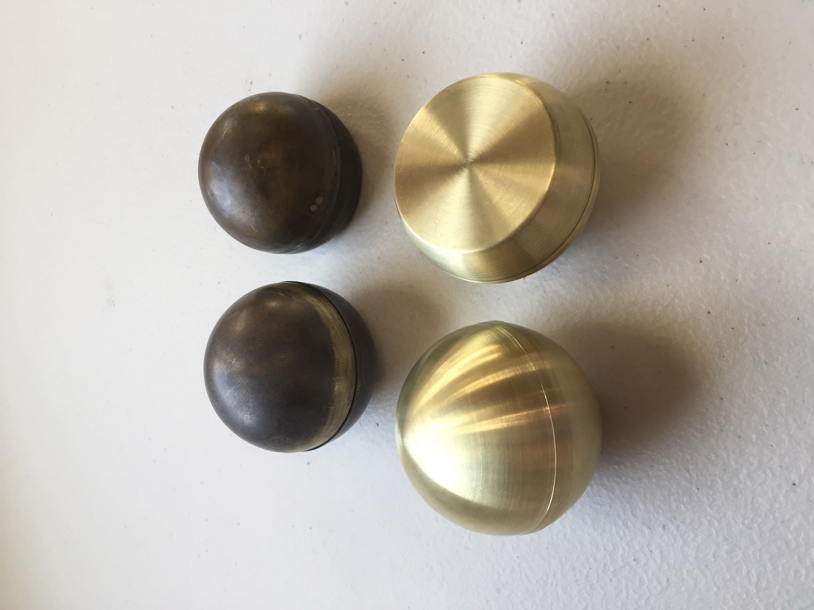

Screenshot_2020-11-02 Shop – Restoration Supply Company(1).png (56.18 KiB) Viewed 42274 times
Kevin Pharis
Posts: 1656
First Name: Kevin
Last Name: Pharis
Location: Sacramento CA
Re: Playin in the shop today...
Post by Kevin Pharis » Tue Nov 03, 2020 9:00 pm

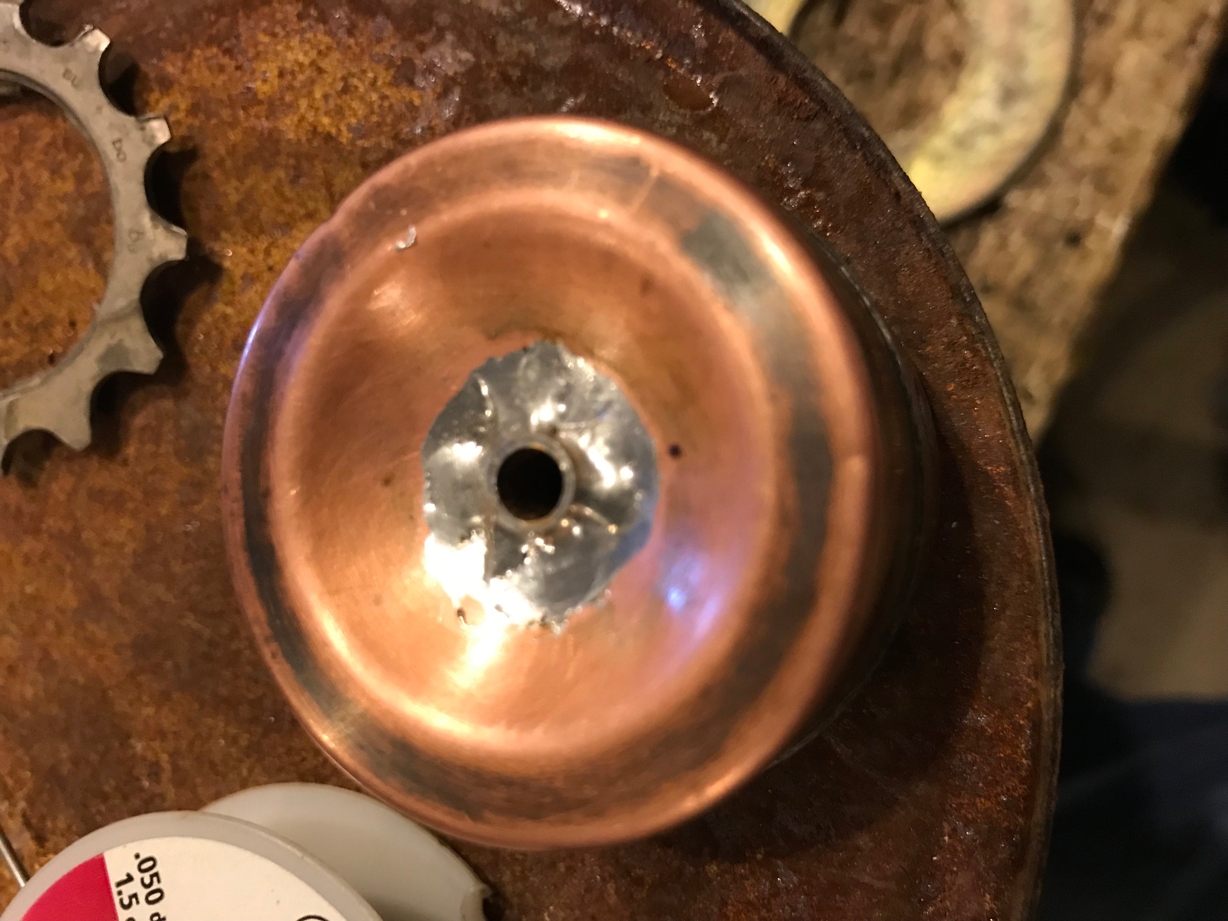

Since Jeff lives just down the steeet from me, I figured I should revisit the metal spinning discussion... met with him today, and it’s lookin promising!
Will make some tooling and see how it turns out...

Finished up the fixtures to spin the new brass floats tonite...
Kevin Pharis
Posts: 1656
First Name: Kevin
Last Name: Pharis
Post by Kevin Pharis » Mon Nov 23, 2020 7:03 pm
Found some time over the weekend to finish the float bowl! :mrgreen:

Post by big2bird » Mon Nov 23, 2020 7:42 pm
Well done Kevin. That looks killer. Kudos.
Kevin Pharis
Posts: 1656
First Name: Kevin
Last Name: Pharis
Post by Kevin Pharis » Mon Nov 23, 2020 10:40 pm
With the float bowl finished, and float balls right around the corner... Seems like the float bowl cover and fuel inlet block should be next. Still have some design work to be done on the throttle barrel, but shouldn’t be too far out in the future

Kevin, I think you need to change your last name to "Winfield"... You are bringing a legend back to life... and watching it happen in front of us is fascinating. Well done, sir!
Kevin Pharis
Posts: 1656
First Name: Kevin
Last Name: Pharis
Post by Kevin Pharis » Sat Nov 28, 2020 8:28 pm
Here’s all 5! They’re deburred, tumbled, and cleaned... and just about ready to use. All that’s left to do is plug off the cross holes that connect the jets to the accelerator wells.
Now I can start on the float bowl cover...👍

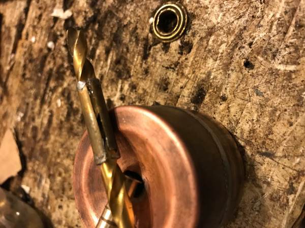

I tried playing mad scientist last weekend... and built up a plating setup for both nickel and copper. Turns out that copper doesn’t stick to aluminum... but nickel does, then can be top coated with copper.
I’m pretty sure I was able to get one of the choke elbows nickel plated (no color change), but couldn’t get any more than a slight haze of copper to stick. I think I need more power! I’ll try again someday when I’m closer to being done, or I’ll just hire a professional...🙄

Kevin Pharis
Posts: 1656
First Name: Kevin
Last Name: Pharis
Post by Kevin Pharis » Thu Dec 03, 2020 10:09 pm
The first float sample pieces are here! They all look and fit good. The material thicknesses all seem to be right, and so I’m confident they’ll float right too. Maybe I’ll try some soldering this weekend...?
Post by big2bird » Fri Dec 04, 2020 5:36 am
Progress. They look great!

Kevin Pharis
Posts: 1656
First Name: Kevin
Last Name: Pharis
Post by Kevin Pharis » Fri Dec 04, 2020 9:02 pm
kelly mt wrote:
Fri Dec 04, 2020 6:59 pm
Kevin, I have a SR that the float sank on, I found round stainless floats about the right size but I'm wondering why the flat area on the Winfield floats?
Incorporating the readily available 2” stainless steel ball float was my original plan. Turns out the buoyancy is wrong compared to the original brass floats, and was going to require a great deal of modification to the float lever. Also, being 1/8” undersize I was concerned with sloshing of the fuel as the ball float acts as a baffle.
The correct float for an SR is spherical, but has a large flat on the bottom, as the addition of the accelerator pump takes up space in the bottom of the float bowl. The S float is a true sphere. Both model floats are pictured above

Post by Kevin Pharis » Fri Dec 04, 2020 10:12 pm
At first look it would seem like “floating is floating”. But turns out the buoyancy of a carb float is a delicate balance. Until this project I never fully grasped the required precision of setting the fuel level. We are always told to measure the gap between the float and lid to set... but rarely consider that the float must be of a specific weight and displacement for it all to work as designed.
Nice job saving your V/H float John!

Post by Kevin Pharis » Fri Dec 11, 2020 11:21 pm
While I wait for floats...

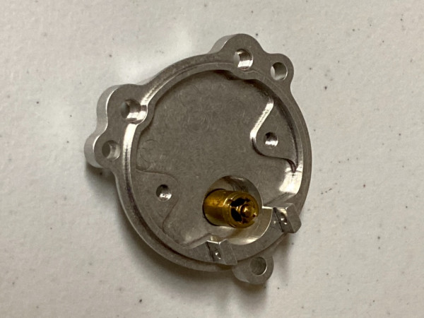

Have been working on the float bowl cover. It’s designed to take a modern Viton tipped needle and seat, and will otherwise interchange with an original float bowl cover. All that’s left to do now, is to crimp the bore to retain the detent balls.

Kevin Pharis
Posts: 1656
First Name: Kevin
Last Name: Pharis
Post by Kevin Pharis » Tue Dec 15, 2020 9:38 pm
All that’s left now is the throttle barrel!

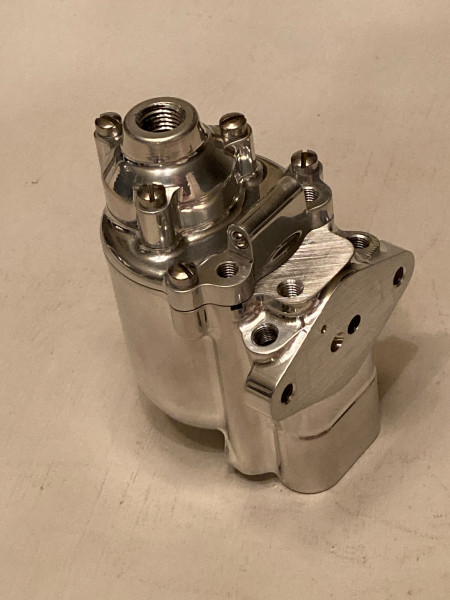

Post by Kevin Pharis » Sun Jan 17, 2021 3:11 pm
Finally feel like I’m making some real progress today...
Still have to finish the external surfaces on 2 sides... but that seems like the easy part!😉
Kevin Pharis
Posts: 1656
First Name: Kevin
Last Name: Pharis
Post by Kevin Pharis » Tue Feb 23, 2021 9:51 pm
It’s been slow goin since my last post... but goin better now that I have got the first operation of the throttle barrel refined down to 7 hours! And I won’t mention the few bad parts that have happened along the way😬
But while the mill runs the throttle barrels I have started the lathe work making some of the small hardware pieces. So far I’ve got stainless steel bowl to barrel studs, brass float bowl level plugs, and brass idle port plugs. I also ordered custom ground piloted reamers for the throttle shaft bushings, and have been getting staged to make the throttle plates and shafts before finishing the OD of the throttle barrels.

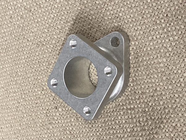

I did get distracted making a couple S-A to Model A intake manifold adapters in the meantime too...

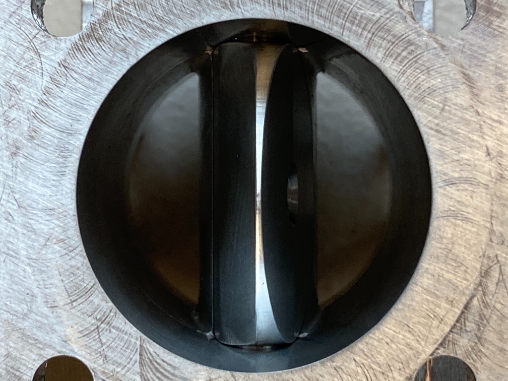

Post by Kevin Pharis » Sun Mar 07, 2021 8:47 pm
Today was throttle plate day. It started out kinda iffy this morning... but smoothed out nicely enough to yield a couple of nice fitting throttle plates
Here we are in the lathe gettin spherical
Post by Kevin Pharis » Wed Mar 10, 2021 4:04 pm
Thanks for the kind words fellas. This project definitely started out as playin... but now it’s turned into more of an obsession! My wife even started calling it “the other woman”. Still fun tho!
The throttle plates were a challenge figuring out how to make. They are basically a modified ball bearing... so where do you start, and what do you hold on to. I finally figured how I could cut all the important surfaces in one operation, then finish the spherical OD in the lathe.
There is no shortage of challenges with this project! But I am looking forward to the throttle plates and barrels being finished, cuz all that will be left is the internal brass. Seems easy by comparison...🥵
Kevin Pharis
Posts: 1656
First Name: Kevin
Last Name: Pharis

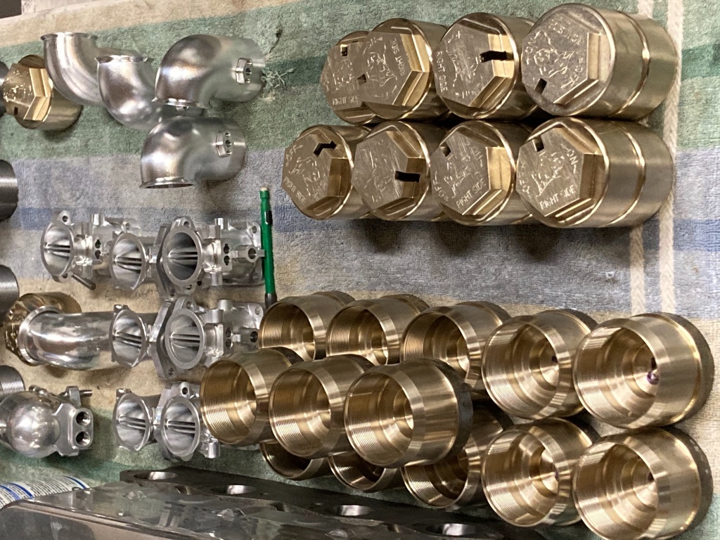

Post by Kevin Pharis » Sat May 08, 2021 10:36 am
Been cruzin thru the brass components pretty smooth lately. Have all the lathe work done... and almost all of the mill work too. Just a few more pieces to cut slots and drill holes in, and then it’ll be time to finish all the other odds and ends...

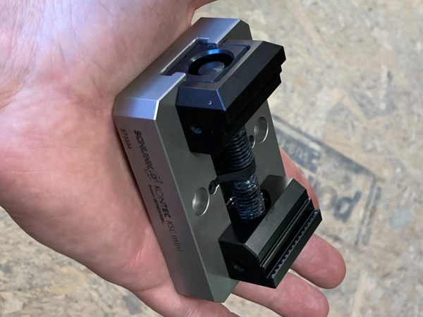

And since I was making all these little parts... I figured it was time to splurge on a new toy too. After all, you can’t be all work and no play! So I treated myself to a new milling vice...
The fixture I made to mill the float bowls and throttle barrels was allowing the material to move around during certain drilling operations, causing much unnecessary heartburn at times! This little beauty should solve my issues.

Kevin Pharis
Posts: 1656
First Name: Kevin
Last Name: Pharis

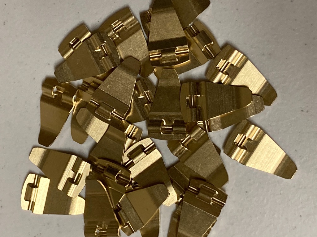

Post by Kevin Pharis » Sat Jun 05, 2021 2:09 pm
After almost 7 months of waiting, I was finally able to guilt the metal spinner into producing my float halves... looks like I will be doing my own metal spinning in the future🙄. Out of the 20 or so pieces, I was able to find 2 pieces that could be assembled into a dimensionally correct part.
I’m going to have to make another batch tho, as the weights of the components isn’t quite right... and so my new float doesn’t quite float like it should😬
It’s all good tho, as now I have lots of parts to practice soldering with👍

My first batch of float bowl covers had a minor design oversight... so did the second... but that’s all behind me now with the third edition! So I made up a batch and have been working toward complete subassemblies of cover, detent balls, Viton tipped needle and seat, and float lever.
The float bowl covers were a minor dimensional adjustment from the previous design, a new detent ball crimping fixture was made, and all went smoothly and assembled well. Just had to decide what to do for the float levers...
I went back and forth for a bit... and eventually decided to machine them from solid brass bar. So while I was at it, I made a few

Post by Kevin Pharis » Mon Aug 23, 2021 9:47 pm
Well... had a bout with the C19 over the last several weeks, causing a complete and total stop to all progress on all fronts. I’m back on my feet now, and trying to catch up to all my irons in the fire.
Turns out there is a rush on Buffalo wheel parts this year, and so I will be distracted for at least the next few months. Not all carb progress will halt tho... I will still be pushing the metal spinner to complete the float balls, and also workin to have the Akron-Hed intake manifold cast using 3D printed sand. We’ll see what other carb projects slip into the mix along the way...

Post by Kevin Pharis » Sat Nov 06, 2021 12:51 am
Made some exiting progress this evening! After what feels like forever, I was able to get a throttle barrel back in the mill to take the final finishing cuts. Still have a few holes to drill, but cosmetically this part is essentially finished
I hope to have at least 1 of these throttle barrels cleaned up and ready to run by the end of the weekend...😁

Post by AndyClary » Sat Nov 06, 2021 11:05 am
Looks good Kevin. You were actually able to get this detail on Millzilla? That’s a lot of table to move around.
Andy
Kevin Pharis
Posts: 1656
First Name: Kevin
Last Name: Pharis
Post by Kevin Pharis » Sat Nov 06, 2021 11:45 am
Sure did Andy. Turns out Millzilla can do nice work if I talk to it real nice😉

Post by Kevin Pharis » Sat Nov 06, 2021 7:18 pm
Success!!!
Well... success on this test part with bad internal features. Will have to get out in the shop early tomorrow to make up one that is good all over!😁

Post by Kevin Pharis » Sun Nov 07, 2021 4:37 pm
Gettin there... :mrgreen:

Post by AndyClary » Sun Nov 07, 2021 10:39 pm
I hate to say it, but it’s almost time to bolt it to a motor and see if it works. I’m thinking the odds are pretty good it will.
Andy
Kevin Pharis
Posts: 1656
First Name: Kevin
Last Name: Pharis
Post by Kevin Pharis » Sun Nov 07, 2021 11:00 pm
The punch list is pretty short now... need to drill one last idle passage in the throttle barrel and it’s DUN! Need to build and install 2 brass plugs to plug off main jet passages in float bowl and it’s DUN! Only parts left are the float ball and the throttle shaft stop lever, and I will begin to test with originals rather than wait for these to finish.
The head needs some minor machine work still... need to machine down the valve guide bosses to clear the inside of the T valve springs, and make thick shims to get the springs to the proper compressed height when installed. Also facing off the head bolt bosses to the same heights so that the rocker sub plate doesn’t twist when the head bolts are installed.
In all reality, only minor work left to do!

Post by Kevin Pharis » Tue Dec 07, 2021 12:11 am
Been a busy few months since my last update... Buffalo wheels, Buffalo rear hubs, Buffalo hex caps, Winfield choke horns, Winfield V band clamps, Winfield fuel inlets, and I’m sure I’m forgetting something...
But at least the shelf will be stocked for a bit

Post by Michael Peternell » Tue Dec 07, 2021 8:31 pm
I Just got a visual of ksanta's workshop with all the millelves working! You do fantastic work sir!

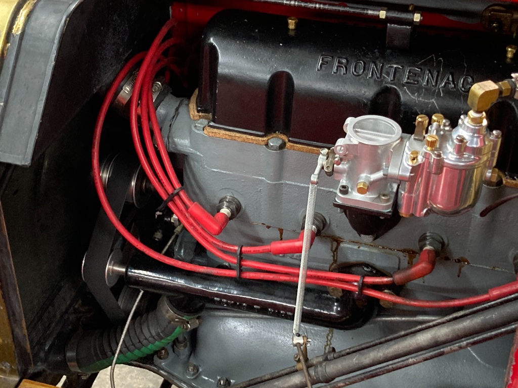

Post by Kevin Pharis » Fri Dec 24, 2021 8:12 pm
Testing on my dads touring today. Swapped out his original S-B for my new one, and running pretty darn sweet!! He’s goin to hook up the linkage and we’ll do some road testing later😁😁😁

Post by Kevin Pharis » Wed Feb 02, 2022 10:32 pm
The running carb was shipped to a specialist a couple weeks ago... and it turns out today was it’s turn on the flow bench. There will be an official report next week, but the preliminary report this afternoon was really good! The guru likes the design, and compares it to a “Fish” performance carburetor produced in the 40’s - 50’s.
I was surprised when he told me that this seemingly little carb flows an amazing 153 cfm!!! That makes this carb similar in size to a Stromberg 97!
