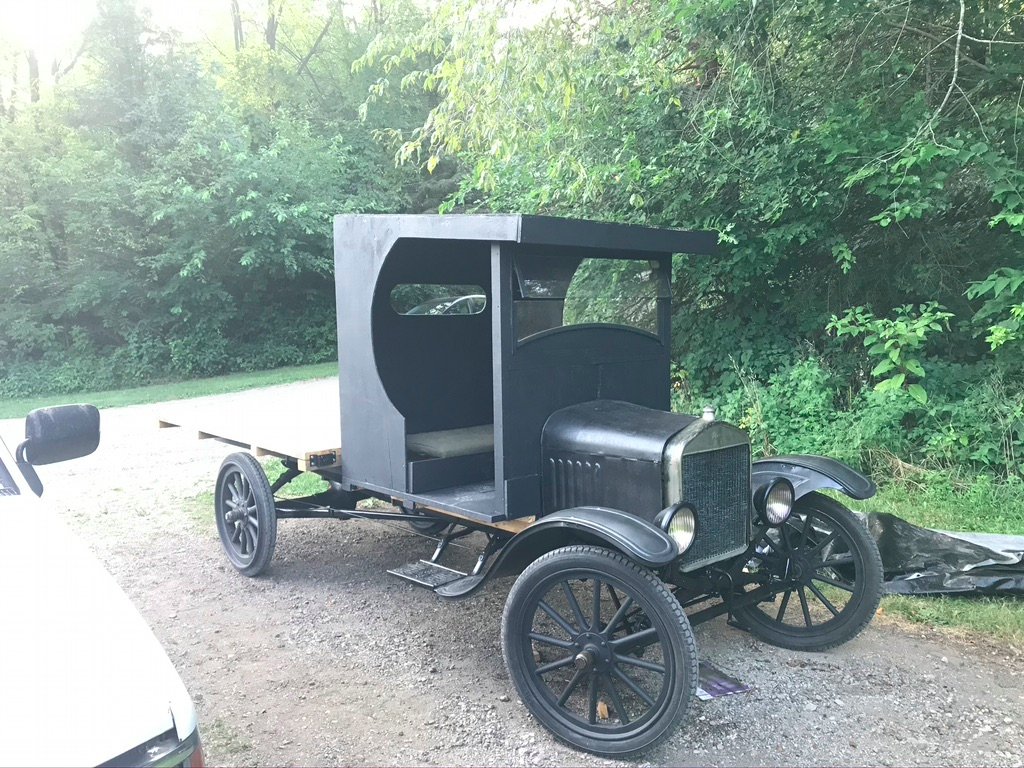

John, reference the picture. He doesn’t have a flatbed. He has a “nobed”

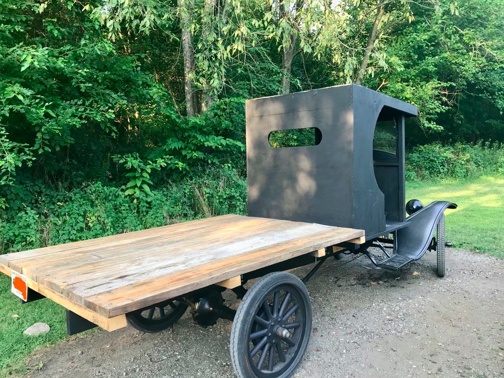

There's a bed there, you just can't see it in the first pict.

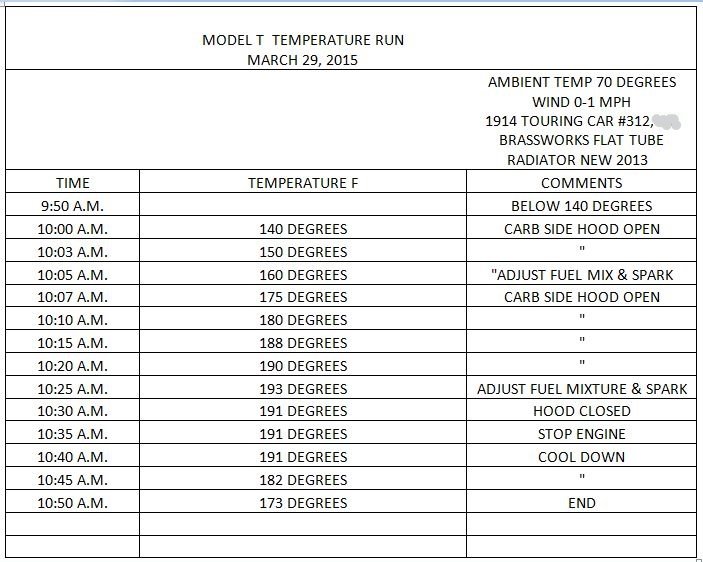

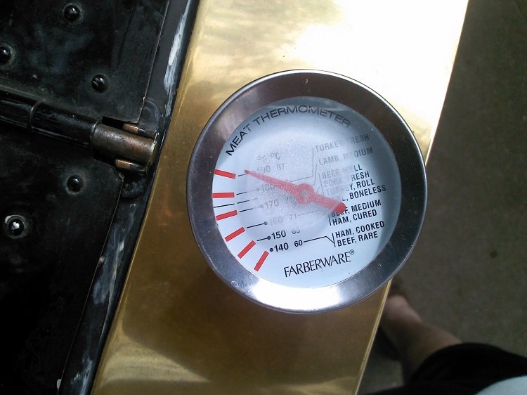

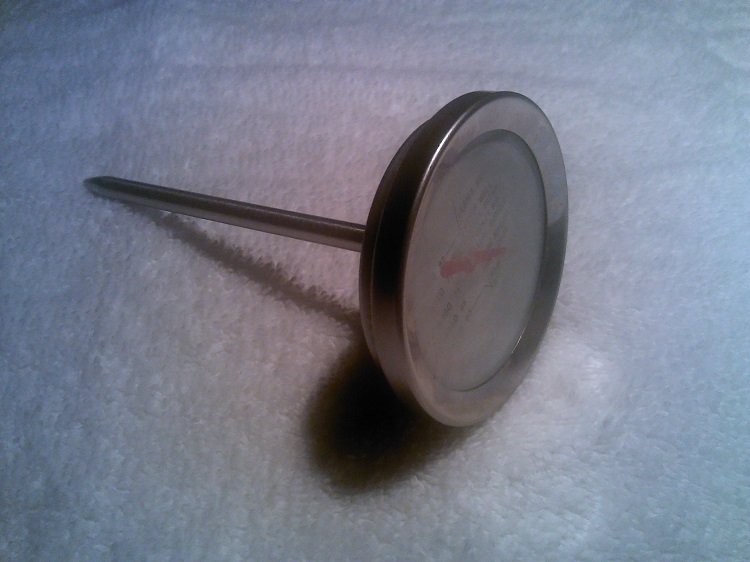

Scott,
I believe you pretty well have your answer but I thought I would mention a rather easy
way to check radiator and carb setting in your driveway with a kitchen thermometer.
I use that same thermometer to check my 160 degree thermostats for my '35 Ford cabriolet.
The V8 stats open at 160 so the gauge is close.
I just set up the car in the driveway with the carb side hood of the Model T open and let it run.
Radiator cap off and just leave the gauge in place.
Here is a chart of the T temperatures I ran in 2015 with ambient @ 70 degrees, 0-1 mph breeze, 50/50 antifreeze.
This car doesn't boil on tour.
It will blow a little using Low Pedal on the "Twisted Sisters" grades near Bandera, Texas.
A couple of those grades are 1/2-mile of LP
The '14 has a Kingston 4-ball, stock transmission and rear end.
