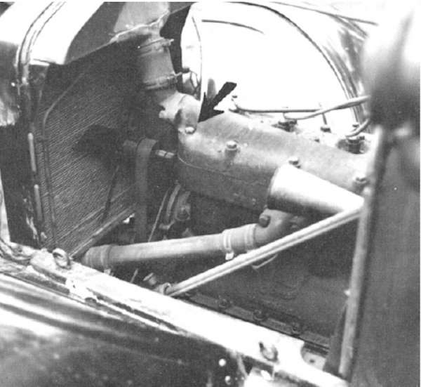

When I read the question I thought of the 1917 Rip Van Winkle. Does it have its original hoses? My second thought was the MTFCI restoration guidelines. I found nothing there.
In this old B&W photo are the the Rip's hoses red or black? I'm guessing red. They seem too light to be black. The fan belt is much darker.
I haven't tried the switcheroo with modern and original clamps. I use the original type, but I put filister head screws in them so the screwdriver can get a good grip. For a good seal you can put Ultra Black on the inside of the hose and slather grease on the outlet or inlet for ease of removal the next time you have to take things apart.

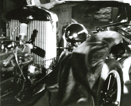

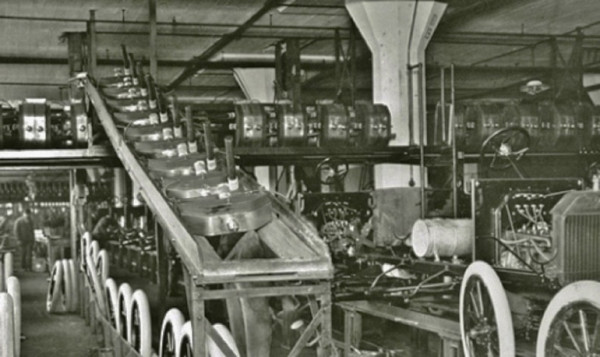

Could be the hose color varied, as aftermarket parts catalogs state 'gray' or 'red' for hose color on replacement Ford hose.
Looking at period photos of T's on assembly lines supports the lighter hue of red to me. So red is probably correct. The Model A hoses are black but have a red parting line strip that seals the seams. Back in the day 'red' rubber was considered higher quality, and 'red' rubber inter tubes for tires were priced higher.
Lighter color hoses on these brass era radiators....
And by 1927 still has a light color like a red hose.

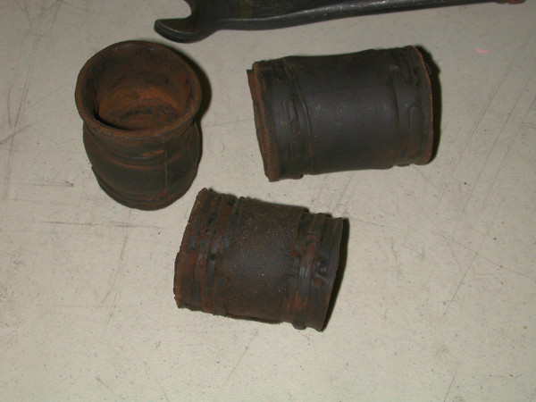

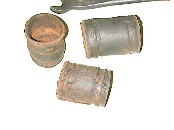

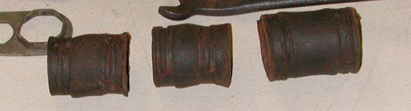

Here are the original hoses from the 1917 "Rip Van Winkle" Ford touring.
This car has a June 1917 motor serial number and was most likely assembled at the Minneapolis plant.
Click on the first photo to enlarge. Click on it a second time to make even larger.
Note that the inner and outer layers of rubber are thin compared to the canvas sandwiched between the layers. One hose has lost a lot of its outer layer of rubber almost completely exposing the the canvas.

Erik
Thanks for posting photos of these original hoses to that '17!
I lightened them up a bit to examine. Seem to have a black appearance, yet under the clamps appears some red? Or just rust deposits? Or maybe were red and then got years of dust, dirt and crud from that T touring sitting on those custom wood post blocks in that lean-to shed for decades

I have higher resolution versions of the photos (I also cropped the second photo).
In my opinion, it's rust.

So apparently on that particular 1917, Ford they were black. But it wouldn't surprise me to find that they varied by supplier, or by year, or both.
