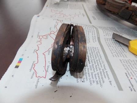

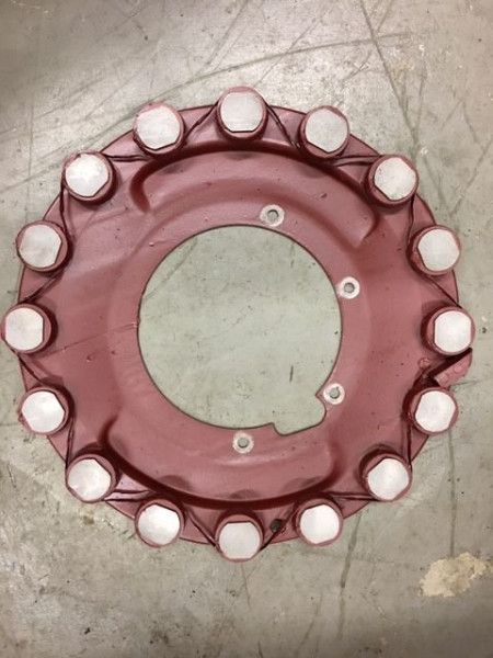

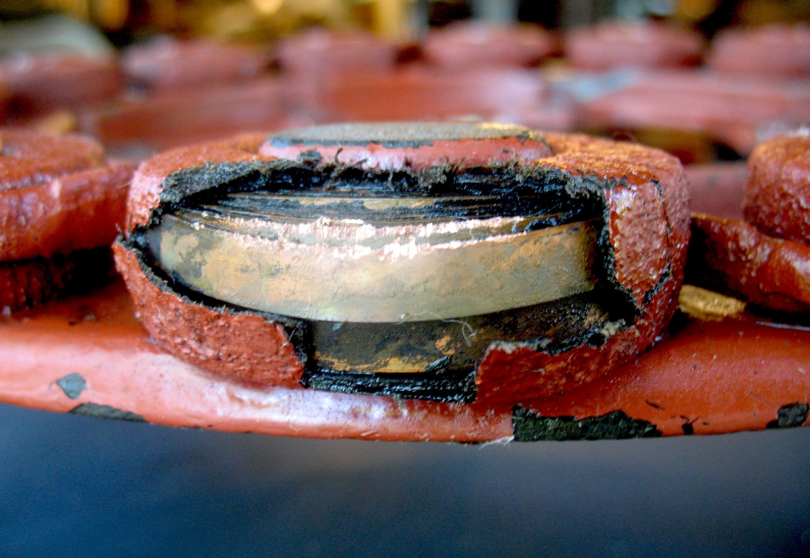

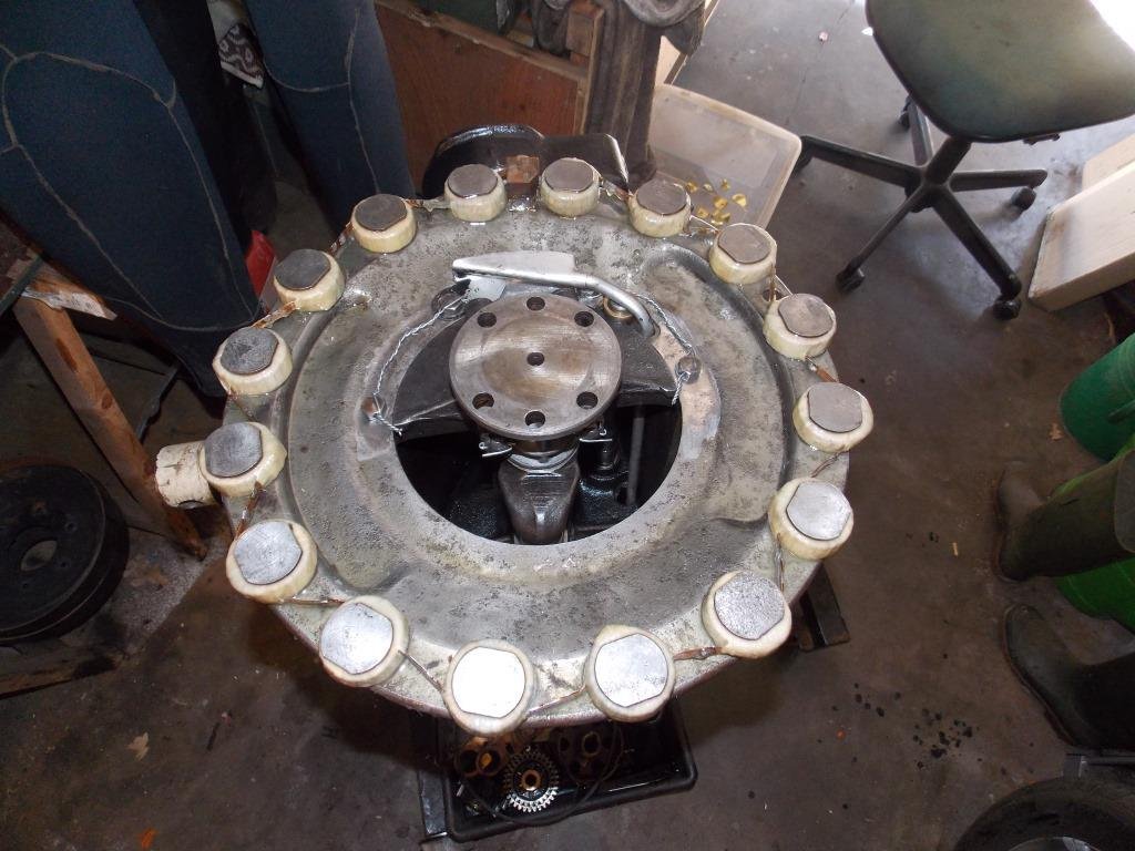

Because it worked and was painted, I always assumed that the mag ring in my 1915 runabout had been rebuilt.
But recently it fell on the floor and suffered this boo-boo, revealing that under the paint was brittle old insulation. Maybe I could patch it up and use it and it would be fine, but I'm not delighted with the idea of relying on that 105-year-old insulation. With Total Re-coil gone, is there a go-to source for a fresh ring?

Steve,
there is a guy here in Denmark that make them, but.....

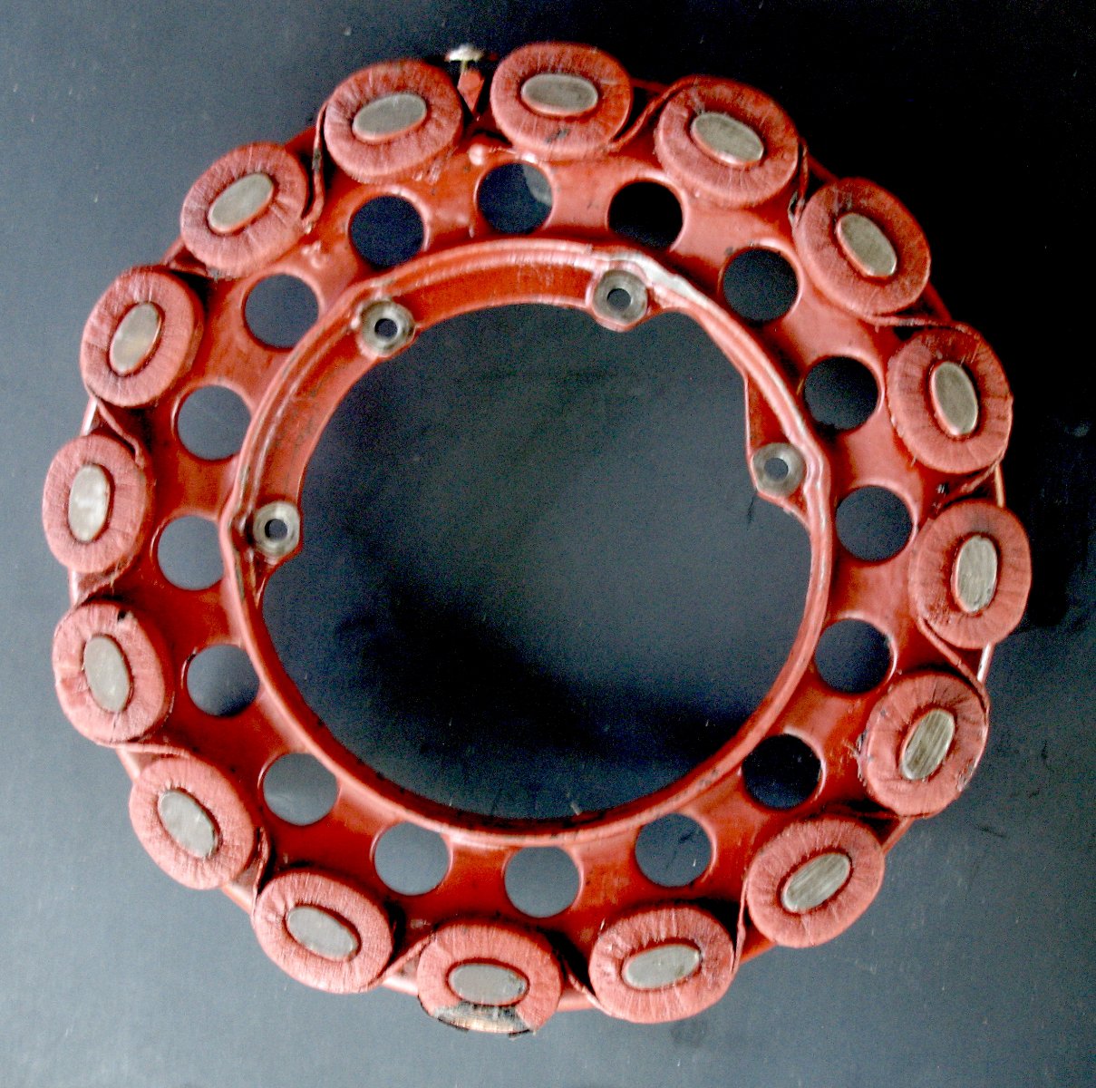

Steve,
I will try to answer your questions.

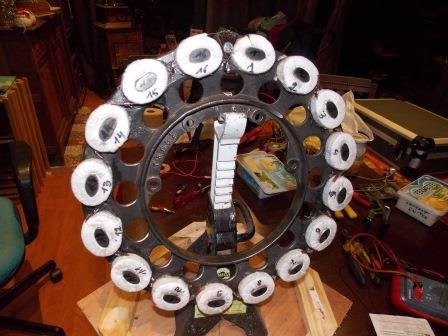

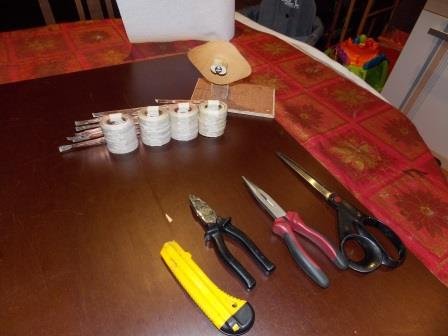

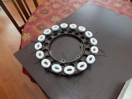

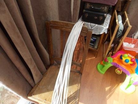

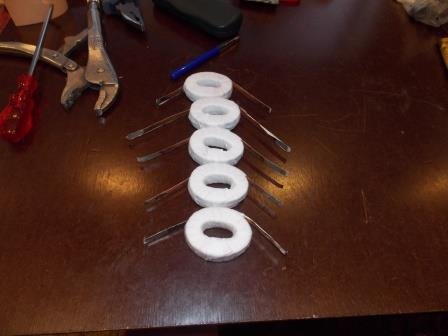

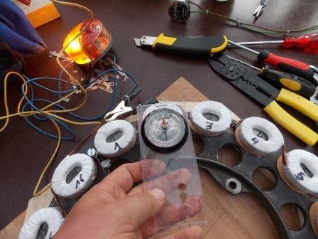

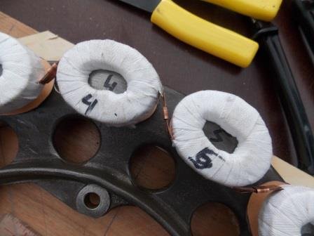

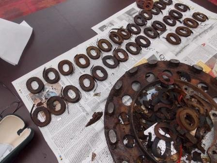

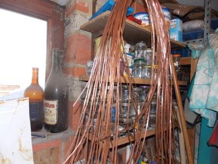

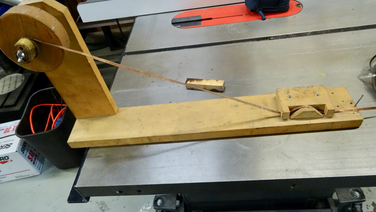

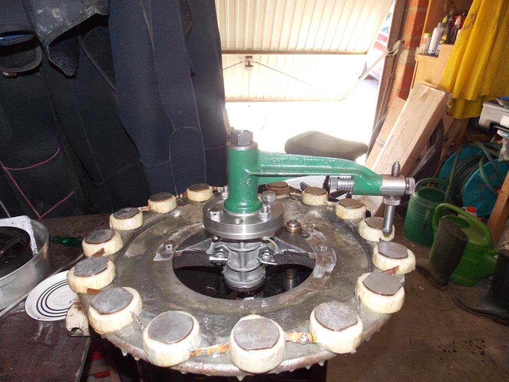

1 From what I've read of Kapton™ tape it appears to be an ideal insulator to wind in the coils. Has anybody here used it, and if not what have you used?
Kapton Tape will work good but is hard to find here. I take M3 masking tape that resist detegent and oil. After having cleand and straighten the cupper wire I fix them on a straight piece of wood that takes all the lenght of the string.Set the insulating tape on one side of the string.
You will need to make 32 strings to make 32 coils .
2 On a double-coil ring I expect there should be insulation between the upper and lower coils. Correct?
Each double -coil is made out of two coils attached together in a way that the direction of the windings are the same. The two coils of each double coil need to be insulated very well from each other. I use gasket paper to do this.
3 One suggestion I read was to anneal the copper before unwinding by putting the ring in an unspecified "heater" or perhaps on a charcoal grill. Any comments on this?
I never done this but it is maybe an easy way to get the grease and dirt off. I clean mine with disolvent and elbow grease. At the same time I straigh them up.
4 What should be wrapped around the coils?
3/8 cotton tape 130cm is needed for each coil.
5 Should the strips between coils be wrapped, or is the final overall coating sufficient?
The final coating will do the job just put a lot of it on them to fill up the place where the string come out of the coil.
6 What is the best coating?
I use polyester coating It is done in 4 layers. First a primer to give the polyester coating a better fix to the cotton and steel, Two coats of polyester resin, to finish I use clear coat.

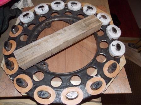

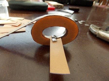

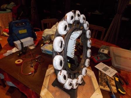

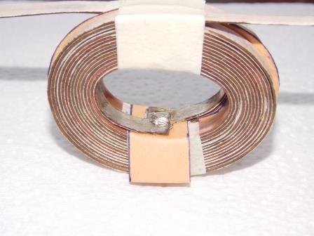

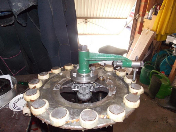

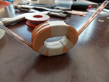

I will try to set a few photos on the forum. It will take a few threads.
Good luck
Andre
Belgium
Good luck
Andre
Belgium

AndreFordT
- Posts: 566
- First Name: Andre
- Last Name: Valkenaers
- Location: Scherpenheuvel
Re: Fresh mag ring?
next photos.
- Attachments
- DSCN358301.jpg (87.76 KiB) Viewed 9229 times
- DSCN331301.jpg (86.75 KiB) Viewed 9229 times
- DSCN331001.jpg (82.02 KiB) Viewed 9229 times
- DSCN330601.jpg (87.61 KiB) Viewed 9229 times
- DSCN330401.jpg (85.24 KiB) Viewed 9229 times
AndreFordT
- Posts: 566
- First Name: Andre
Re: Fresh mag ring?
And a few more.
- Attachments
- DSCN363901.jpg (92.28 KiB) Viewed 9225 times
- DSCN363801.jpg (99.28 KiB) Viewed 9225 times
- DSCN363601.jpg (97.8 KiB) Viewed 9225 times
- DSCN362701.jpg (96.56 KiB) Viewed 9225 times
- DSCN362601.jpg (86.2 KiB) Viewed 9225 times
AndreFordT
- Posts: 566
- First Name: Andre
Re: Fresh mag ring?
just forgot to tell.
Price for all the needs is less than $20,-
Time spend is about 20 hours. That makes the price for a rebuild one.
A single stack will take me about 10 hours to rebuild.
Andre
Belgium
Andre
Belgium

The last coil ring I did was a double round with demontable cores for a 1912 engine.
As you said Steve the most of the price is set by labor.
For the double round coil I asked €240.- about $260.-.
The raison why I started to rebuild magneto coil rings was first the price but also the shipping price. To belgium it is easy $80.- that twice. I need to send the core before they send me a rebuild one.
The price I am asking do not cover my labor but I only work for friends so... .
André
Belgium

Mine had that problem too, but on more places than yours (and because of the problems that led to me taking the damned thing out, I had to fix it too), I just mixed up some potting epoxy and applied liberal coats to the exposed coils. Then then painted them with that spray-on red electric varnish you get from vendors like Lang's.
Works pretty good, haven't had any problems so far.

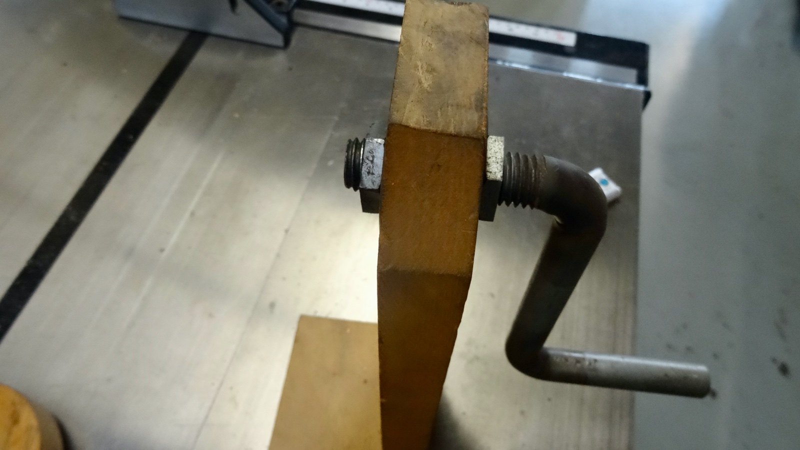

Here's a jig I made to wind the coils. I have more pictures and info. I got some of my supplies from the local electric motor rewinding facility who also varnished and baked the finnished ring. I made the handle for this jig out of a long 1/2 inch bolt.

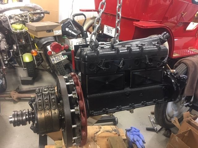

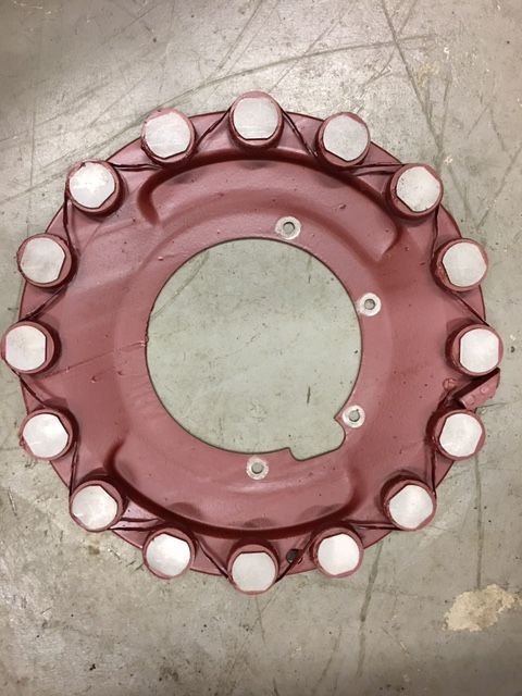

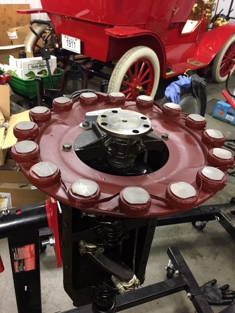

Here bellow the one RV Anderson made for me in April this year. I'm very please with his job.

Steve: I've done one single stack, probably won't do another, the vendors do it better and faster.
I would never roast or cook a core to clean it, too much risk of warping the frame. The original shellac was a bigger challenge than the oil, I washed off most of the oil with kerosene, let it dry and then soaked in denatured alcohol softening the shellac until I could remove the coils without damaging them, since I re-used the copper. (I think all rewound single stack are done these days with new copper strip, I think double stack still re-use the copper) Various solvents, scotch pads and even course steel wool worked for me to clean up the strips. I made sure there were no dings in the strip that might work thru the insulation. Before I rewound the copper I stretched each strip about 4" (~4" in 12' = ~3% strain) which made it straight and flat.
I used McM-Carr p/n 7574A11 fiberglass tape for the between layers and overwrap insulation. That tape silicone insulation is rated up to 500F and is 0.007" thick, comparable to original paper insulation thickness. I split the 1/2" wide tape for application to the strip and used full 1/2" for overwrap. The original Ford overwrap was cotton twill according to one source I talked to.
For the insulating washers between the coil and frame I used 0.020" thick fishpaper, available in sheets from McM, thinner might work better for between coil insulators on double stack.
For final topcoat insulation, clear Glyptal 1202 electrical varnish. I first 'glued' the fishpaper discs and individual coils to the ring with the 1202, waited a day, made and verified the electrical connections and then saturated the entire assembly with liberal brush coat of the varnish. (Apply liberally, don't just give a hairspray coating from a spray can like some videos show). Let it cure a day or two and then bake at 200F for an hour to finish cure. The 200F and one hour bake is from the Glyptal manufacturer, and there is very little smell from the oven.
Andre shows how it all goes together and his work is excellent. RV has excellent products, and very fair prices.
Have fun, jb
Have fun, jb
AndreFordT
- Posts: 566
- First Name: Andre
Re: Fresh mag ring?
Steve,
I just send you a PM.
Andre
Belgium
Andre
Belgium
