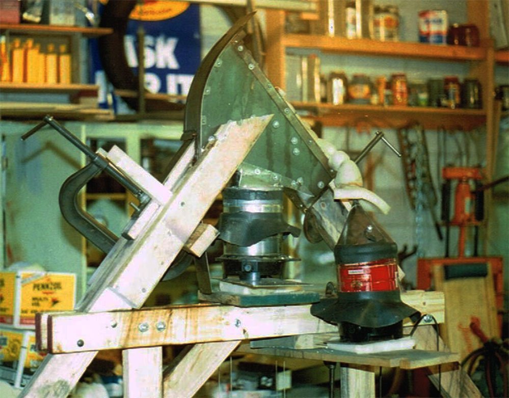

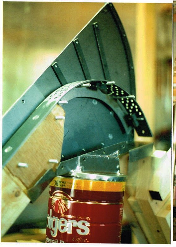

I will re-post the box I made for steam bending my Bus bows. It has a sliding door which allows the bow to receive heat while bending. I just heated water in a coffee can. Perhaps a simpler box could be made if you end up having to steam them.

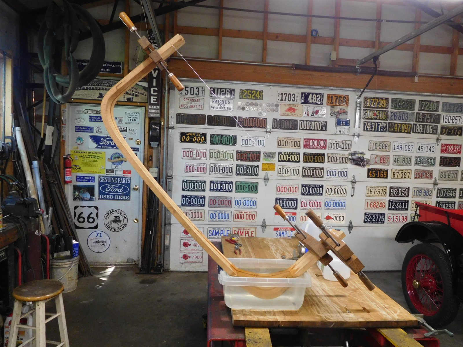

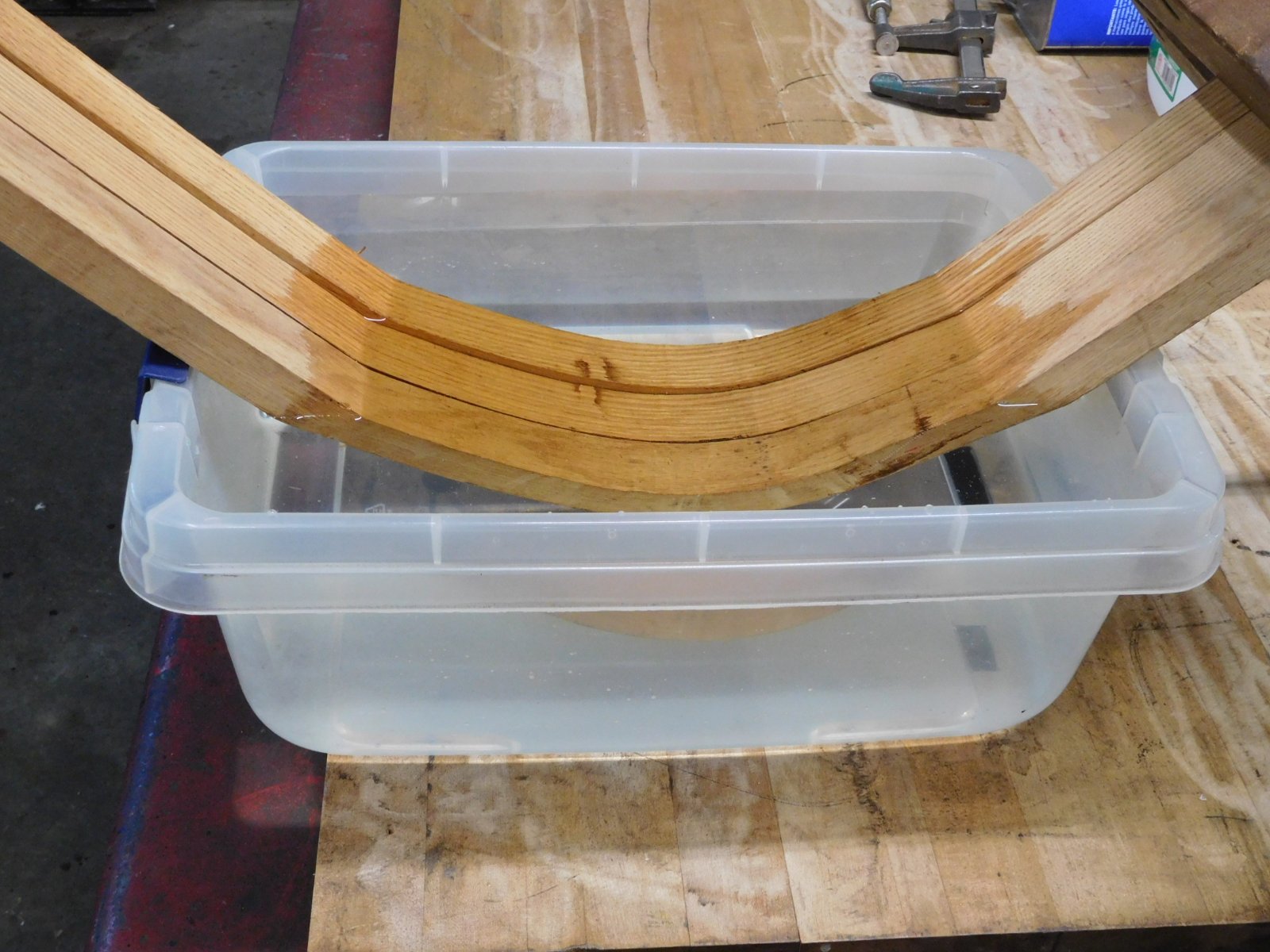

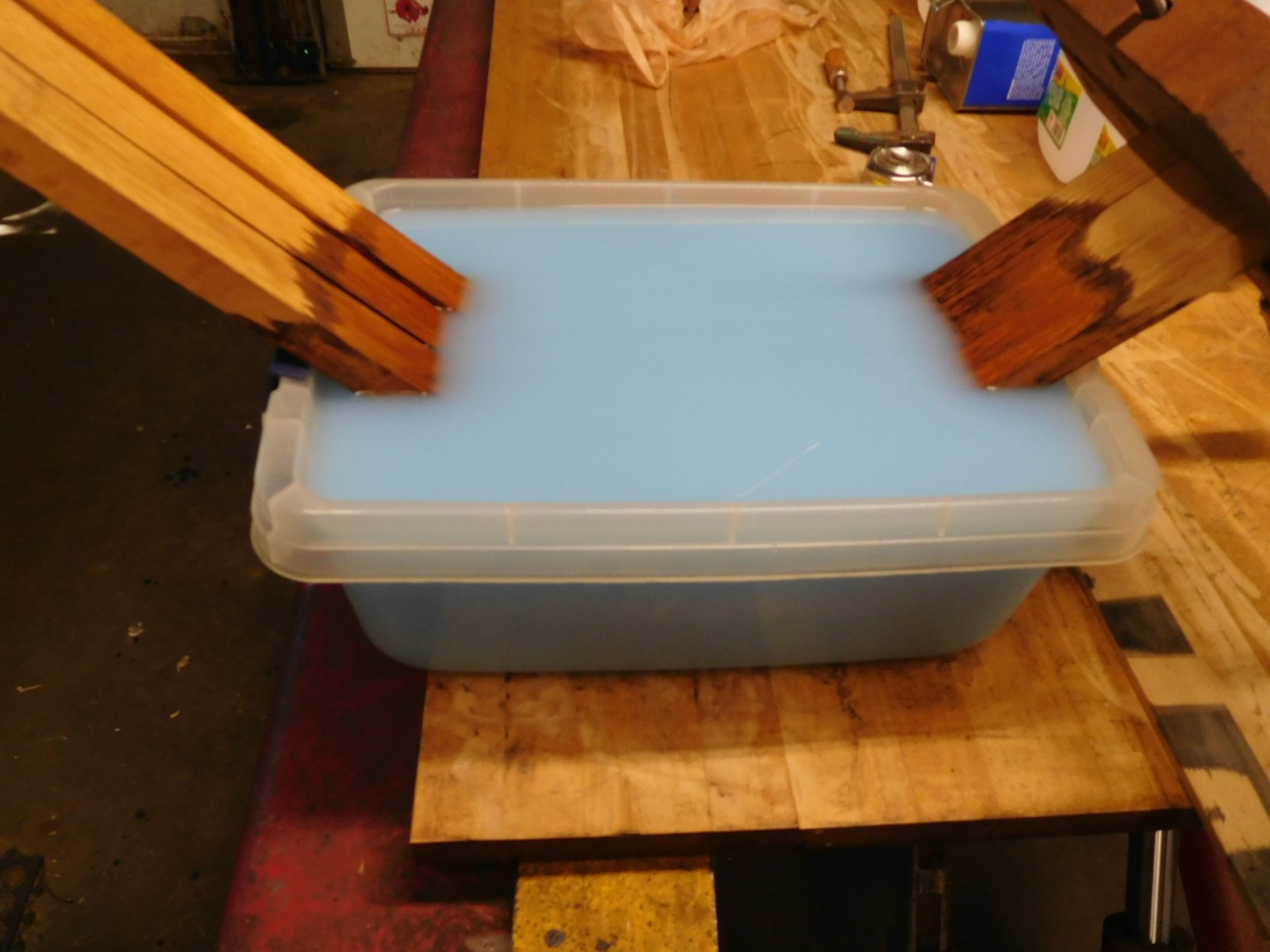

OK, here is my setup. I pulled the ends into position using a pipe clamp, then wired them together to hold them that way. The upper ends of the bows are hanging by a wire from the garage door track.
After reading the previous post, I may run to the store and get some Downy fabric softener.

It's prettier with the Downy added.
