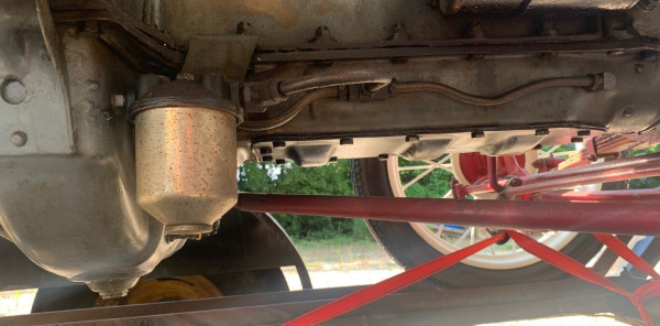

Recently acquired a Model T Speedster. It has an aftermarket oil pressure system. Don't have a clue about the Builder.

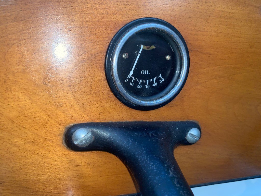

I started it and zero oil pressure to the gauge. Oil is as supposed to be, upper petcock. The pump and filter are above the Model T "sump" could it needed to be primed?

This may sound radical, but I would pull at least the covers (if not the motor), and make sure your pressure oil system is operable. You may need to have a higher oil level than stock, your pickup (wherever it is in this motor) may be clogged, your filter as well... your pump could even be shot. Heck, your pressure gauge may even be broken (or disconnected)...

Most full pressure T engines I have seen and the two full pressure speedsters I've had used a deep oil sump that mounts were the dip tray is. I would worry that placing the oil pickup in the stock T sump could suck air as the motor RPM went up even with just the flywheel and no magnets. The VW pump driven off the cam can loose prime, I had that happen to me and had to take off the oil line and fill it with oil from a point above the hogshead while someone hand cranked the engine slowly.

Added note I primed the oil pump from the suction side. Your picture shows the pressure side you may have to remove the hogshead and check things out.

Try pulling the mag post and takin a peek down into the hogshead... sometimes there is a priming tube routed up there with a cap for just such an occasion

Excellent responses. Thanks! I can pull the hogshead and the drip tray. Drain the oil and filter. The idea of pulling the mag post and see what's there resonates to me. At least I can see the setup of the oil pressure system.
Somehow there is some kind of prime the pump. There is no hand pump. But, logically, there is a simple answer.

Drained the oil. Then pulled the filter (There is a bolt on top that drops the filter housing). It was seriously clogged with crud. Cleaned the housing inside and out. Filled the housing with fresh oil, then added fresh oil Non-Detergent to the engine.
Pulled one of the oil lines that feed the engine mains. Used a hand pump and pumped in fresh oil to prime the pump. Not sure what is supposed to prime the pump, but this worked fine.
Took the oil line going to the gauge and blew through it with my air hose. Gauge worked fine.
Put everything back together, fired it up and HAVE OIL PRESSURE! It was so sweet to see the needle peg!
