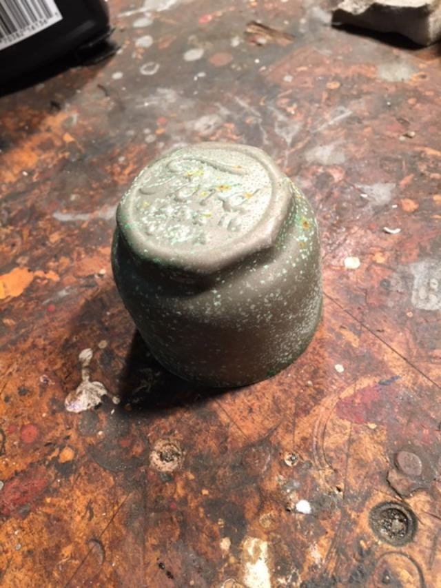

The hubcaps on my T are badly corroded and want to find out the best way to clean and bring them back to life?

If the plating is good, then Simichrome polish will do a good job, Your playing appears to be blistered. The most economical thing to do would be to get a set of good used ones.
Posts: 4381
Re: Best way to clean nickel hubcaps?
Post by Wayne Sheldon » Mon Feb 18, 2019 12:55 am
Old nickel plated hubcaps may be nickel plated over either brass or steel. Often, the brass ones will wind up polishing through to the brass below. Not a bad thing for those wanting brass hubcaps for a brass era car. Not necessarily good for those wanting proper nickel plated caps on a black era T. The nickel plated steel hubcaps sometimes actually clean up better than do the brass ones. If the plating on the steel hubcaps is bad, about the only thing they are good for is being re-plated (nickel preferred), which actually makes the nicest looking nickel hubcaps in my opinion!
Posts: 7130
Post by Allan » Mon Feb 18, 2019 7:00 am
I have found a few nickel plated aluminium hubcaps. They corrode differently from the brass ones, and no amount of polishing will rescue the plating on them. Your photo looks like the colour of an aluminium one, but it could well be brass. If so, there is no better way to fix the problem than having good originals like that re-nickled.

If they don't polish up, buying a new set at $66.50 may be less costly than replating.

That's rather odd corrosion. Do you live by the ocean perhaps?
Posts: 3901
Location: Lomita, California
Post by Original Smith » Mon Feb 18, 2019 11:01 am
I believe your problem is, it's a reproduction hubcap.

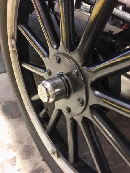

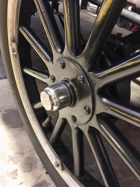

Fozz71
Posts: 280
Joined: Wed Jan 16, 2019 11:38 am
Last Name: Chochole
Location: Oswego, Illinois
Board Member Since: 2003
Post by Fozz71 » Mon Feb 18, 2019 1:56 pm
I ended up doing a very light wire wheeling with a soft wire, then buffing and polishing by hand. They turned out decently, and my car is a go car not a show car. They'll do just fine, take a peek.
Posts: 4381
Post by Wayne Sheldon » Mon Feb 18, 2019 3:55 pm
That looks really nice to me!
BHarper
Posts: 243
First Name: Bill
Last Name: Harper
* REQUIRED* Type and Year of Model Ts owned: '14 Touring, '20 TT Farm Truck, '24 TT Depot Hack, '24 Coupe, and a 1914 Metz Model 22 Torpedo Runabout
Location: Keene, New Hampshire
Post by BHarper » Mon Feb 18, 2019 9:45 pm
Hi Jim (fozz71),
Your polished hubcap looks good.
Ford used zinc hubcaps for a while in 1925 and only in 1925. I don't think that they were one of Ford's "Better Ideas." Perhaps your caps are zinc?
Bill Harper
Posts: 7130
Post by Allan » Tue Feb 19, 2019 6:09 pm
Bill, perhaps the zinc hubcaps were what I thought were aluminium. can you point me to a reference for the information on when they were used?
D Stroud
Posts: 1015
First Name: David
Last Name: Stroud
Board Member Since: 2011
Post by D Stroud » Thu Feb 21, 2019 6:33 am
I think I have one of those zinc hubcaps on a yard art wheel. Too much snow to look now. :roll: Dave
