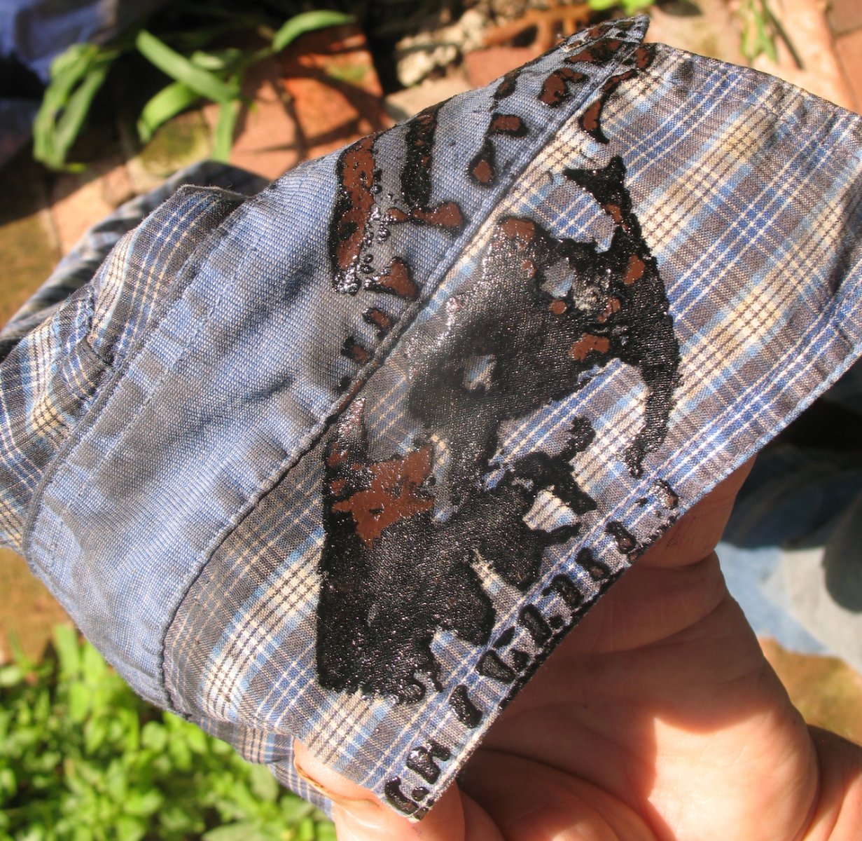

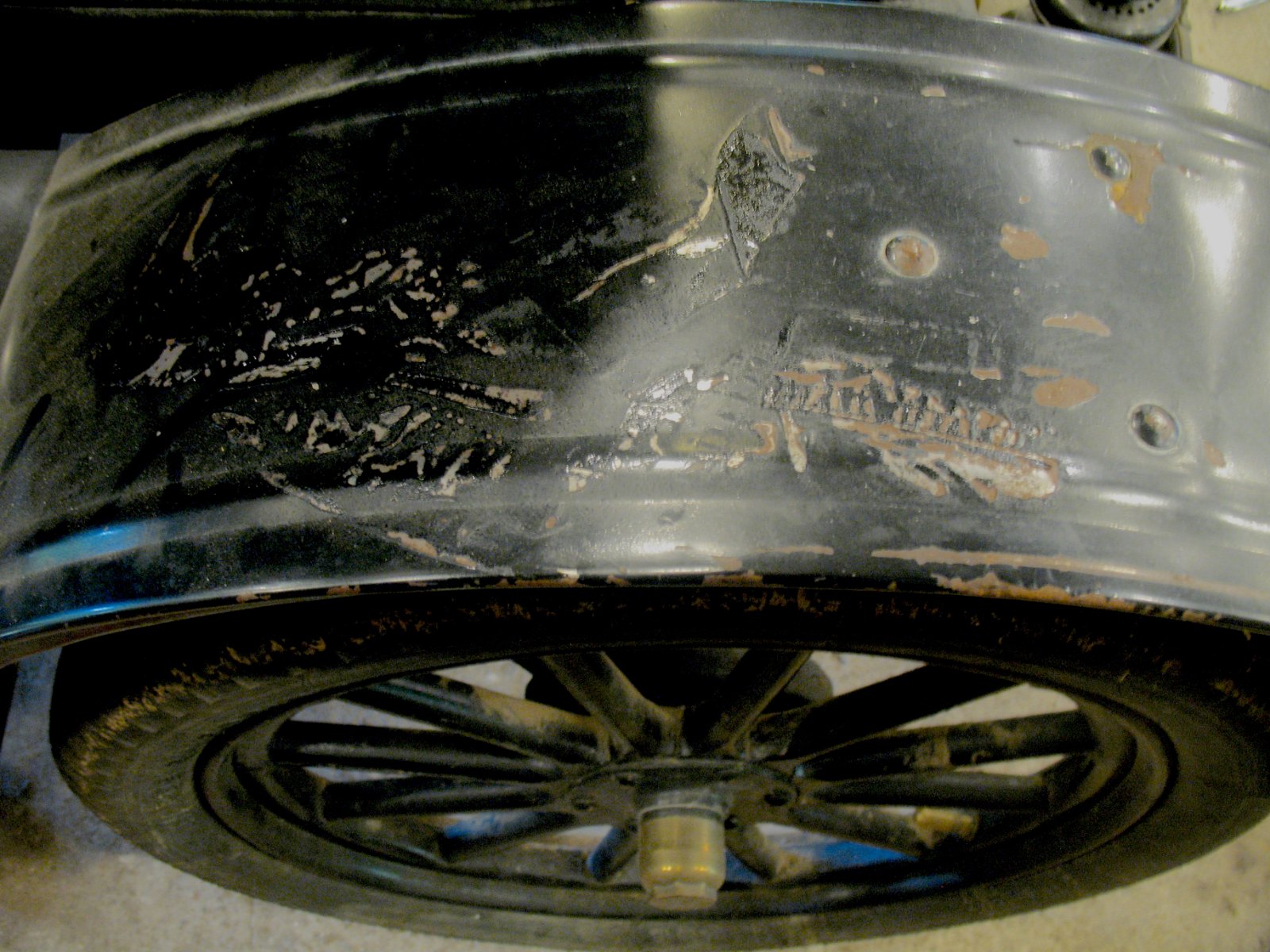

I laid a sweaty shirt on this fender and made the mistake of leaving it there too long.
I got more than just a ring around the collar.

Aerosol shaker can lacquer or professional spray gun lacquer? I would not be surprised if this happened with shaker can lacquer, but I would be very surprised if it happened with professional spray gun lacquer, which is very hard and durable. Are you absolutely sure it is lacquer and not enamel and is it possible the shirt had some lacquer thinner on it? Jim Patrick

Are you absolutely sure it is lacquer and not enamel...
Pretty sure. It's soluble in lacquer thinner. I have no clue what kind. It was done decades before I got the car.

It could be enamel. Enamel and lacquer are both softened by lacquer thinner. Jim Patrick

Not sure exactly what paint may have been used on Steve's T but if the T was left out in the sun on a hot day ( was it Steve?) and the paint is Acrylic Lacquer, what has happened is the lacquer has softened from the heat becoming so soft it has glued into the shirt fabric. Using heat is the normal test to determine if the lacquer is Nitro Cellulose Lacquer or Acrylic Lacquer. To test for Acrylic a painter used to strike a match, blow it out and immediately place the match head onto the lacquer if it stuck onto the paint it was acrylic,( in a place suitable and non damaging to the main paint area). No sticking it was NC lacquer. I would bet this is an Acrylic Lacquer from PPG which came to Australia and was very prone to such problems when used in the 1960/70's. Here it was called Duracryl. Lacquers can be dissolved with a solvent and if let dry again will revert to solid, enamel will be softened BUT it destroys the paint film ( good method to strip it off)

Cured Lacquer will melt with lacquer thinner, cured Enamel will bubble up.
