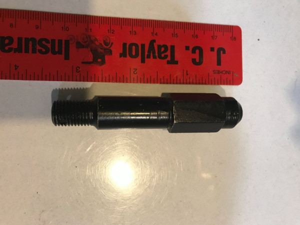

Post by DontKnowMuch » Sun Aug 16, 2020 11:54 am

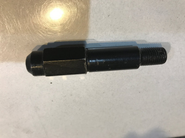

I got this with some other speedometer parts but have not figured out what it is. I have looked through Russ Furstnow's speedometer book but did not find it.
(Sorry that the first picture is upside down.)
Is it part of a clamp bracket for mounting a swivel at the wheel?
Thanks for any help you can provide.

Most, if not all Stewart speedometer parts had their script imprinted from what I've seen & I'm pretty familiar with Stewart pieces - Russ F. will be able to identify IF it's a speedo piece.
Posts: 5432
Re: What Is This Part?
Post by RajoRacer » Sun Aug 16, 2020 12:57 pm
Does the opposite end of the male threaded end have internal threads ?

It looks familiar to me, I am thinking it MIGHT be an early Model A King Pin locking bolt. They are different from the later ones (these early pieces are known as "AR" parts from the Ford replacement parts IDs)
BUT this is just a guess from fuzzy memories!

It's not a speedometer part. Russ Furstnow

Post by Mark Gregush » Sun Aug 16, 2020 4:58 pm
I think David is on the right track. Could be AA truck.

Early Model A Kingpin retainer.

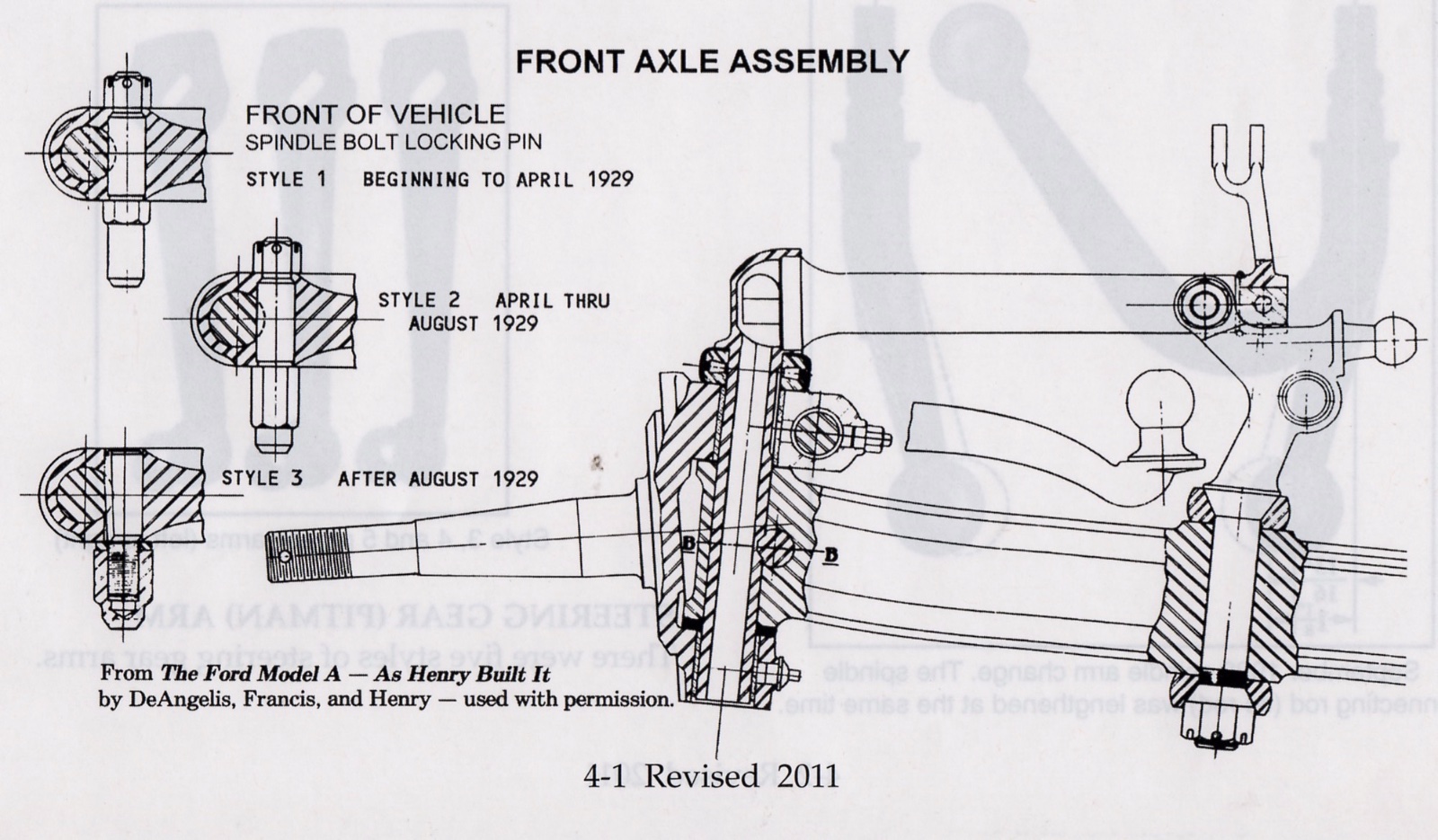

Later Model A

Post by John Page » Mon Aug 17, 2020 12:37 am
Describes all year models.

Ah, there's the documentation needed. So it is "type 2" used in '29 until August--didn't realize it was used that late.
Thanks for solving it!
