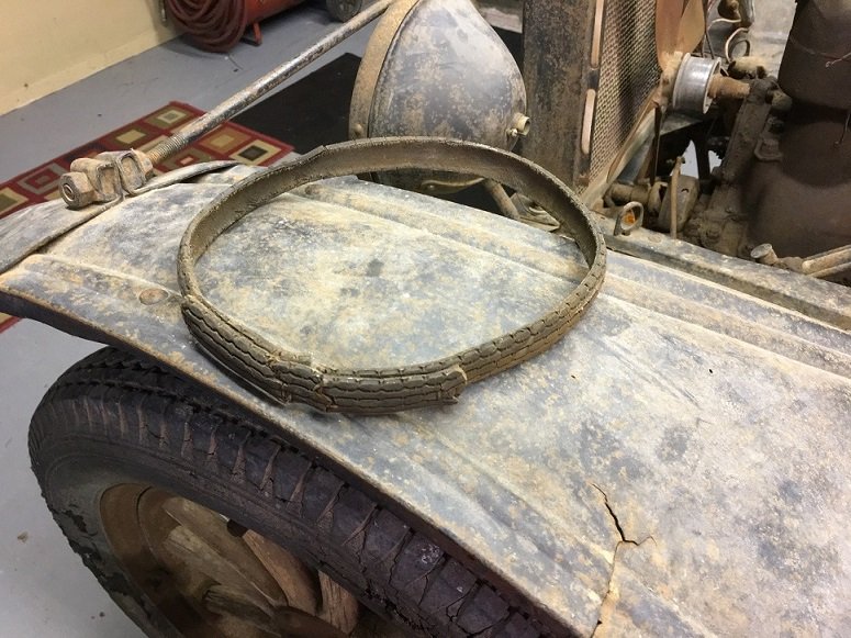

Your "pristine" replacement belt is downright luxurious compared to the belt that was on my car when it was pulled out of the hay shed. It's a bicyle tire, stapled together.
I'm a big fan of your Rusty....he looks great in his work clothes. Glad he wasn't harmed in the overheating.
