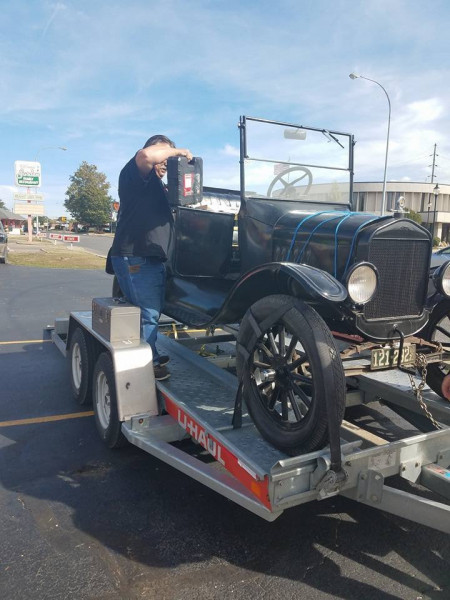

I have hauled my 23 Roadster using a UHAUL flat trailer. Towed like a dream. I like the built in tire takedown baskets and self contained ramps. I used one to bring home a "modern" car once. They have drop down fenders for ease of entry and exit out of the doors on a modern vehicle.
T on trailer
T on trailer

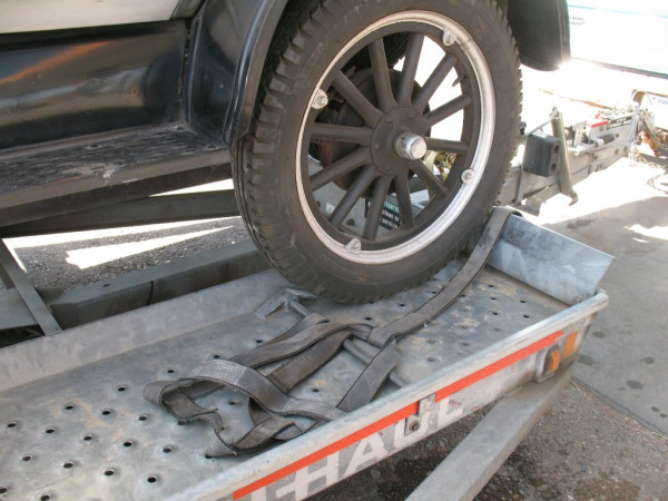

I have done it and it worked well. Like everyone says the though, the front wheel "net" straps do not hold well and need to be re tightened periodically. Instead of relying on them I recommend strapping the front and rear axles with come along tie downs.

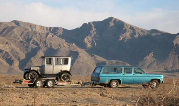

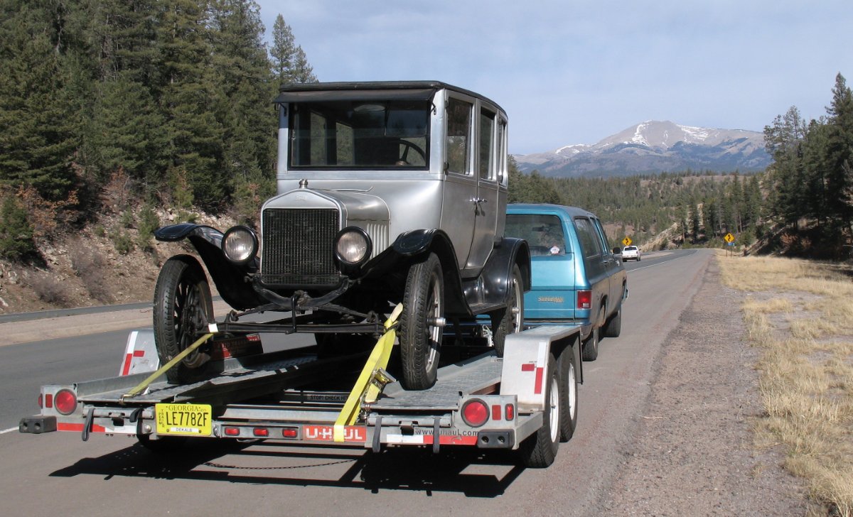

Yes, I have done it. I agree, don't depend on the wheel straps. They wouldn't stay on. I had no other problems.
I have since learned that straps should not pull forward on the front axle. Fortunately I didn't learn that the hard way.
They simply would not stay on.

I would agree with Jelf.
Noticed the yellow straps.
Strap it down like it is on a utility trailer. Cross strap it at the wheels and axle strap back to front.
