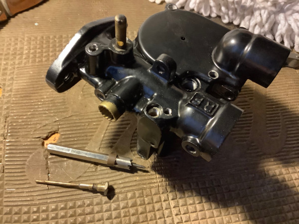

Tim, the RFs are great carbs, I just wish they hadn't used crappy Aluminum to make them. The brass welds to the Al and they can be impossible to get apart.
I try not to work on them but if I do I pretty much just mill the idle jet out and make a new one instead of wasting time trying to unscrew it if it doesn't come right out.

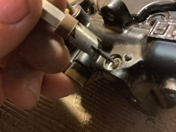

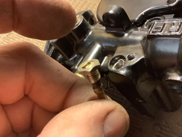

That would sure work. The threaded insert at the top of the idle jet is all that sticks in the aluminum. I just mill it out with a quarter inch mill bit, enlarge the hole with a stepped mill cutter to 5/16 tap drill size down through the threaded area, thread it, whip up a new threaded idle jet upper and solder the old tube into the new insert. Much faster than fooling around trying to remove that idle jet if it is stuck.
Probably a half hour deal to do it this way.

BTW, the threads are 1/4 x 32, good investment working on carbs.

Thanks Stan, I thought the thread was just a bit off. 1/4-28 cleaned it up nice With no damage but next time I’ll do it with the right thread. Thanks for that info. I’ve alway got a kick out the special threads on some of these old things. My theory is it eliminated parts and/or tooling going home in workers pockets.
