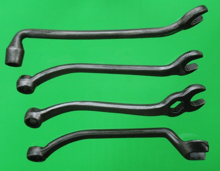

Re: I am 14 and I bought a 1926 T. Now what?...
Congratulations! Hopefully the engine in your car is fine and you won't have to use those extra engines any time soon.
http://dauntlessgeezer.com/DG52.html

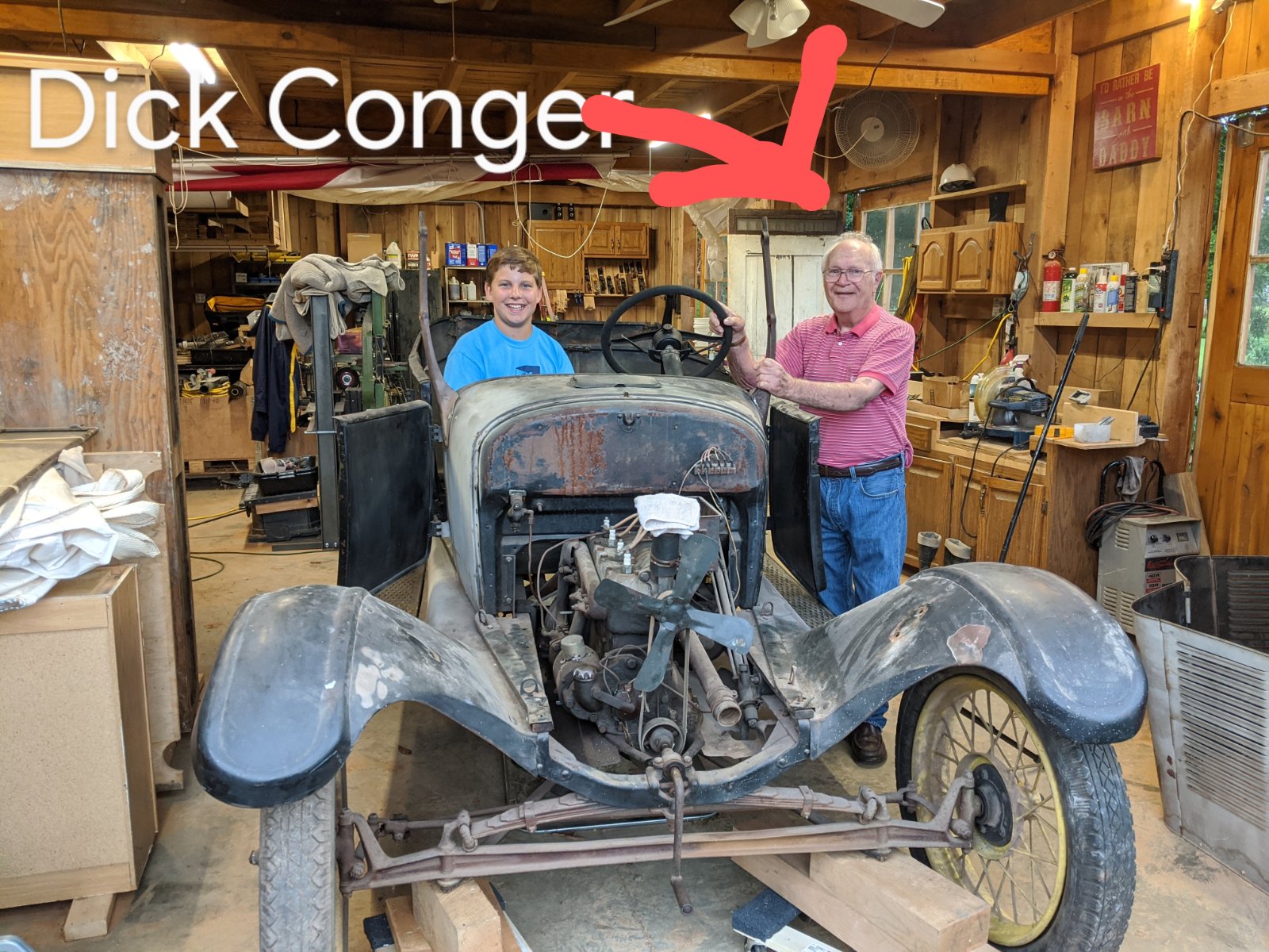

Jonah, Glad to see you are posting on the Forum, when I talked to you a couple of weeks ago you seem very enthusiastic about your T. All I can say is Try to maintain that level of love for this hobby and you will certainly turn it into a lifetime of good times and fellowship. And as far as what's next, I see you are already looking for clubs near you that is a very good start and if you have a question about anything in particular ask away. Did the tires help you out? Jim Riedy

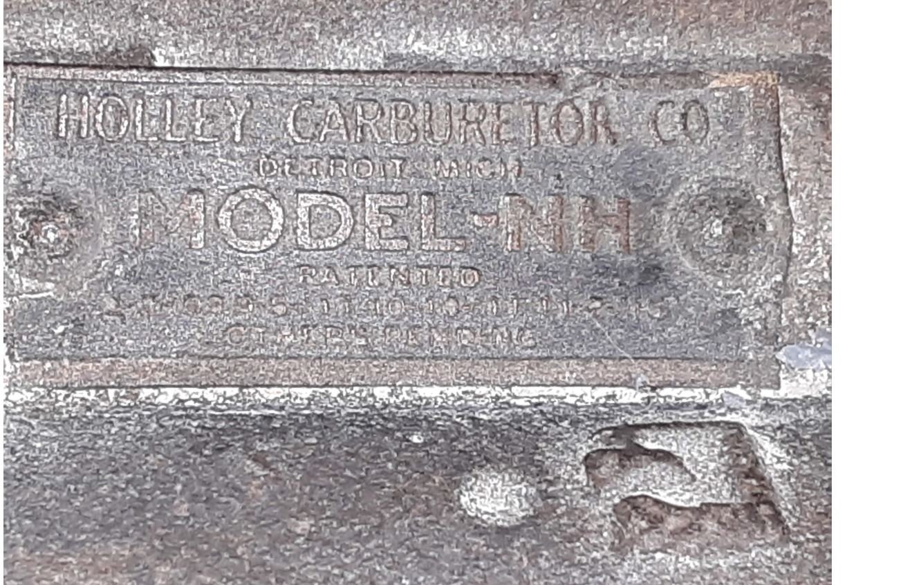

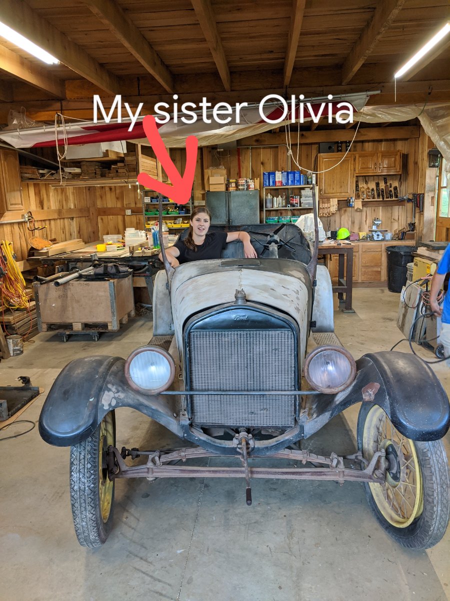

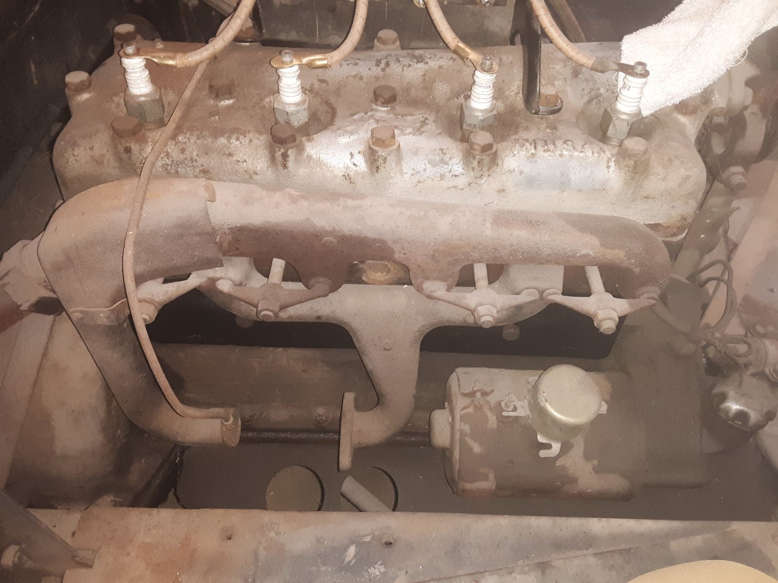

Here are some picture.

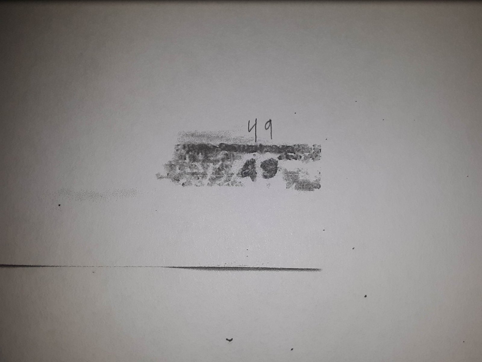

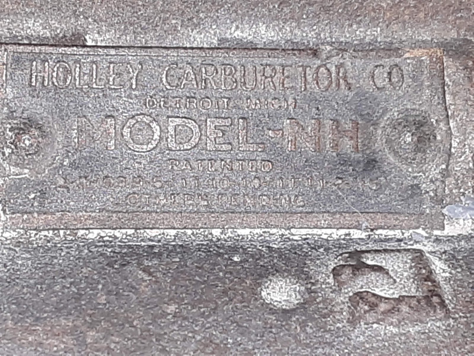

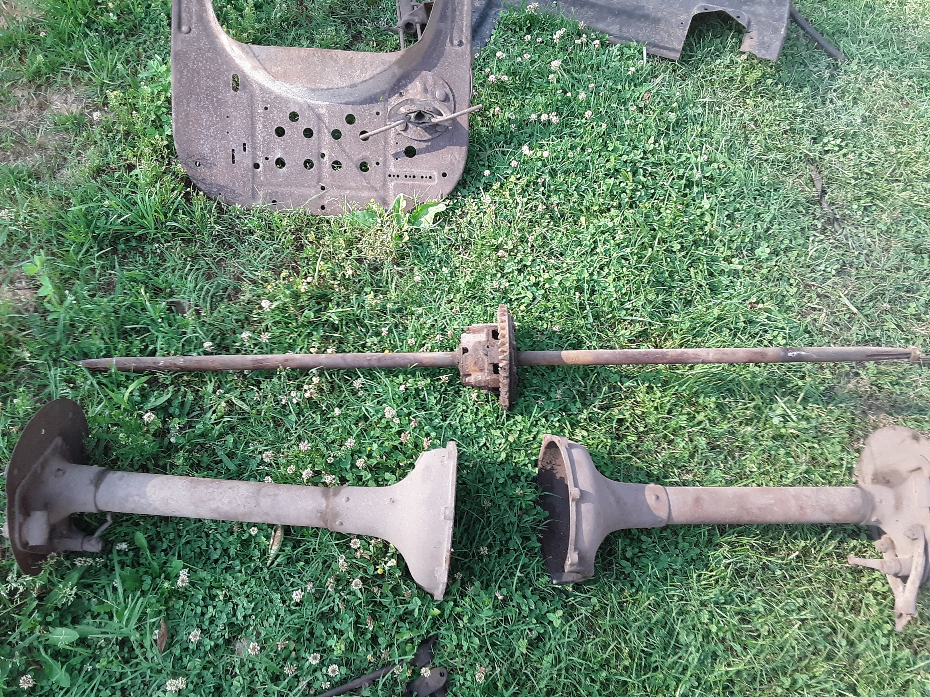

More pictures

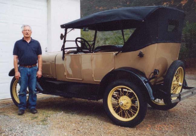

Well, I did some math, and I was 14 when I started working on my Model A. Now I'm a little unusual in that I had to put the car back together, as my Brothers had taken it apart, and it took a while. I started on the car in 8th grade and was able to drive it to my High School graduation (not finished, but street legal and running!) in 1971. I still have that car, in fact I'm basically the second owner, the original owner died when I was a year old and the car sat on the resort property until my Brothers started working on it when I was only 9 years old.
This is not the usual way to get into the hobby, and many would loose interest way before the car gets finished. I finished the car in 1974, to give you an idea of how long a time it can sometimes take! Come to think of it, my first Model T isn't done, and I've had it some 20 years now! Of course, other model Ts came along and it was put on the "back burner" (my first T was a completely disassembled project that had been abandoned around 1961, so nothing like yours--mine was (and still somewhat is) a pile of parts). My last T purchase was Barney, and he was intact, and I was able to get him running in a day. That's the kind of T to find! (however, the body wood is dry-rotted, so I have that project to do now).
So, you are starting at the right time in your life if you want to have a life-time hobby with lots of great memories, and wonderful folks to be around.

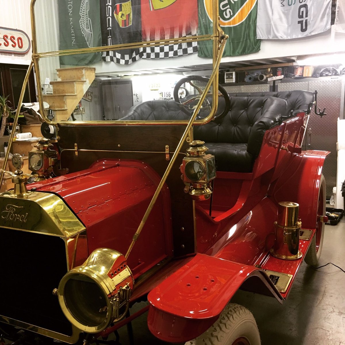

Johan,
You have a very cool car, find a place to drive it like a big field or farm place... And please just following this advice... I was close to gave-up on my 1911 restoration after 10 years of work on it and 4 years without driving any T was a very difficult experience for me.

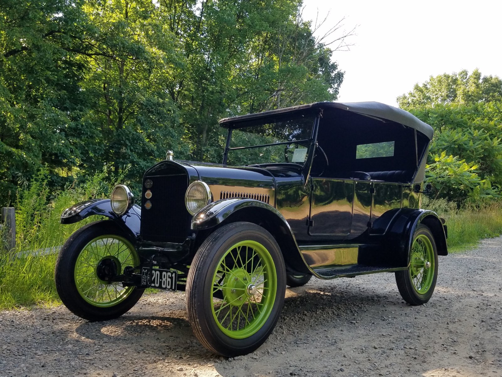

Here my car nowCudaMan wrote: ↑Tue Aug 18, 2020 5:31 pmOne suggestion - if the car runs, try to keep it in running condition while you're working on it to keep your enthusiasm level up.

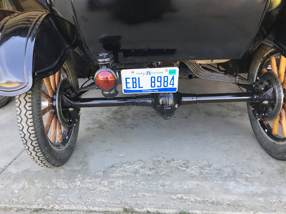

Great to know about you getting in Ts.
I installed the brake equalizer on my 1927 roadster pickup and really like the way they work.
I wrote an article about them in the December 2019 newsletter for the Tennessee Ts.
https://tennesseets.weebly.com/newsletters.html
Phillip
Phillip

It is a system that uses the brake pedal (with an extension welded on) to use both the transmission brake and the rear drum brakes at the same time. You still use the parking brake lever as normal.

interesting

Does anyone have auxiliary brakes that will fit a large drum. I have an abundance of parts to trade if you would accept a trade.

Do you know what colors the body could be if the tires are straw colored? On a 1926
Mark Nunn
- Posts: 1288
- Last Name: Nunn
- Location: Bennington, NE
Factory-installed wire wheels were black. Dealers would exchange them for wheels of other colors to suit customer preferences. You have a the opportunity to paint your car any color combination that you like since there was no standard combination.

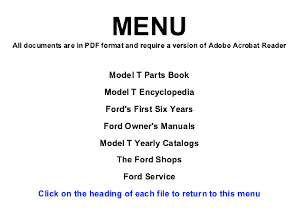

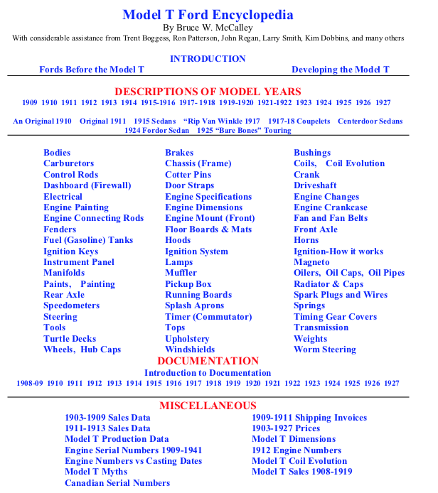

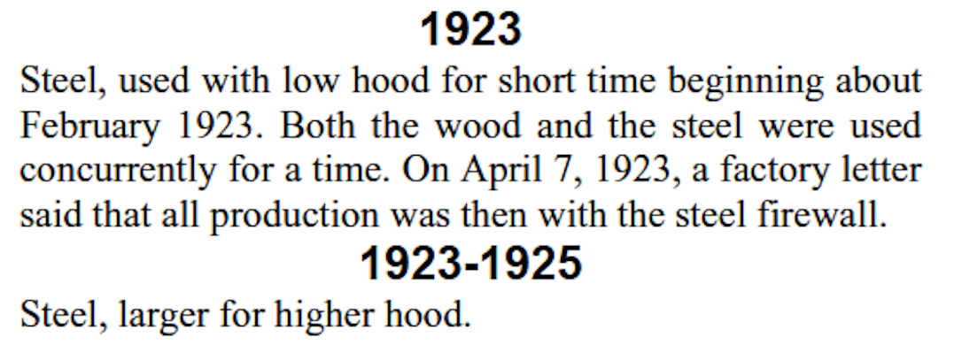

These pages are from Bruce McCalley's Model T Encyclopedia. The disk version is the best fifty bucks you can send on your Model T.

Thanks, were do I buy it?

I believe you can order the disk from Barbara McCalley, the Gourmet Lizzie:
Barb McCalley
308 Cottingham Court
Allison Park, PA 15101 gourmetbarb2@verizon.net

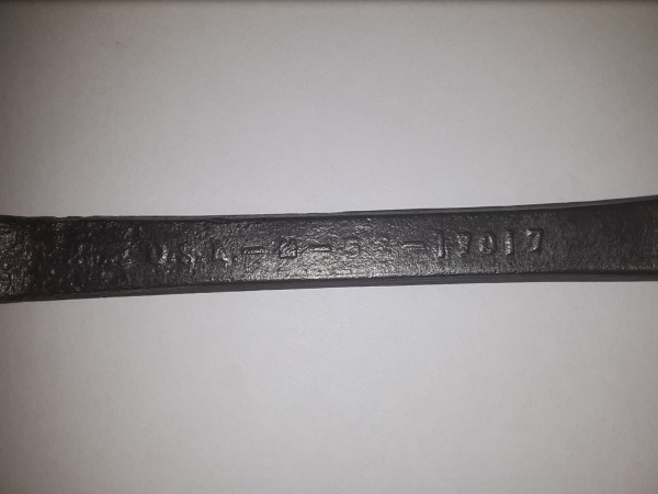

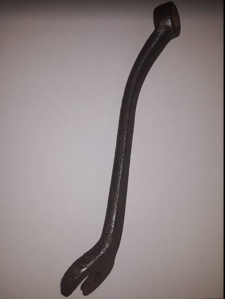

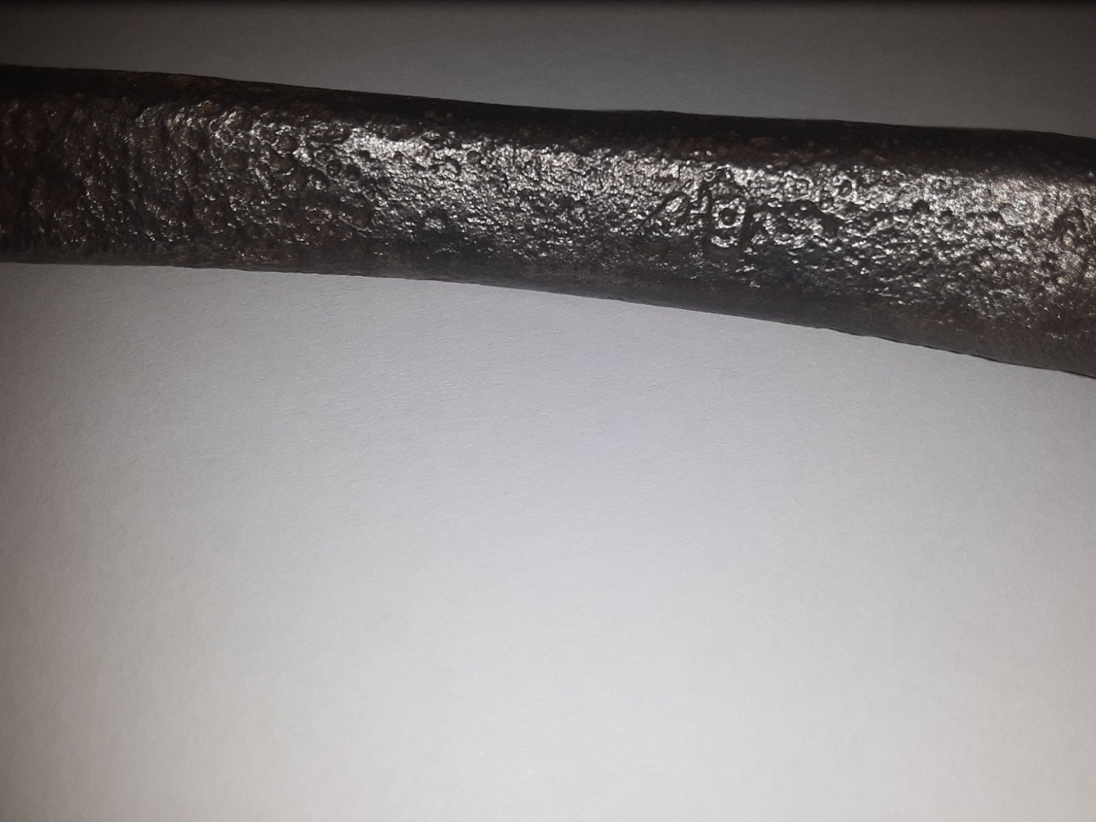

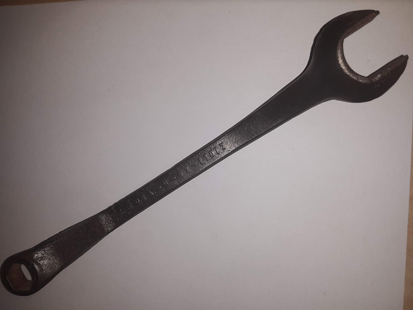

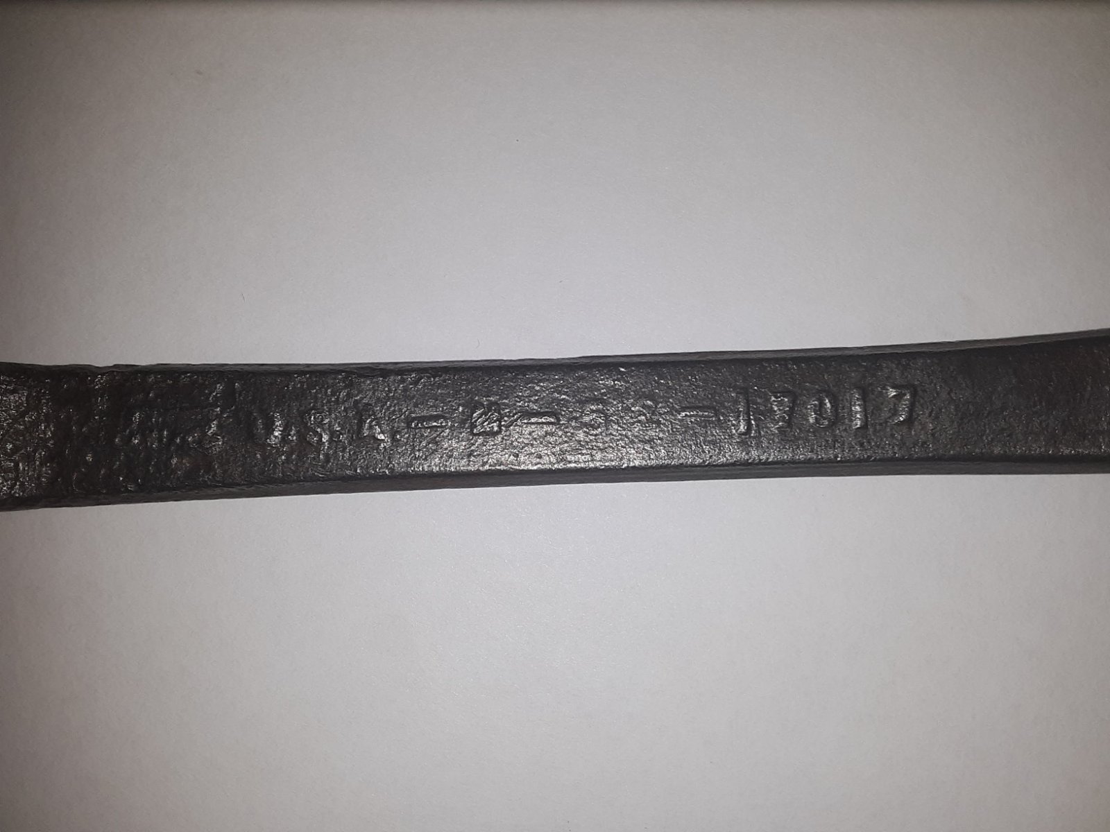

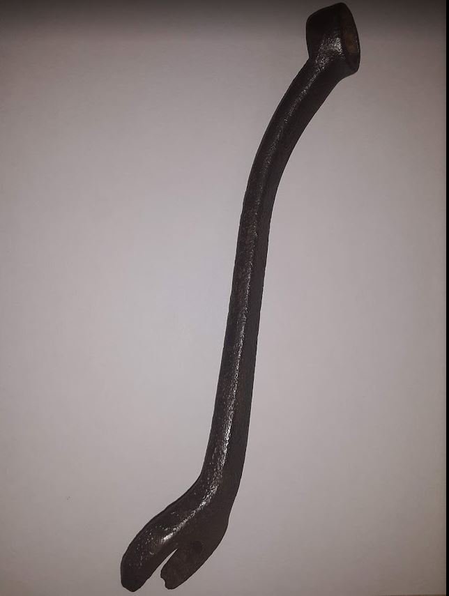

When I bought my T, it came with an abundance of parts. I found in the boxes, two old wrenches. I was wondering if anyone knew anything about them. I am sending pictures with crayon rubbings of the letters and numbers on them.

wrench pictures

wrench picture

sorry, picture not sending I think this will send

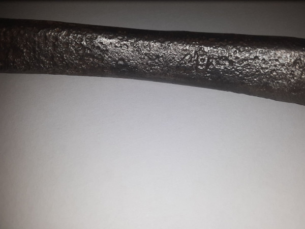

the other wrench

The other wrench pictures

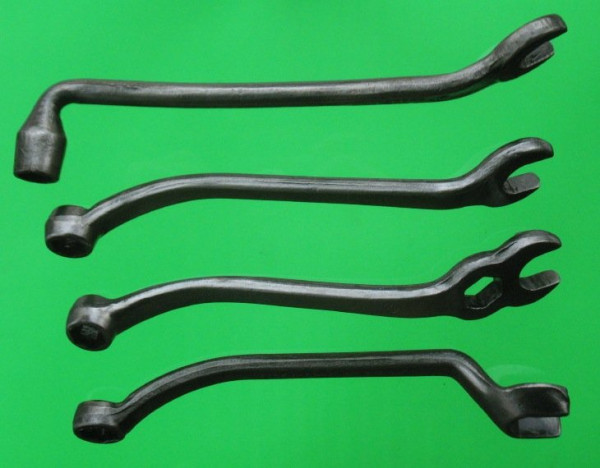

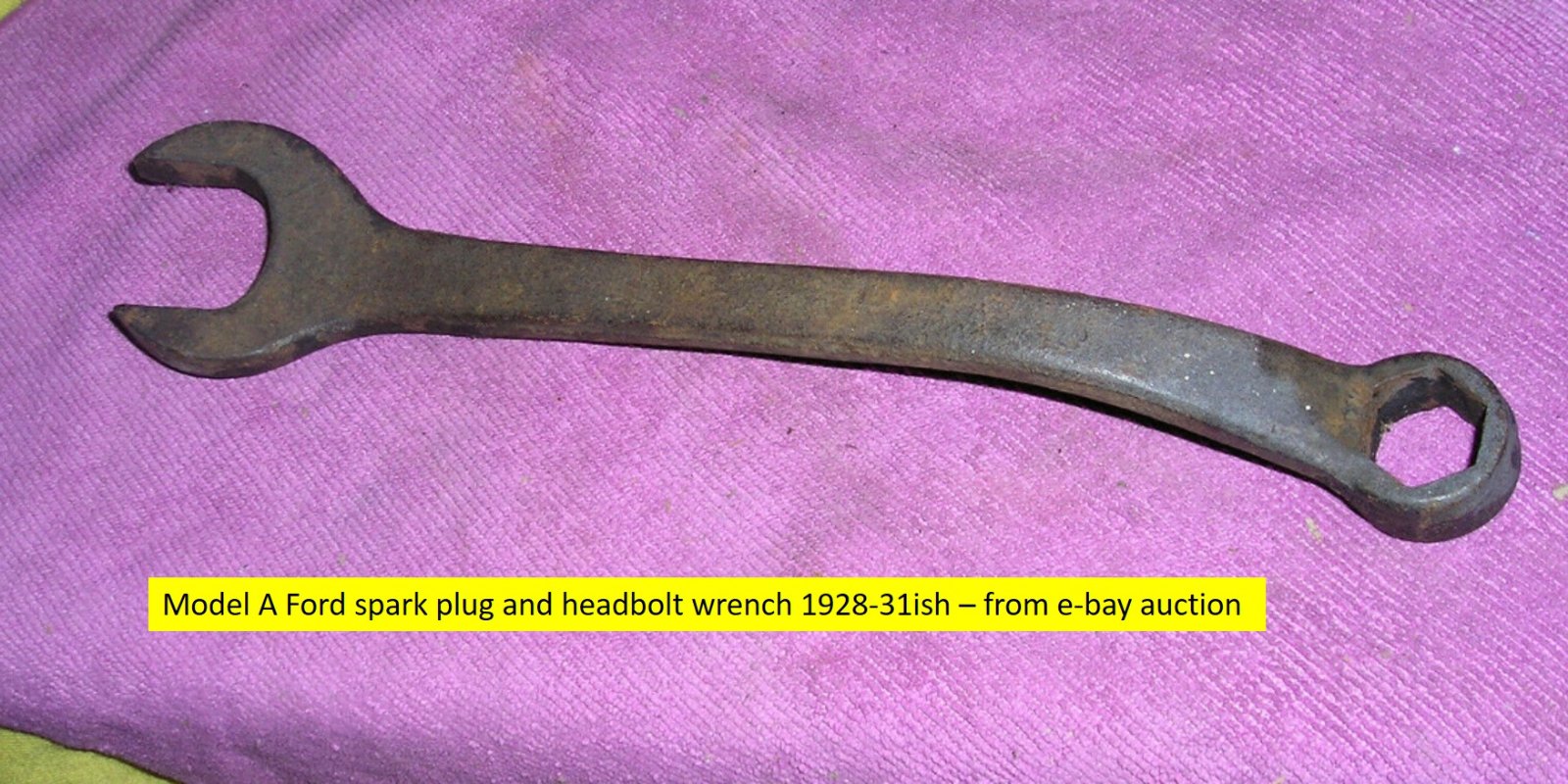

Jonah,
At Steve Jelf's posting at: http://www.mtfca.com/discus/messages/82 ... 1529247932 he has the following picture and information:
and he said: [Spark plug wrench] "At the top is the teens wrench. Second is the version used from 1920 to the end of Model T production. Third is the TT version. The fourth is a Ford V-8 wrench.
The #2335 in both teens and twenties versions is one of the most plentiful Ford wrenches. The last time I bought one at a swap meet I paid $2 for it. "
Note I cannot tell from your photo, but the Model A head bolt and spark plug wrench has a wider opening for the wider 1928-1931 Champion Model A Ford spark plug that the Model T spark plug opening. A photo of one of those from an e-bay listing is shown below:
Additional info: http://www.mtfca.com/discus/messages/33 ... 1361147232
Respectfully submitted,
Hap l9l5 cut off

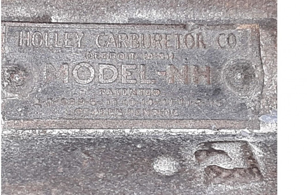

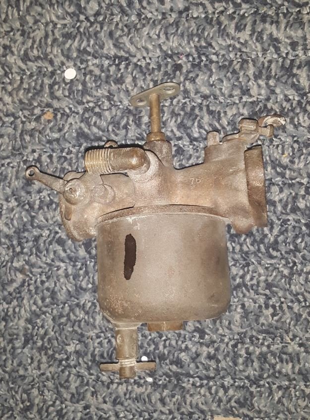

How much do you think this could sell for? it has been sitting for about twenty years, but the valves move freely and it has little rust.
FordFool
- Posts: 168
- Joined: Mon Jan 28, 2019 4:49 pm
- First Name: Don
- Last Name: Kirtley
- * REQUIRED* Type and Year of Model Ts owned: 13 and 16 touring, 18 and 20 coup, 20 tudor
- Location: Devore, CA
- Board Member Since: 2009
Hi. It looks like a NH straight thru. Rebuild it and put it on your car. Don

Ok, should I buy new butterfly valves and needle valves?
Jonah D'Avella
Topic author - Posts: 700
- Joined: Mon Jul 27, 2020 8:00 am
- First Name: Jonah
- Last Name: D'Avella
- Location: Kingsport TN
The rebuild kit is almost as expensive as some of the rebuilt carbs.
- Posts: 4694
That carburetor is incorrect for a 26. It would take more than a rebuild kit to adapt it to fit. The adjustment needle is made for an earlier car. You need a swivel to fit the choke/adjustment knob for a 26. Unless you are having trouble with the existing carburetor, you can just put that one back o the shelf or sell it. Look for things which really need to be fixed and work on those first.
Jonah D'Avella
- First Name: Jonah
Really? this was the carb i found on the car.
Jonah D'Avella
- First Name: Jonah
The previous owner didn't restore it but did get It running. Mabey he adapted it to fit.

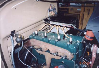

I don't know whether you can see this, but this how your carburetor should look with the right needle and swivel. I think you can order one like this from the suppliers, if not, one will probably come up at a swap meet. Look for a needle which is tapered and does not have a groove worn in it. That needle will fit this carburetor. Or a rebuilt one for a 26 can be bought and most likely this one can be used as a core.

Could you show us a picture of the engine where the carb goes? It might fit. You only need to $1.95 gasket kit to rebuild it unless the needle is bad. That's only $20. You can make it work without needing the swivel for that year. I rarely adjust my carb.

It did fit when I took it out.

Engine pictures.
- Posts: 4084

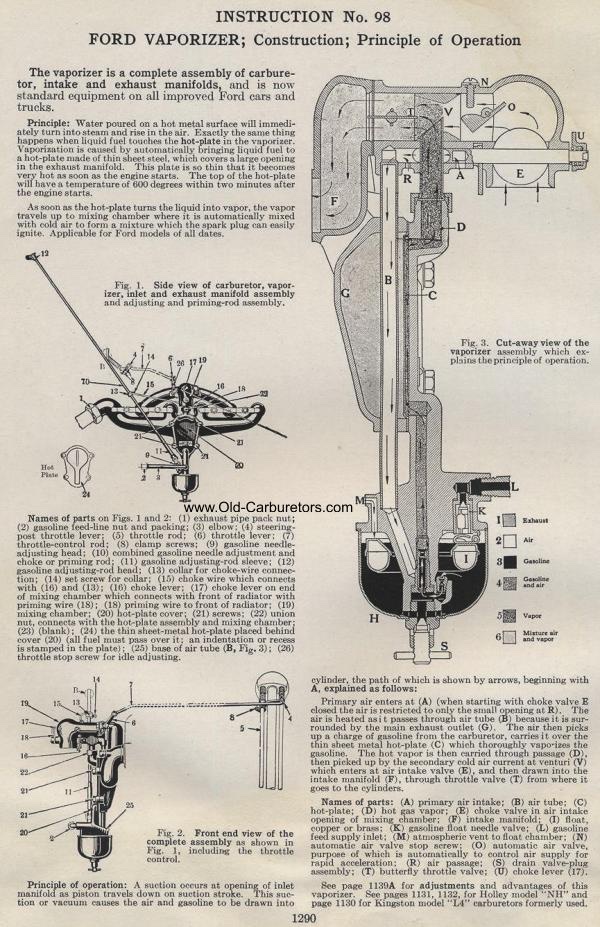

Looks like a mid to late engine, with the straps to the rear of the hogshead. But seems the manifolds have been changed to use that NH carb. Rather common to have the later T's that came equipped with the Vaporizer Carb and manifolds replaced. The long studs are earlier with the early style manifold clamps standing outboard.
This engine did have the Vaporizer originally, as the throttle rod is hanging over the rear of the cylinder head, that rod goes to the steering column throttle shaft.

Jonah is your carb a straight thru or a swayback. You can tell by looking thru the carb. If it’s a full circle it’s a straight through.. If it looks oval it’s a sway back. The straight thru gives a little better performance if it’s set up right. Don

Does a vaporizer carb work better? If so, I have two or three of them. Also, I believe when you look through the carburetor it is round.

I would use the NH on two of my cars. They are good carbs. I think they give a little power than the swayback’s. IMO. DON

Why did ford use vaporisor plates?
- Posts: 4084
Heated the fuel for better atomization, improved gas milage for economy.
- Attachments
- 27 brochure engine closeup.jpg (36.64 KiB) Viewed 20873 times

Jonah, looks like you already have local T friends, Dick can introduce you to more locally and maybe get you over to Elizabethton to see the Terry shop. There are lots of model T folks around you and even more down here in the Knoxville area. One of the most important things you can do is build a library of T books starting with the service bulletins, repair manual and aftermarket repair manuals from the clubs.

- Posts: 7411
What Jim said. In looking at previous posts I see I recommended the Encyclopedia but neglected to post this: http://dauntlessgeezer.com/DG80.html.

Jonah D'Avella
- First Name: Jonah
- Posts: 7411
A mixture of parts. 23-25 firewall, 26-27 axle housings.
ivaldes1
- Posts: 960
- Joined: Mon Jan 07, 2019 1:32 am
- First Name: Ignacio
- Last Name: Valdes
- Location: Houston, Tx
Ok a fair amount of rust but otherwise ok. You can brush the insides with kerosene to get any grease out. Use a cheap round toilet brush from the home store tie a string on it and run it through the tubes with kerosene on it. Any lumps on the walls you can get out of the tubes with a piece of pipe. Then get a drill mounted cup type wire brush and buzz all the rust off then send another picture. Do the two axles rotate on the spider gear? When you've cleaned up your crown gear a little look for gouges on the teeth. If it is gouged toss it and get another one.

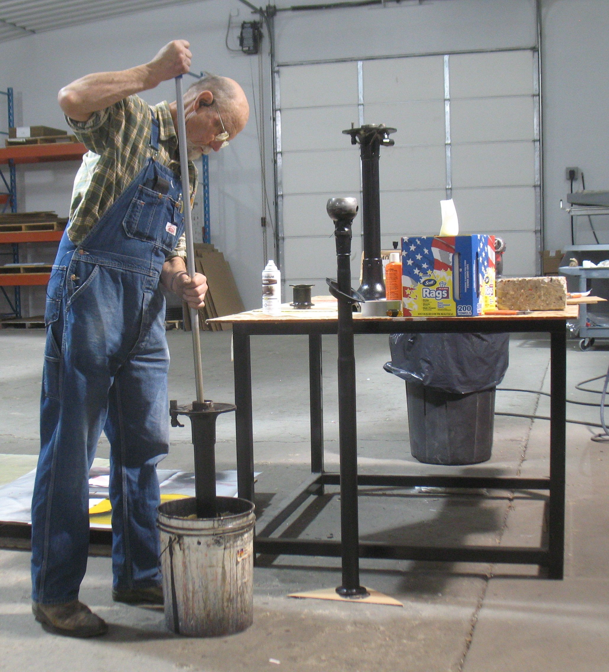

- Posts: 7411
You can brush the insides with kerosene...
...but it's ungodly expensive. Paint thinner costs less, and diesel fuel. I haven't priced Stoddard solvent lately, but even that probably costs less than kerosene.
Brush, broom handle, used paint thinner.

I bow to the thriftiest of all.
Steve Jelf wrote: ↑Tue Oct 06, 2020 10:18 pmYou can brush the insides with kerosene...
Steve, that's a modified low steel firewall making it 22-early 23.

- Posts: 7411
...that's a modified low steel firewall...
Yes, I should have recognized it. I have one.
