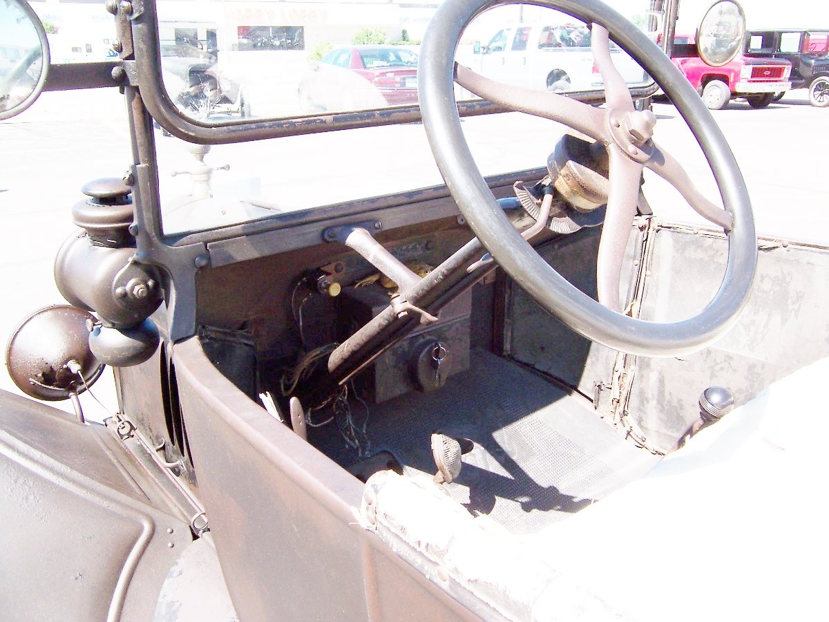

We're these an after market product? If so what weakens to make an owner need one?

Popular accessory for T’s without a metal dash panel factory column clamp. First T’s with those were built about April 1923.
Earlier ones had only 2 point connection for the long steering column, at the frame and at the firewall. Was about sufficient for many owners but some wished for more stable column. Wood firewall was good but the change to thinner metal firewall caused Ford to add the dash panel support too.

Original wood dash with a solid maple core was pretty stout ; replacement plywood can get "mushy" in time especially if the driver likes to grab the wheel to lever himself into the seat. The additional bracket makes the column rigid. Good idea !

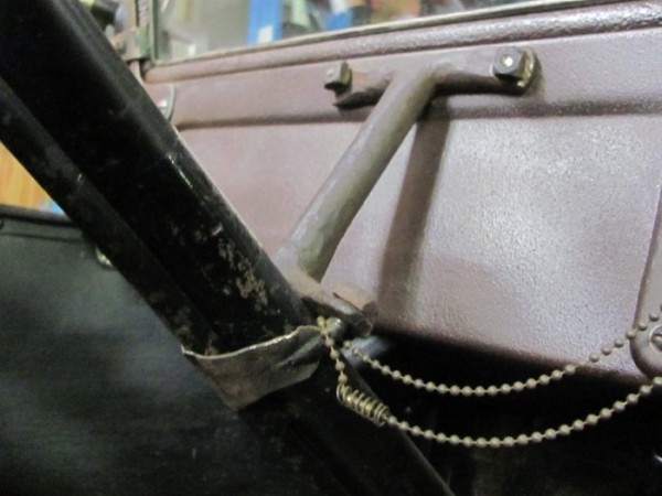

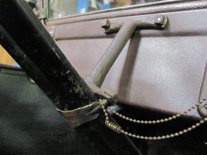

My '23 cutoff came with this farmer made brace, forged in fire with split and added bracket under to wrap to steering column. Ingenious endeavor
