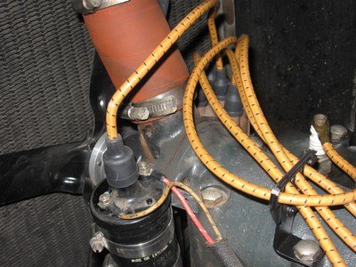

I would seriously consider relocating the coil to the front of the engine, probably to the rh water outlet bolt. I’ll look for a picture of mine.

Made a bracket to mount the coil on the water outlet bolt.
