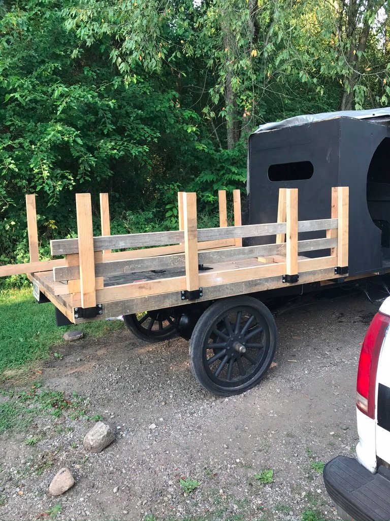

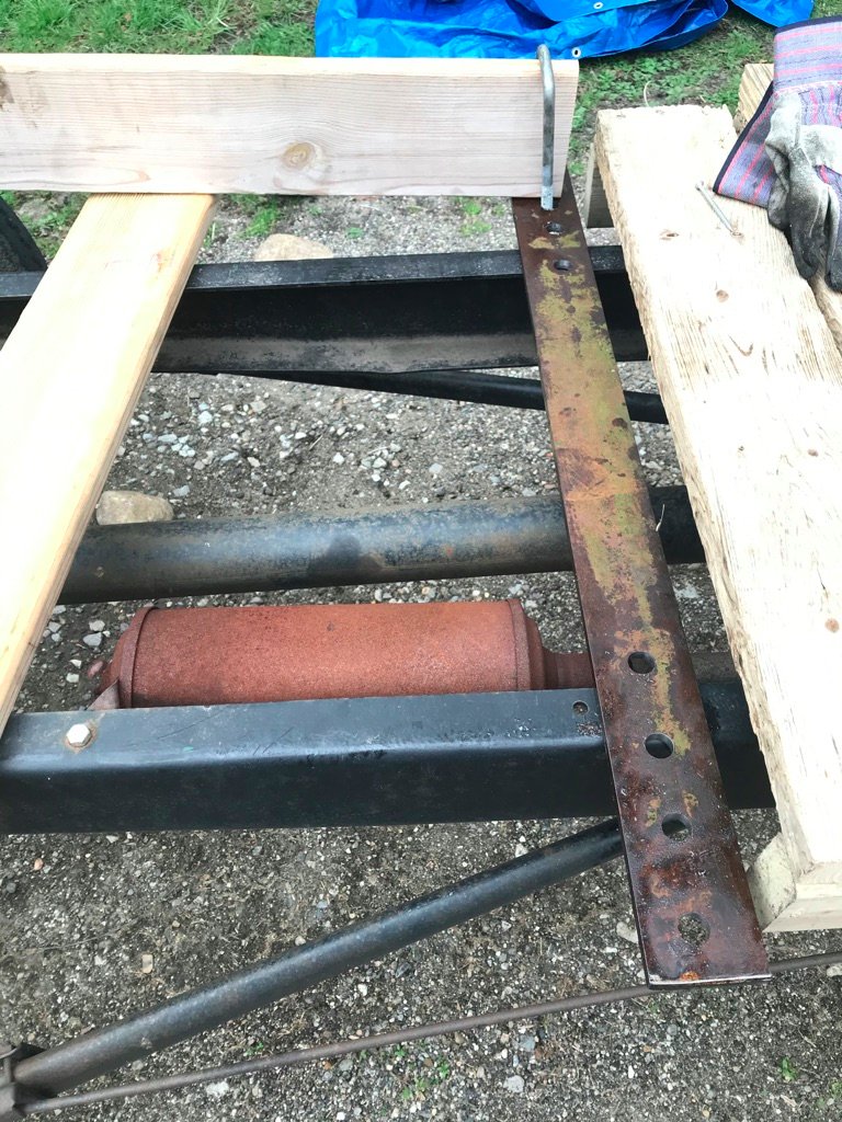

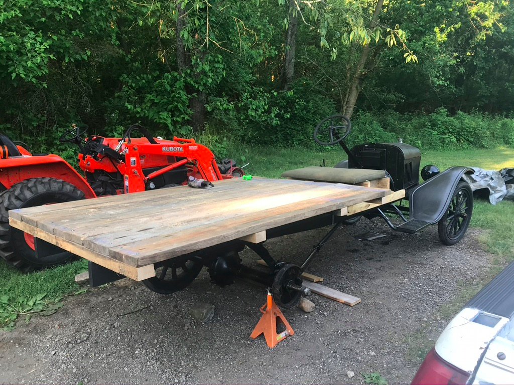

I'm doing one now...
I ran two 8' 2x6 boards on edge the length of the frame, held down with U-bolts. On the front I fabricated a bracket out of bar stock that was U-bolted to the frame and on the rear there where already holes on the frame ears for the U-bolts. I'd used locknuts / locktight as you don't want them to loosen up (ask me how I know).
Then I lag bolted four 3x4 boards across the 2x6s. On top of the 3x4s I lagged in the decking. If I were to do it over, I'd drilled holes and use carriage bolts for the decking, but I'm not changing them.
I ran some boards along the sides, which I lagged the stake pockets to.
