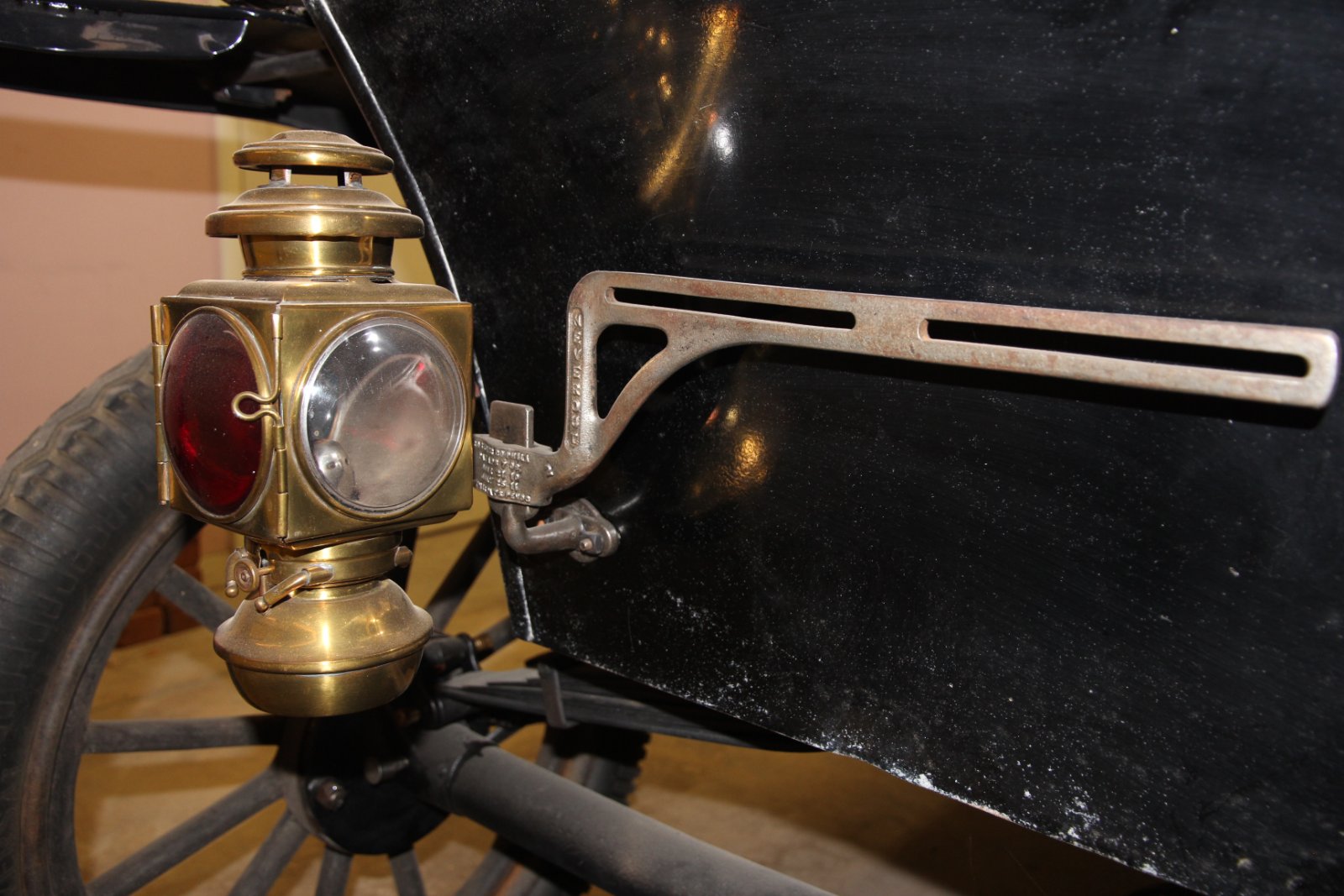

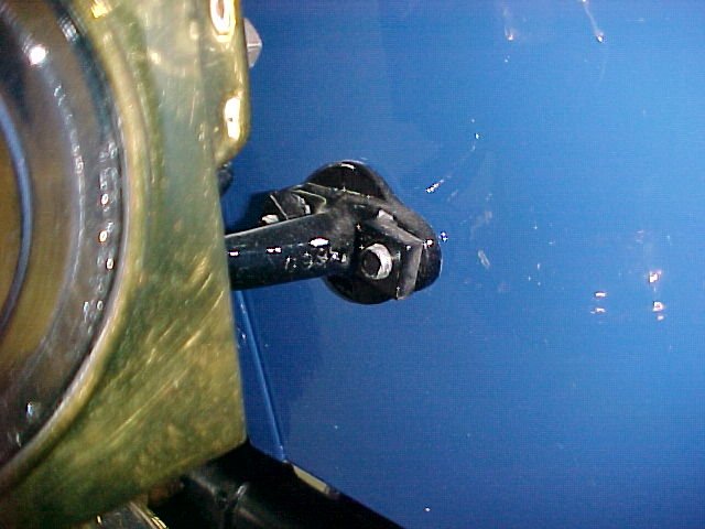

Re: 1911 tail lamp bracket
Post by John Haynes » Mon Aug 24, 2020 5:48 pm
I believe they are carriage bolts with square nuts. I have attached photos of my early 1912 Touring which should be the same as the 1911 touring.

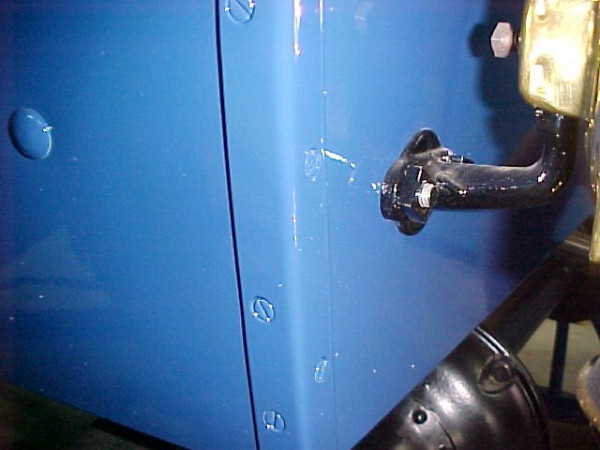

shadetree
Posts: 7
Joined: Sun Jan 06, 2019 6:13 pm
First Name: ward
Last Name: sherwood
Location: High Desert
Post by shadetree » Wed Aug 26, 2020 9:31 am
A picture of an "11 I used to have. The square nuts were on the outside. I don't know if this is factory correct or not.
