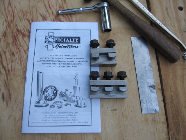

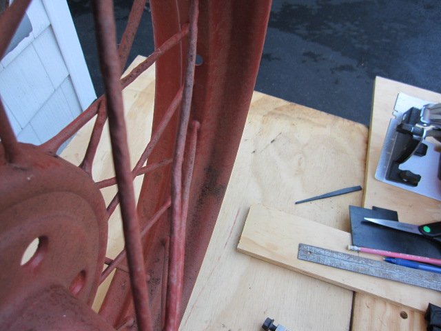

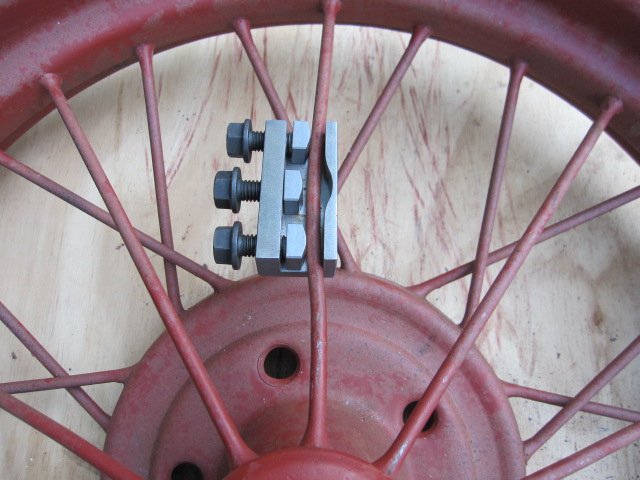

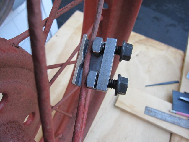

Got the pictured wheel spoke straighteners for a set of new to me wire wheels. Ordered them from Specialty motor cams in Plymouth Wisconsin.
Part # SMC0016T, my four wheels are now straight and ready for powder coating.

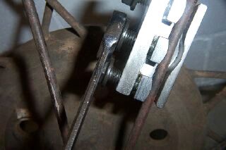

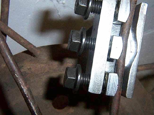

Second on those spoke tools from Stipe, they work. Wavy spokes on a restored and repainted wire wheel shouldn't be there ;)
spoke tool.jpg (22.01 KiB) Viewed 3675 times
