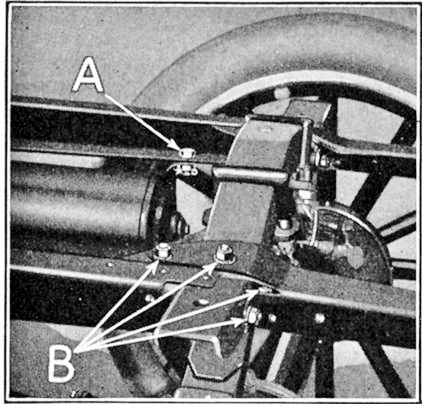

Your aftermarket accessory rim carrier is made for T's 1919 and later that had the frame and rear crossmember drilled for the Ford style carrier.
To use it, holes need to be drilled. The photos may help.
Seems too, that maybe that accessory was modified? There are welds on the ends of each hanger. May have been on a different make of auto.

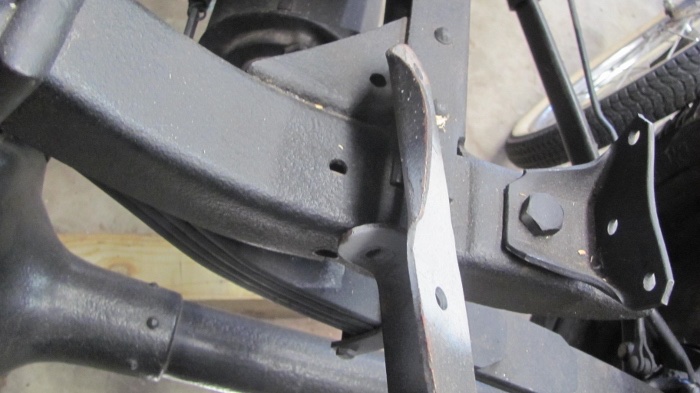

Carriers were made for the pre-'19 frames, that mounted to the underside of the rear spring u-bolts.
Ford carrier:
