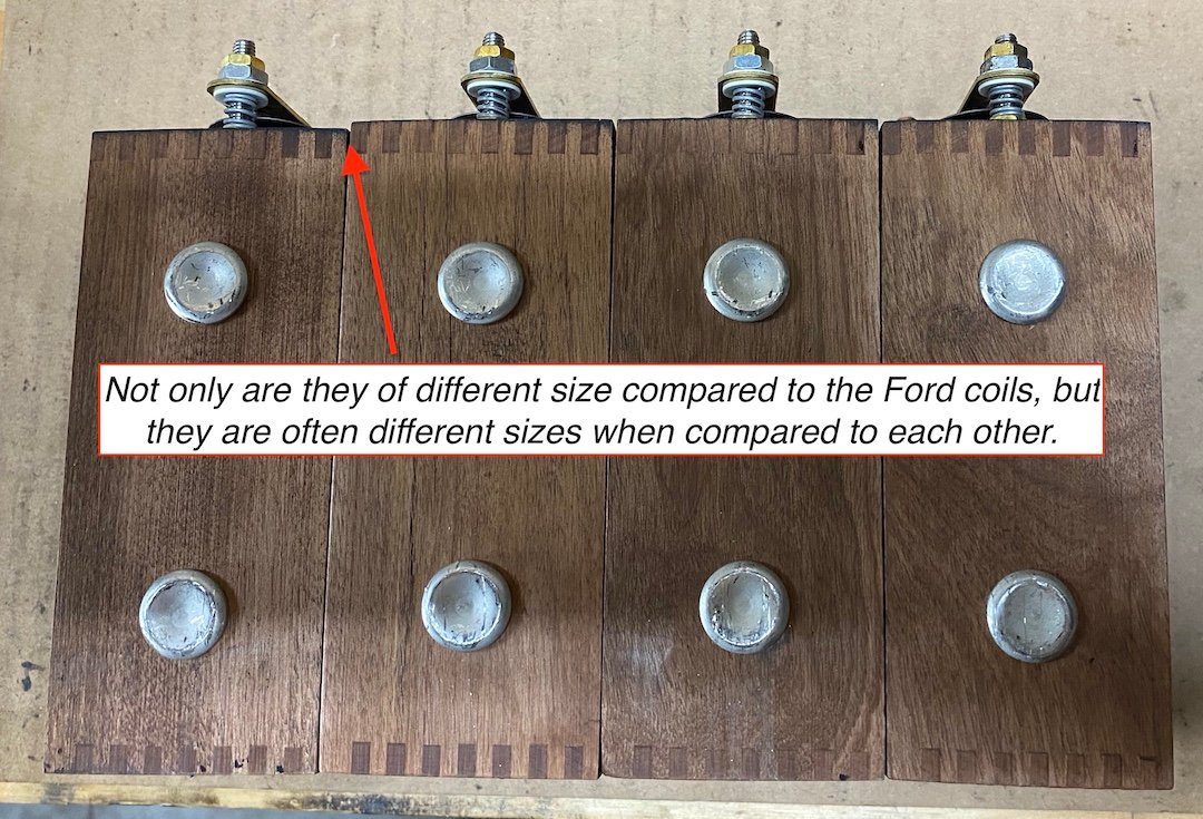

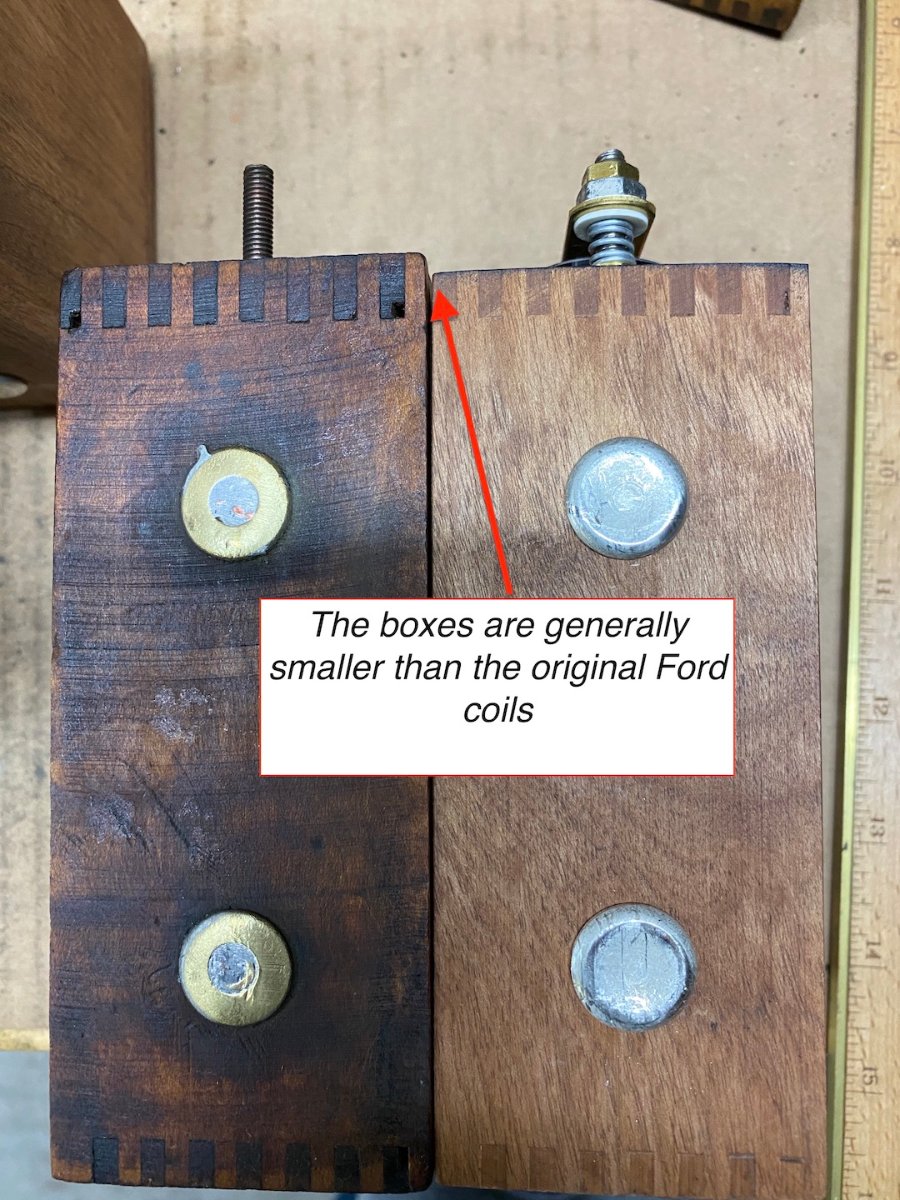

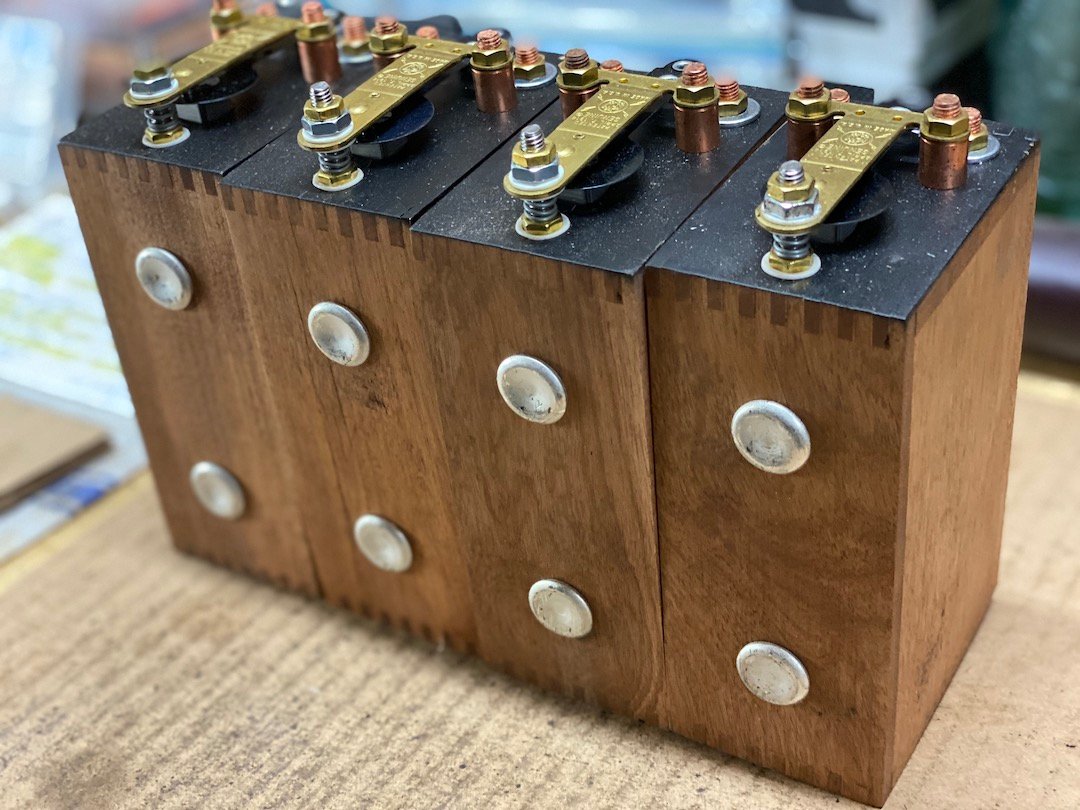

The following pictures and information relate to some of the aftermarket coils sold by at least one of the vendors. You've seen them before. They are easily identifiable. *Note; this observation was made on a brand new set that was never interfered with after arriving in the mail. (Unfortunately, this is not a unique occurrence. I have made this same observation on approximately 50 other coils of the same type.)
Cons;
The boxes are not the same size as the Ford coils. (see pictures) They are often smaller, in every dimension. Shim, shim, shim.

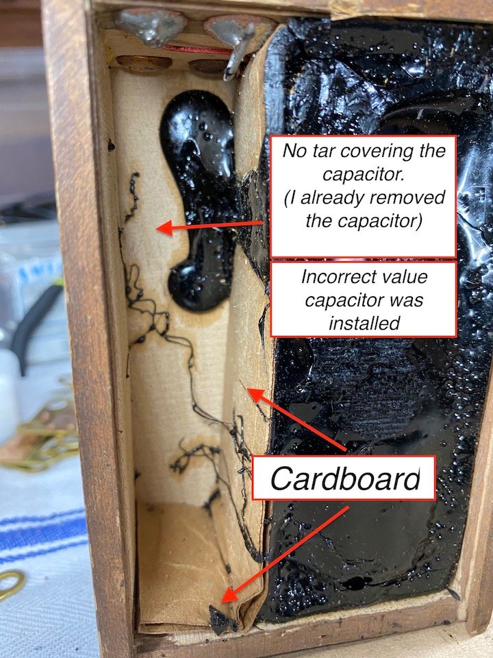

Instead of wood or glass to separate the capacitors from the windings, they use cardboard.
There is often no tar (or very little tar) in the cavity covering the capacitors ... leaving them susceptible to oxidation, corrosion, and vibration.

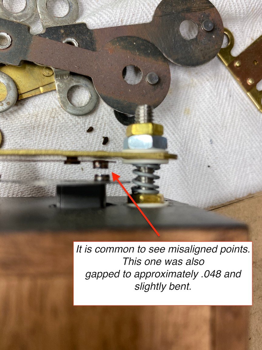

The points are often misaligned with wildly varying point gaps and upper cushion spring gaps.
They are not match-tuned. i.e. They are all drawing different current, resulting in terrible fire-timing. And, one was double-sparking.
They have incorrect value capacitors installed.
Each capacitor I tested in these coils tested differently. And, each one tested out-of-range.

Hmm, funny thing is my buddy has just had to adjust a set Sunday last - the tensions on the bridges was too high so little to no spark. And yes, shim, shim shim.

The first problem was the size of the boxes were not like original Ford coils. That problem has since been corrected, but many of them made with this issue are floating around in Model T owners hands.
The earlier ones also used Metalized Mylar capacitors, which as you pointed out, didn't last very long. That too was corrected (for a while) when another later batch with (incorrect) capacitors was introduced which created another round of bad coils floating around in the hobby.
