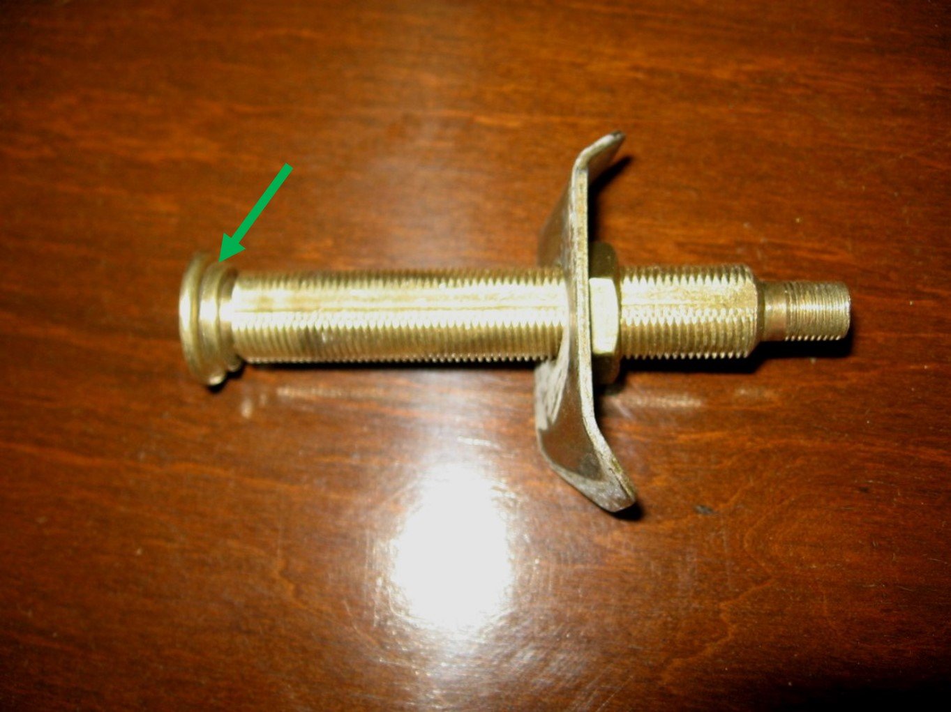

Well Steve, you're right, the base on the vulcanized metal stems is pretty small, see attached pic.
Unfortunately, the knife slipped a bit while I was digging this one out and the tube is ruined.
Now that I know the size hole to shoot for, I can use a gasket hole punch to cut the minimum size hole needed to remove the old stem without risking the surrounding tube material. Hopefully the correct size hole punch will be tall enough to fit over the stem and reach the tube rubber.
I suppose an alternate approach would be to just buy rubber stem tubes to modify and sell my metal stem tubes. Maybe I could get enough money for them to cover the cost of buying new rubber stem tubes.
Update - My gasket hole punches are too short to reach down to the base of the stems, so I'm going to sharpen one end of a 9/16 inch brass tube and use it to cut the rubber around the vulcanized stem.

Another update - the hole left in the tube after removing the too-large 725 size metal stem is larger than the shank of a 777 stem (no surprise). This makes me worry that a 777 stem might not seal the hole perfectly.
So, I have ordered a couple of rubber stem tubes from Universal Tire and will try modifying those for 777 metal stems. I will switch over two tires at a time as I wear tires out, so it may take a while to switch over completely.
