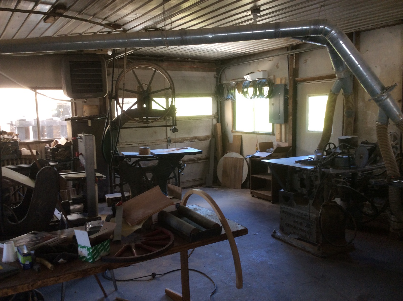

What is procedure for Stutzman?
Topic author - Posts: 2948
- Last Name: Hjortnaes
- Location: Men Falls, WI
Does he prefer that you give him the entire wheel? Not counting the rim of course for a demountable wheel.
Would he prefer just the felloe(metal) and the hub along with one spoke so he knows the size spoke needed?
Will he clean and paint the felloe and hub for you?
Obviously I would clean and degrease it as much as possible before I give it to him.
Payment up front? Cash, Check, or CC?
Thank you.
Thank you.

Re: What is procedure for Stutzman?
Dave, they would take them about any way you send, but don’t expect a primed rim back . Unless your spoke is something unique ( teardrop, etc) they don’t need it. In my many visits there, I’ve seen new wood in whatever people send them.
Here is what I’ve done. Rims and hubs sandblasted. You will want to at least prime the rim. ( epoxy prime, or etching primer) Better yet to powder coat the rim, if it’s a metal felloe. I also powder coat the hubs. I open the hub plate up just a tad so it will slide over the hub without scarring the new powder coat. If paint is where you are heading, then prime these parts but throw some paint on where it will be covered . That will protect from rusting. I always put a scrap of bicycle inner tube over the threads, to protect in handling and shipping.
For wood felloes , same thing. At very least, good primer with some scrap paint where the felloe will cover it up. If not, eventually you will have some nice rust stains showing.
The more prep you do, the quicker the turnaround. I always supply hub bolts, and powder coat the heads, for just regular late wheels.
I can’t speak for Noah, but I don’t believe they are set up to do your metal work, and I wouldn’t want them too. No money up front. Regardless of the service you hire, that’s a really bad idea.
Tim covered it all accurately. The one thing I do (if needed) is if there is any pitting to address on things like the rims or flange plates, I do the initial filler work and give it a light priming before I send it to them. It is much easier to do the sanding with the wheel disassembled so that you don't have spokes and bolt heads to sand around. I also tell them not to peen the hub bolts in the event that I want to pop something apart, and I have a certain way that I like them done and just plain prefer to do it myself. On rear wheels it comes out better to spray the color on the wheel and drum separate and then assemble after it is dry.
Great points, Walt. I generally find hub bolts need to be shortened from how they come back from Stutzman. I don’t think he peened the last set, but I may have asked him not to.
- Posts: 7392

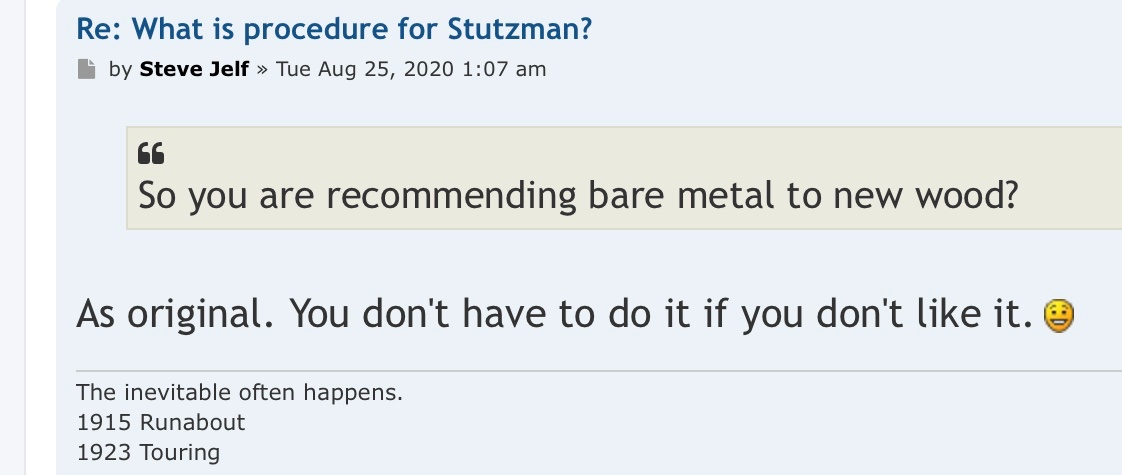

In my case he made up the wheels using just the metal parts I sent him. There was no wood. I blasted and primed all the metal parts except the valve tubes, which he supplied. I have found that priming was a mistake. I should have just blasted and prepped. I found that when mounting tires on the assembled and painted wheels, the inevitable little dings and scrapes left glaring gray spots. I now use only primerless appliance epoxy enamel on wheels. I used it on the wheels I assembled myself eight years ago, and it has held up very well.
Dropacent
- Posts: 3384
- Last Name: Morsher
- Location: Norwalk Ohio
So you are recommending bare metal to new wood?
I had a set of wheels done for my 1912. I was most disappointed in the quality. When I set the wheels up and spun them they were wobbly and the rims were not true to the hub. I sent him cleaned and primed rims and hubs that were as near perfect as possible.
After further investigation he assembled the fellows in the rim fixing them with short Philips head screws and countersunk my rims to allow the screw head to be flush., instead of the original type fasteners that Ford used. I had to weld up the countersunk holes grind down and redrill the correct size holes. I called him and his answer was oh that must have been the new guy sorry. I corrected the poor workmanship and replaced the 1/2" long cheesy Philips screws and no compensation was ever offered.
I now send my wheels to Whitmers in New Holland Pa far better quality and a bit less expensive. I know of another person that sent his wood wheels to Stutzmans these were for a very early brass car. 3 wheels were correct and the 4th wheel did not have the correct amount of spokes. He called and they said to send it back for corrections, same excuse used oh the new guy must have done that wheel. My friend had to pay the freight both ways to fix their screw up. Stutzman offered no compensation for the freight both ways from California to Ohio. I much prefer Whitmers for the above reasons, just a personal preference.
I suggest to be very specific and get it in writing!!!! if you are sending an original wheel take pictures. specify the fellow rim fasteners.

- Posts: 7392
As original. You don't have to do it if you don't like it.
Harold Musolf -- why do you post under this false name of "Dick Dock"? When last we visited this issue:
http://www.mtfca.com/discus/messages/50 ... 1434157037
.... it was established that you farmed out this job through a middle-man and that you had no contact with the actual wheelwright prior to your having received them. Furthermore, you're still complaining about the countersunk flathead screws in your 1912 wheels -- which are correct for 1912 wheels (that change having taken place after about 150,000 were built):
OCT 17 Ford Archives
T291B front wheel assembly. Specifed 3/16" rivets to be used to hold the rim to the felloe, replacing the #10 x 3/4" flat-head wood screws being used. Also specified that the hole for the inner tube valve stem be lined with 9/16" 25 ga. steel tubing to prevent chafing.
http://www.mtfca.com/encyclo/doc12.htm
I have now done at least seven wheel jobs with Stutzman, each time supplying him (not a middle-man) with complete sets of properly prepared hardware and have no complaints. Please don't leave out of the narrative the fact that you weren't managing the job yourself, but rather paying someone else to shuffle your parts around and handle the communication for you.
One thing I would do prior to shipping my parts is true up the flanges on the wheel hubs, particularly the front wheels. It seems like a lot of wheels have suffered from curb checks and are bent, sometimes quite a bit.
I am on virgin run of having wheels rebuilt. I called Noah several times over the two years
I was on the verge of pulling the trigger, but something would come up and I'd backburner the
teardown until the next time I got the urge. Noah was patient and accommodating each time.
In the end, I rounded up a good extra set of wheels from many sets, broke them down, had
the metal powdercoated, and boxed/sent off the parts, per Noah's directives. He informed
me he was working with a 6-8 week turnaround. He also called me, upon receiving the wheels,
to discuss some special details I had asked about. We ironed out all the details, and 4 weeks
later he called to say they were done, but the front hub flanges were not present. I rounded
up a pair and sent them. I expect the wheels to be here any day, ready to paint, which will
allow me to get the Old Dog out a bit before the weather turns. Coms are a big deal in my
business, and I appreciate others that I do business with that also communicate well. So far,
the experience with Stutzman has been excellent. AND he has a funny accent ! Gotta love a
little character !

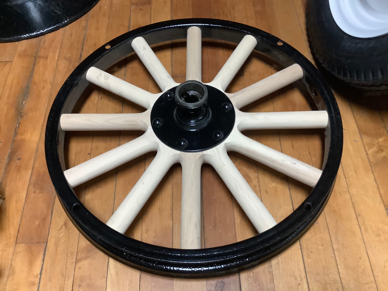

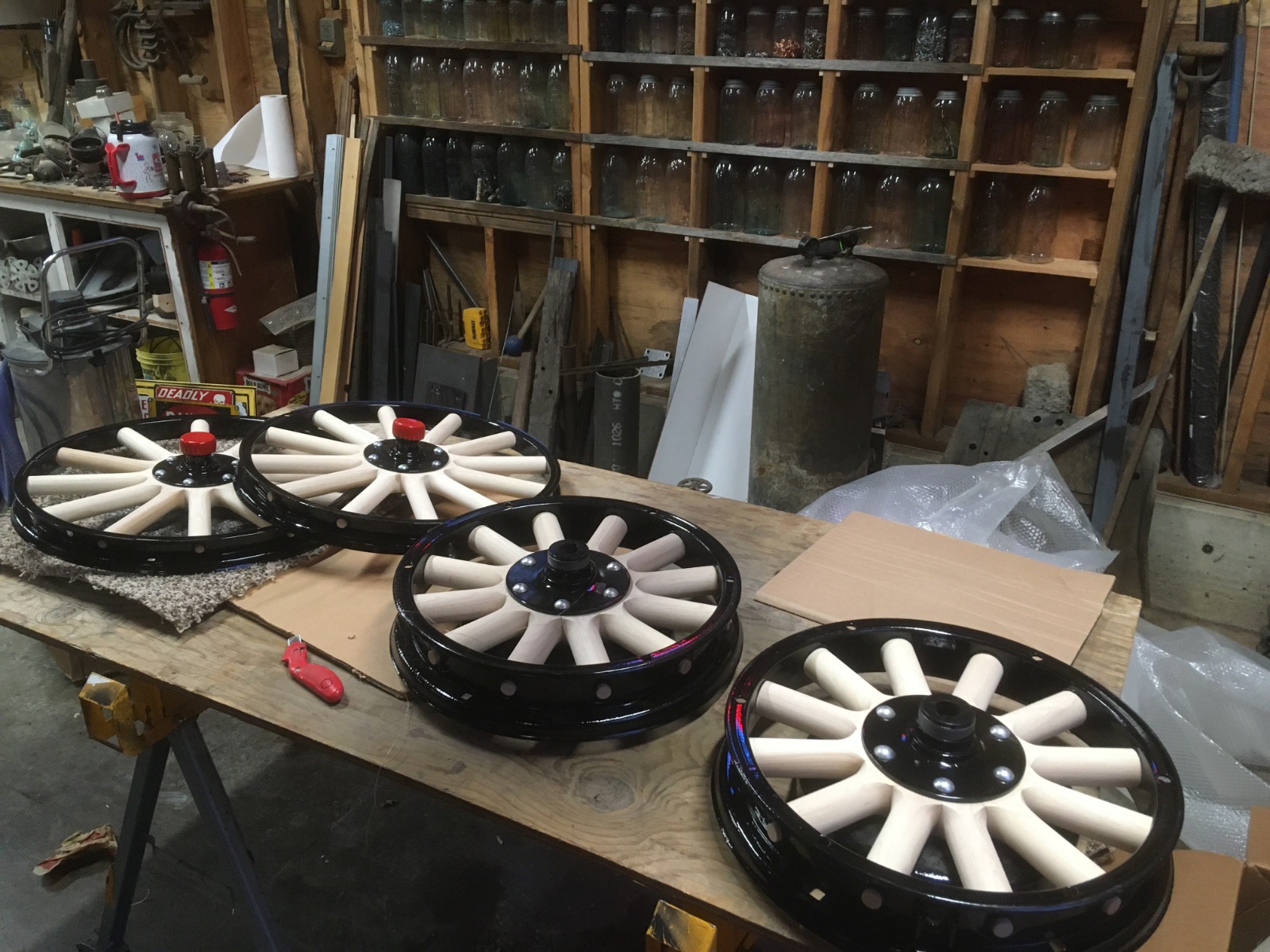

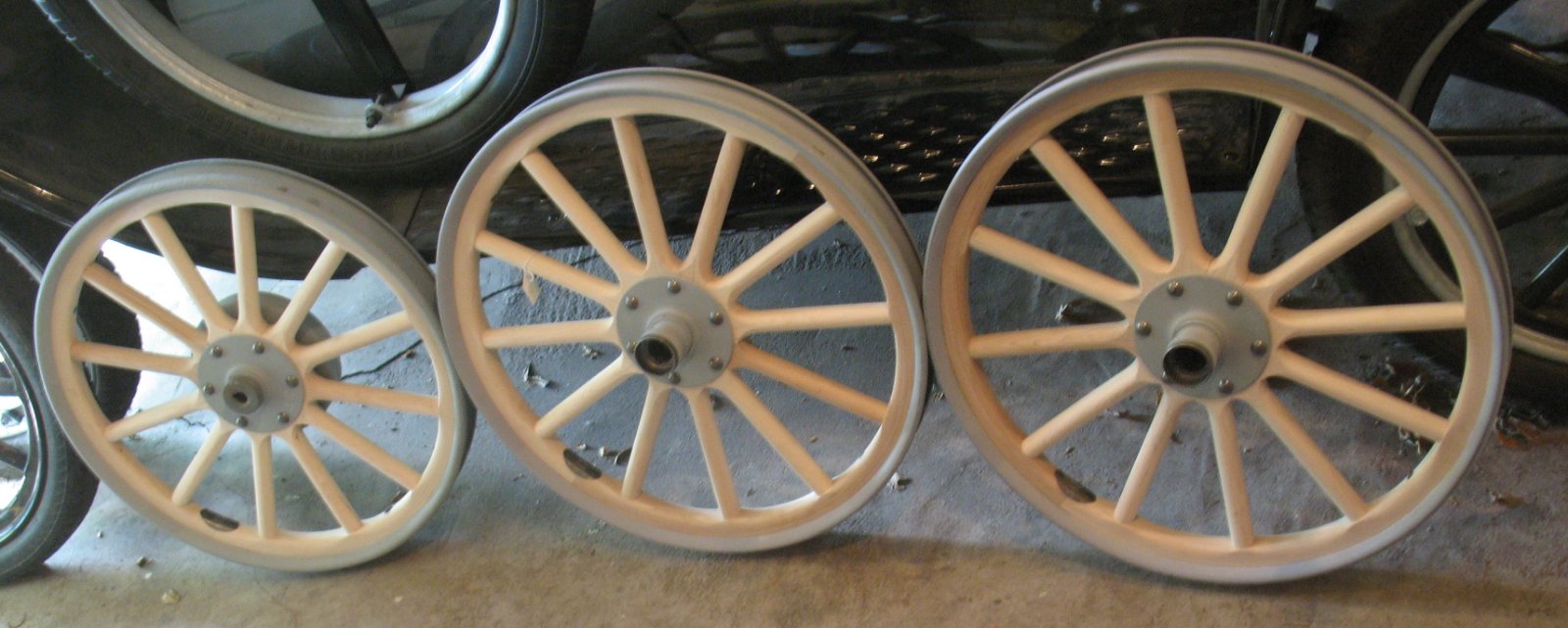

This picture shows how I got a set back that is getting a real nice paint job. There is good epoxy primer under all the wood to metal parts. I’ll do a nice prep job like Walter described above, get some finish primer and paint paint inside the clincher rim, install the tubes, tires, inflate the tires, deflate the tires and then prep for final paint. Mask the tires , paint. Shown is the set of wheels, all ready for that show quality process to start.
I know some people think Henry only made black wheels. I believe they started offering varnished spokes in May1925. That’s millions of cars that could have had varnish from new.
If I were going to paint a set when done, I would do things differently. At the very least, good primer and paint where the wood is going to attach. I don’t think I’d send finish painted parts off to him, nor complete powder coated stuff unless demountable rim wheels for a driver quality car.. That’s just me. Powder coat is so much more durable than paint, but still leaves lots of chance at damage. Seems like wasted work as you would just need to paint the spokes , why not paint all at once when respoked. At least you would have some corrosion protection between the new wood and metal.

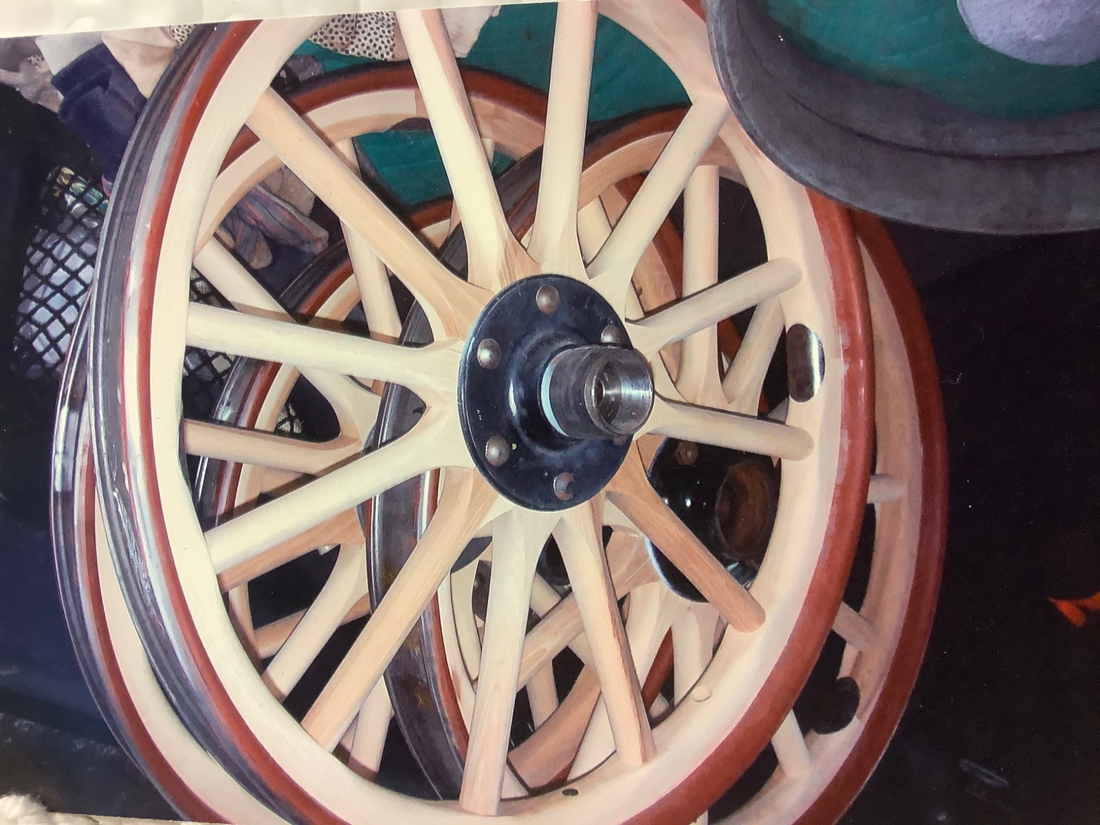

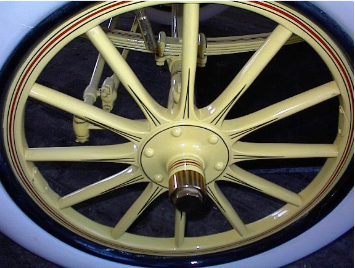

IF you send him powder coated parts, as I described above, this is what you will get back.as you can see, the metal isn’t perfect, but is powder coated for a good driver quality wheel, that will last many lifetimes now. Henry’s wheels weren’t meant to last many lifetimes. If you send him rustygreasycruddybare metal parts, that is what you I’ll get back. I guess it’s up to you how nice a job you want. As we know, people can be penny wise and pound foolish. They do baby buggies to 12’ wagon wheels, they really don’t care. ( also penny farthing humongous bicycle rims, finger jointed steering wheels, etc)

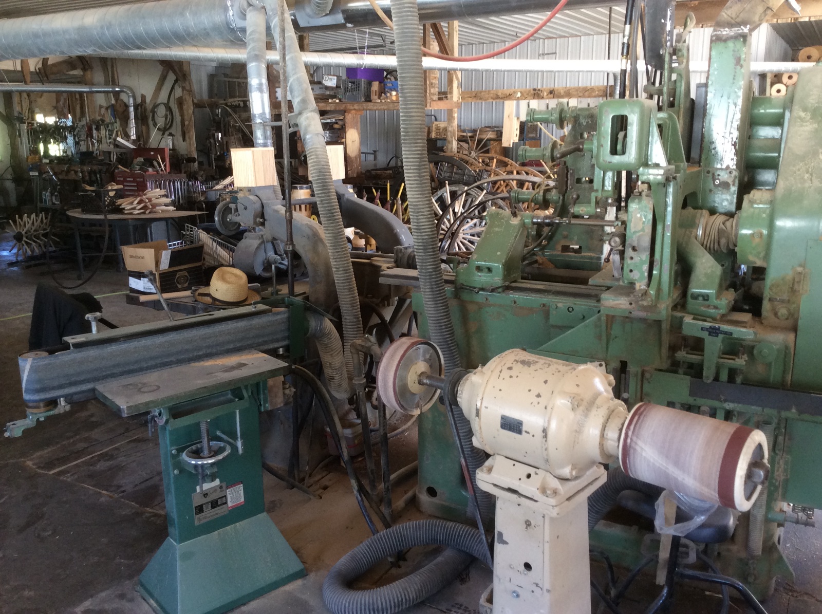

I've been to his place a couple of times and in Noah's office is an impressive assortment of stuff. His exact words to me, "If it is round and made of wood, we will make it". For the early bicycle crowd he has even made wooden bicycle rims with an aluminum extrusion hidden inside such that when it is assembled you cannot see it. I'm not a bicycle person but it looked pretty slick to me.

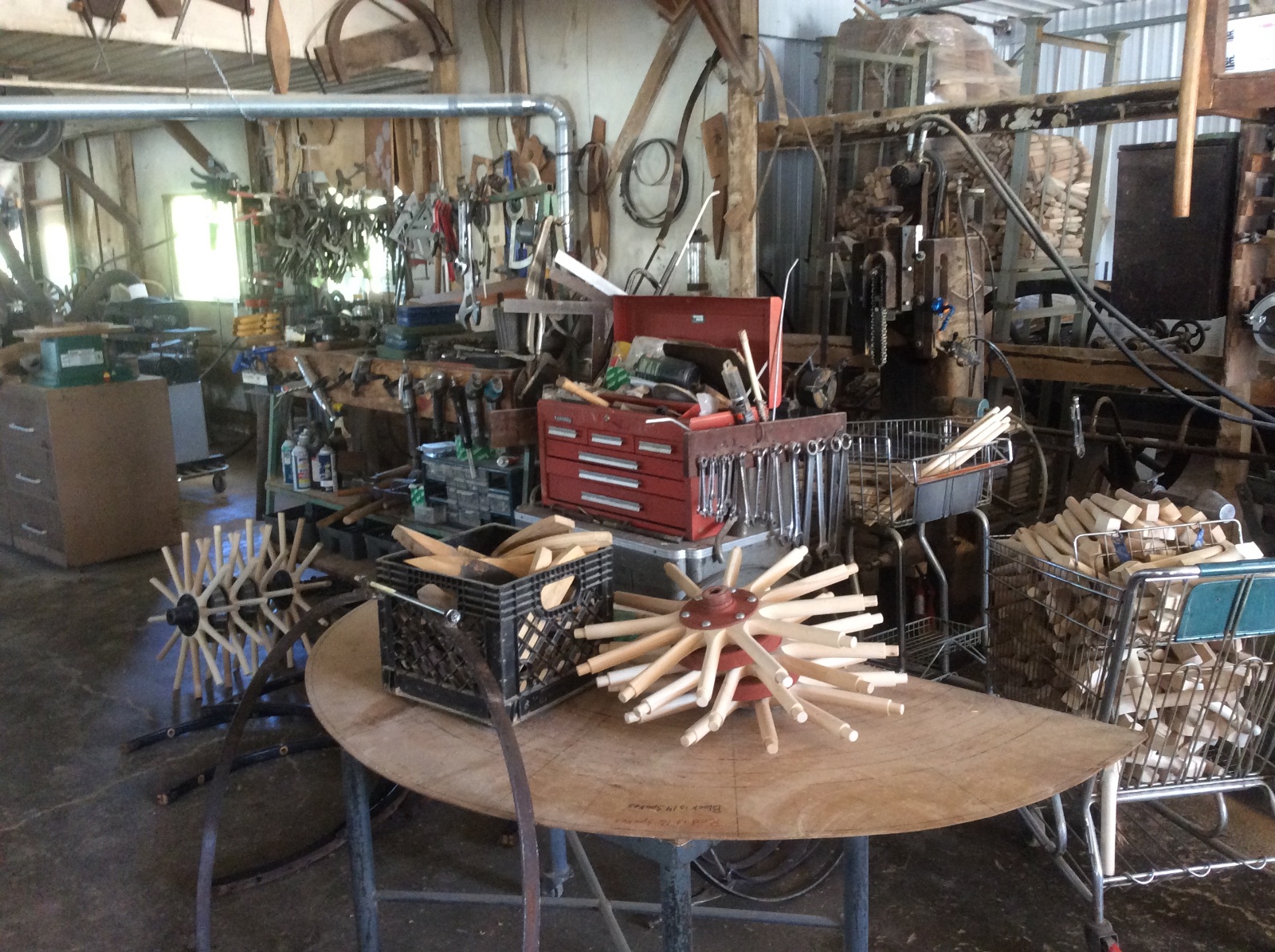

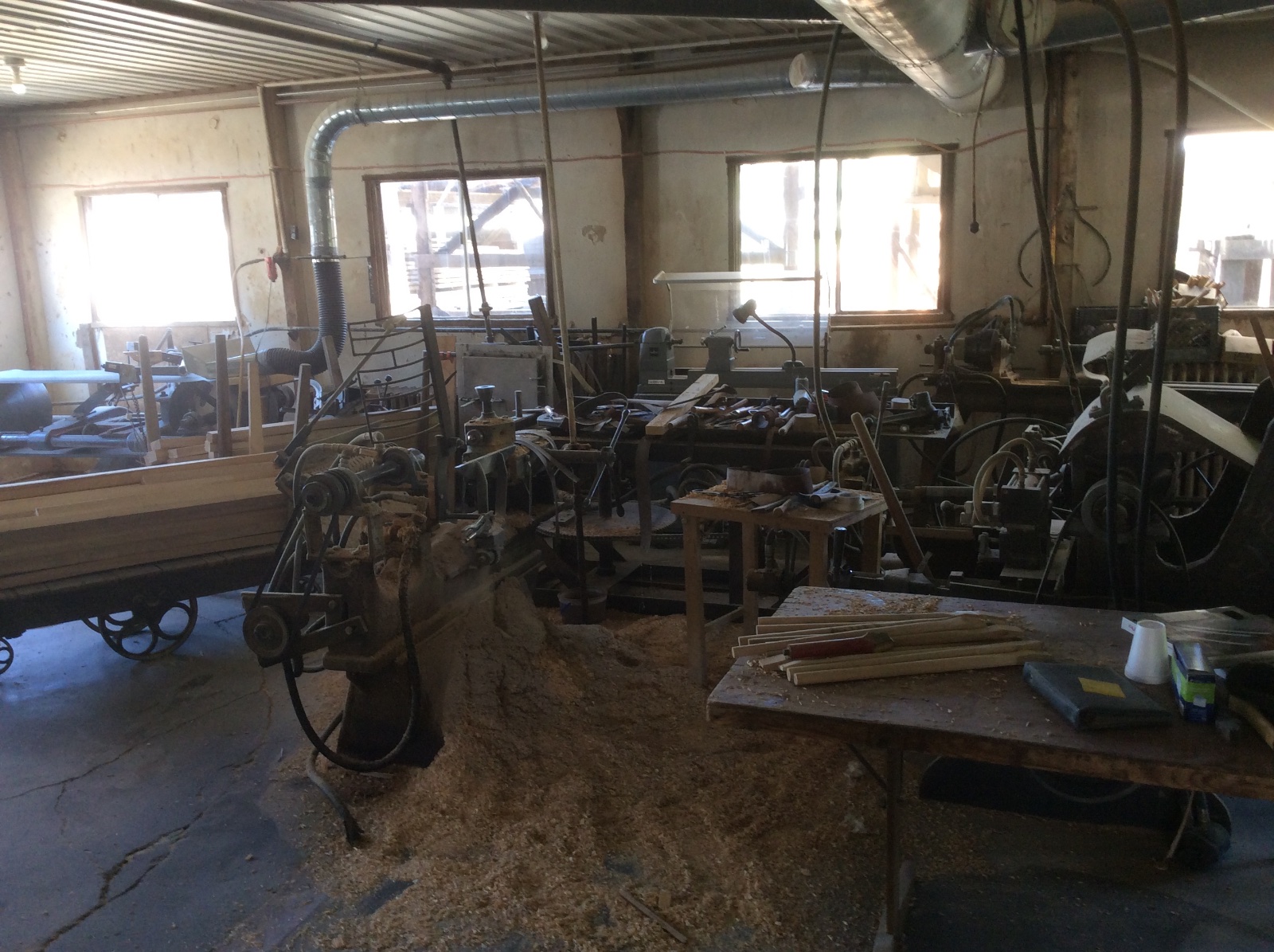

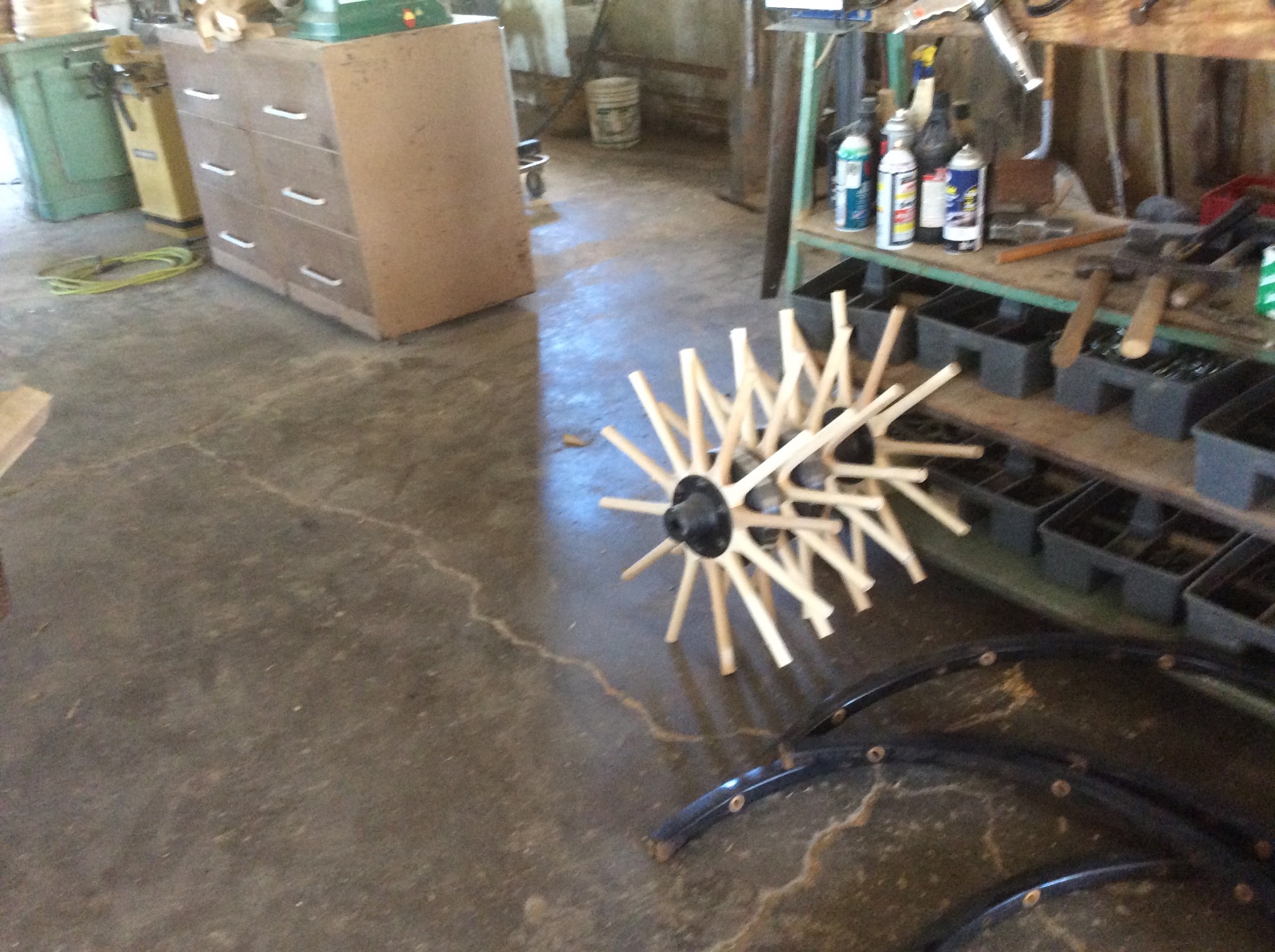

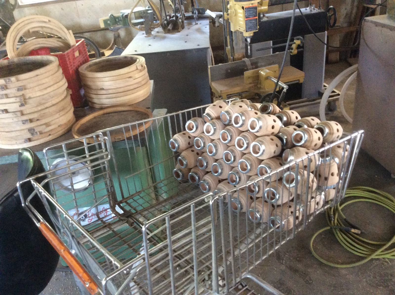

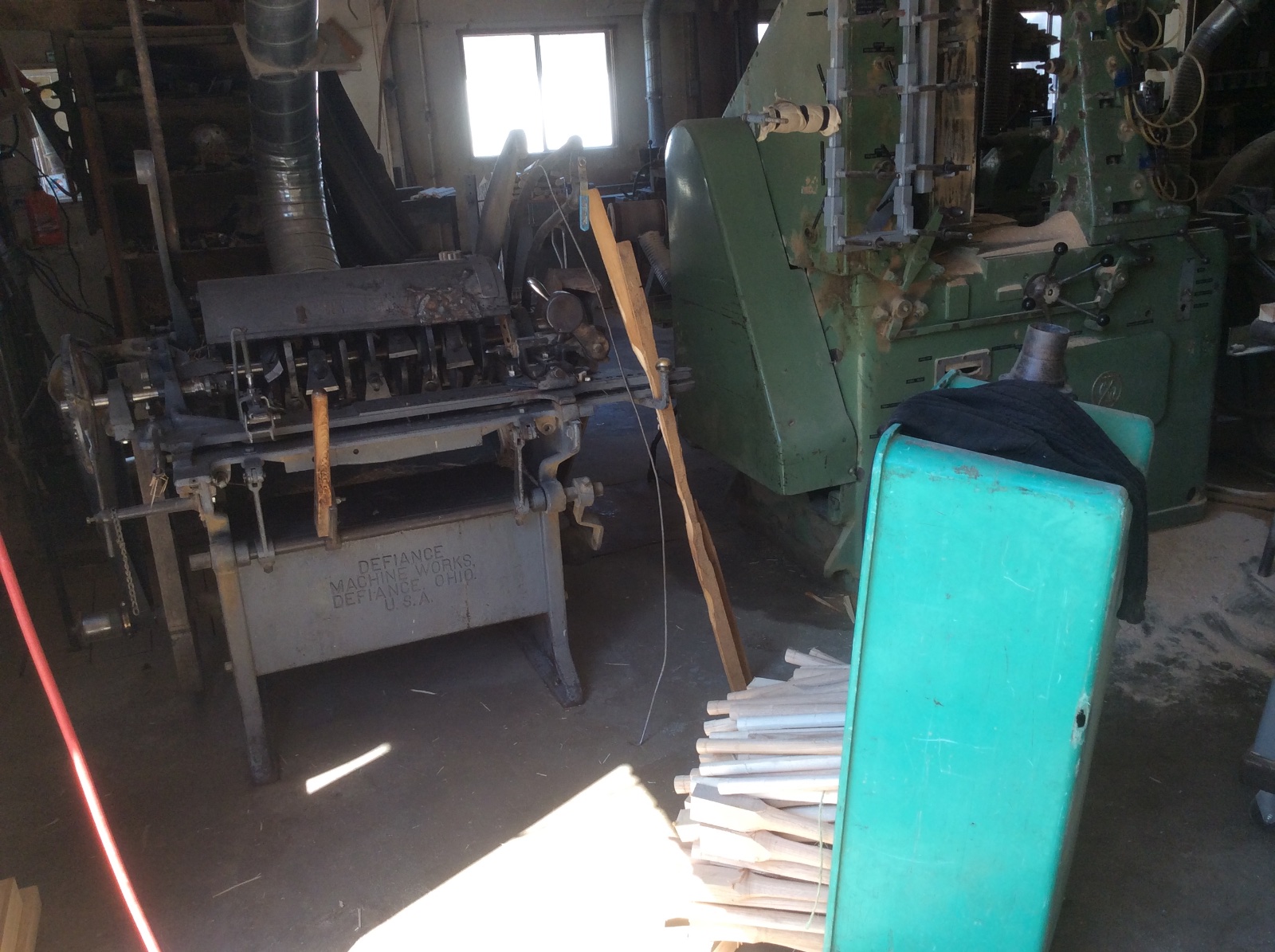

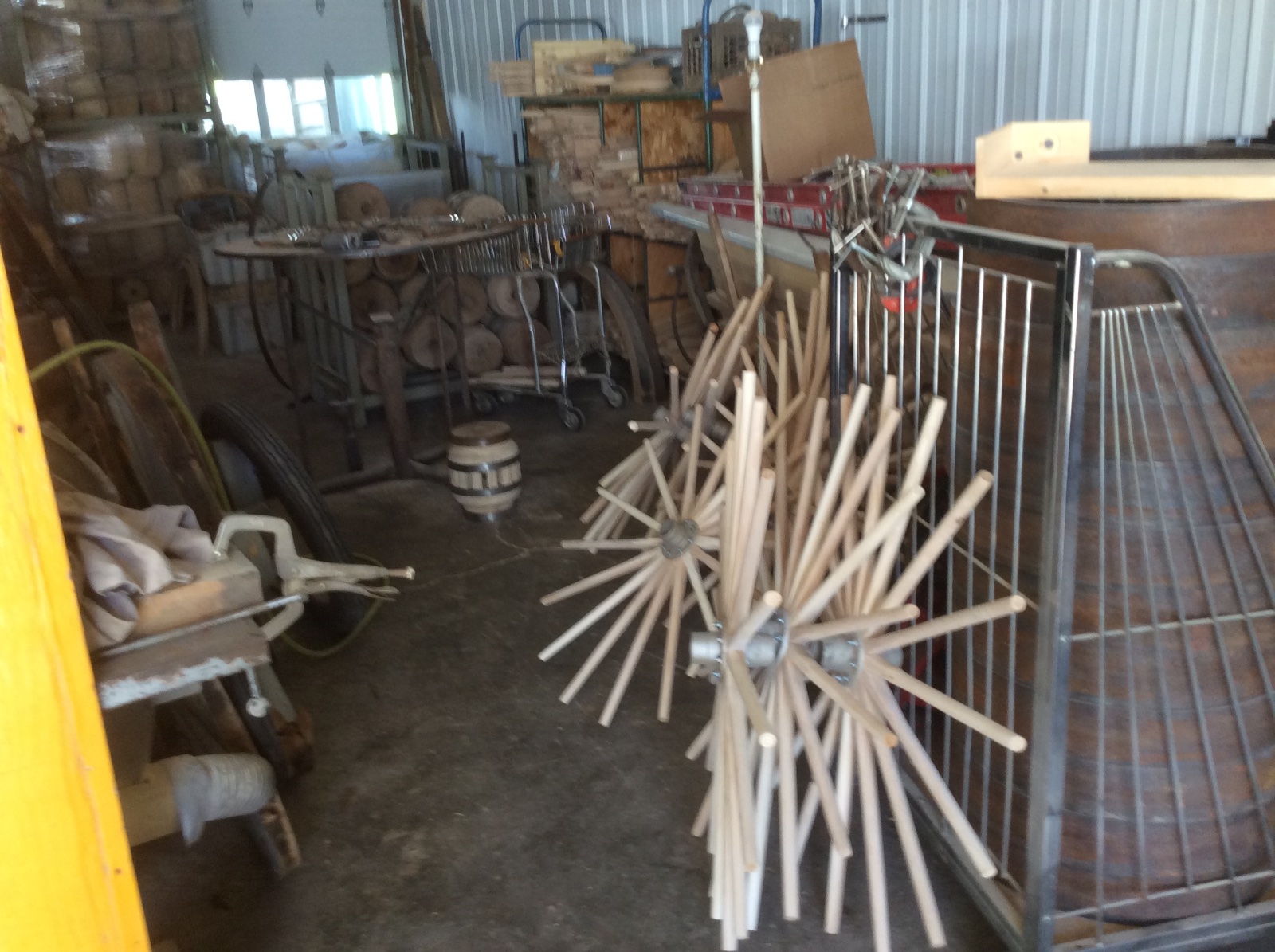

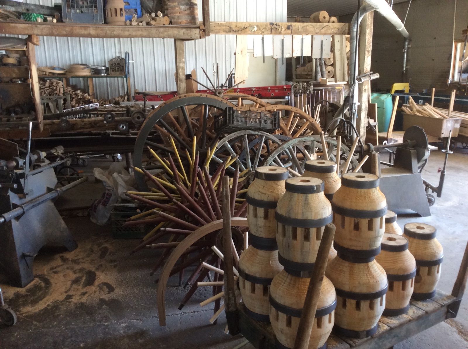

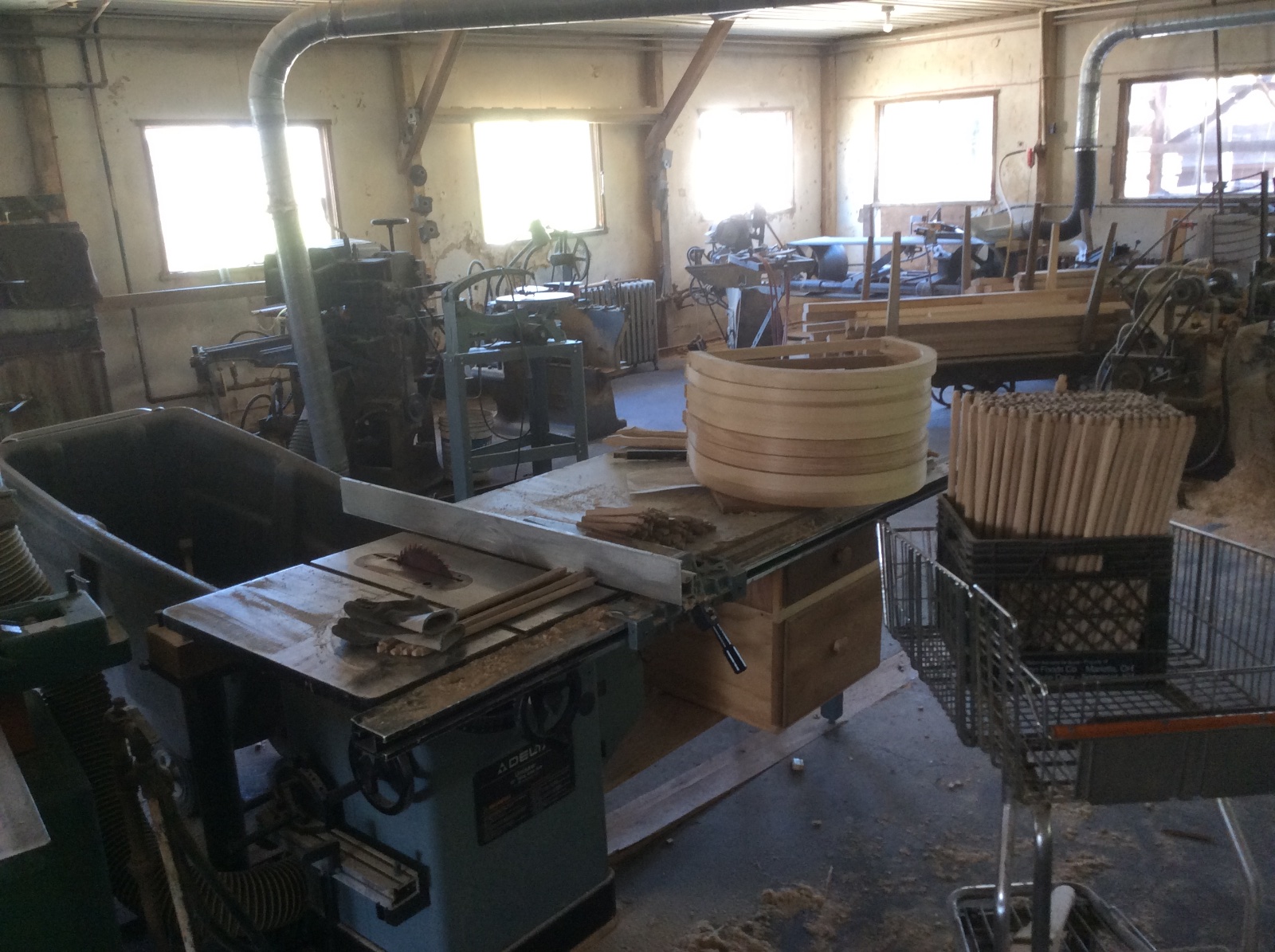

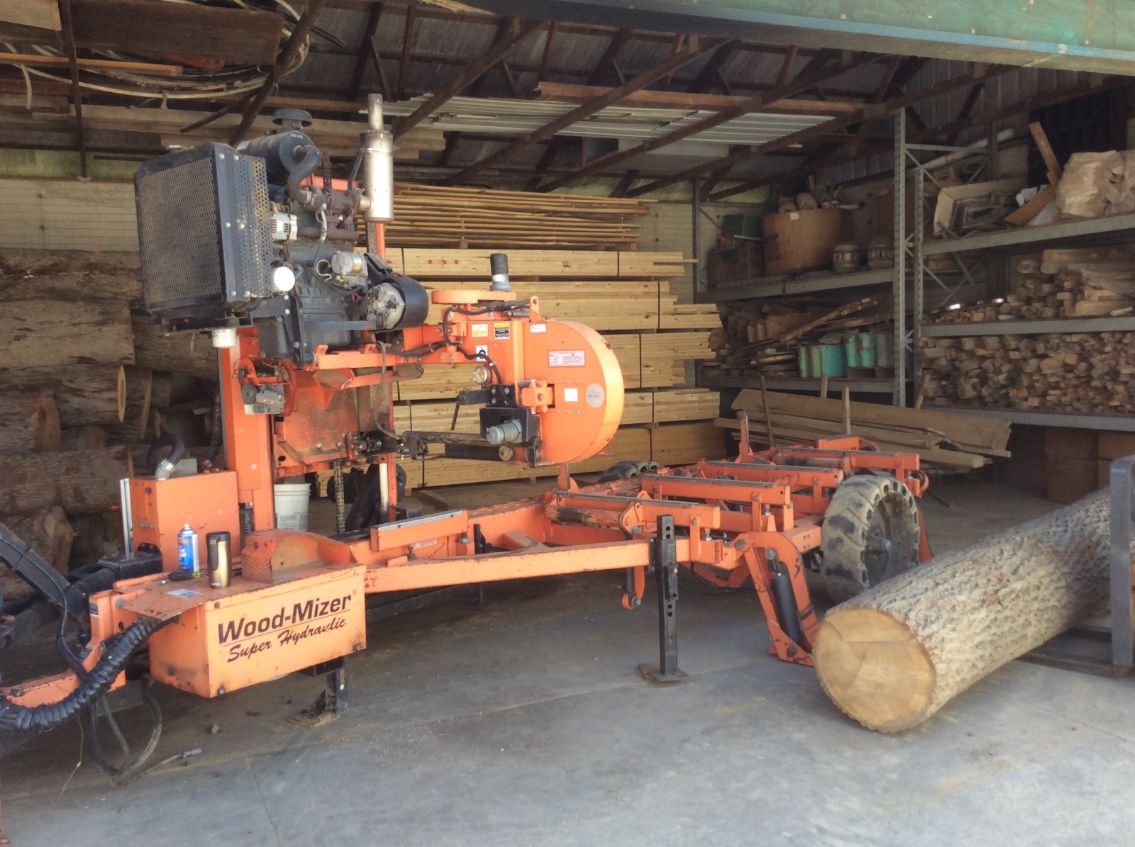

Since the thread is reference to Stutzman wheel shop in Baltic, Ohio , thought I’d share these pics. I’d guess any good wheel shop would be similar, but I don’t know. Need to mention, I’m not a shill for them, don’t intend to speak for them in any way. Just a happy customer after at least a half dozen jobs over 15-20 years, with many friends with the same result. Good craftsman in any field are getting harder and harder to find, and I celebrate the good ones I come across, and just mumble to myself of the clinkers I too often get. PLEASE NOTE the sets of T wheels, in sets as they were sent in to them, in process. They are Amish, so I respected that and had permission to take these pictures while they were having their lunch break. Many use phones and computers, but powered by a generator, or solar panels. For religious reasons, some Amish do not allow their pictures taken , and I respect that. I’m the same way , but it’s because of the FBI most wanted list.

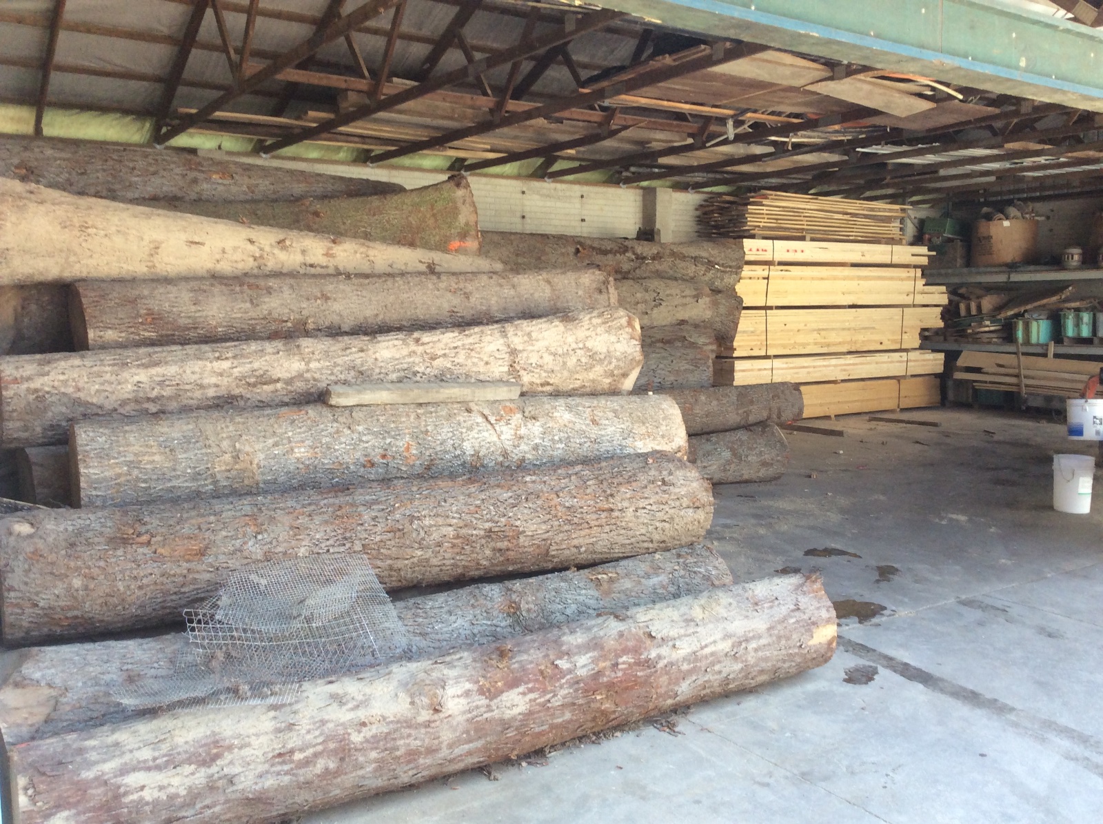

Their relations own and operate huge sawmills in the area, but they have capabilities right on site, also. The area is fascinating, small family owned factories all over the farmland area. Cheese, chocolate, meat, wood wheels, what could be better?

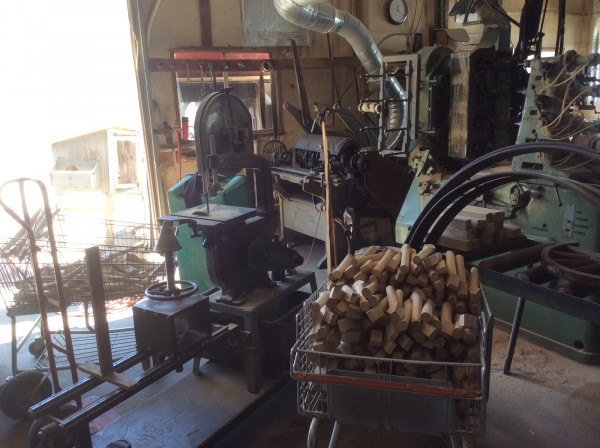

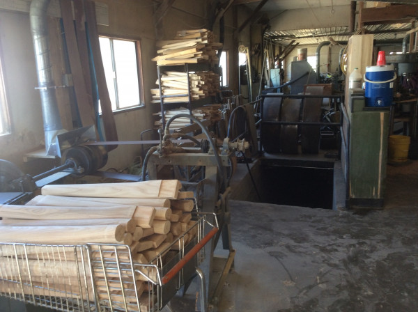

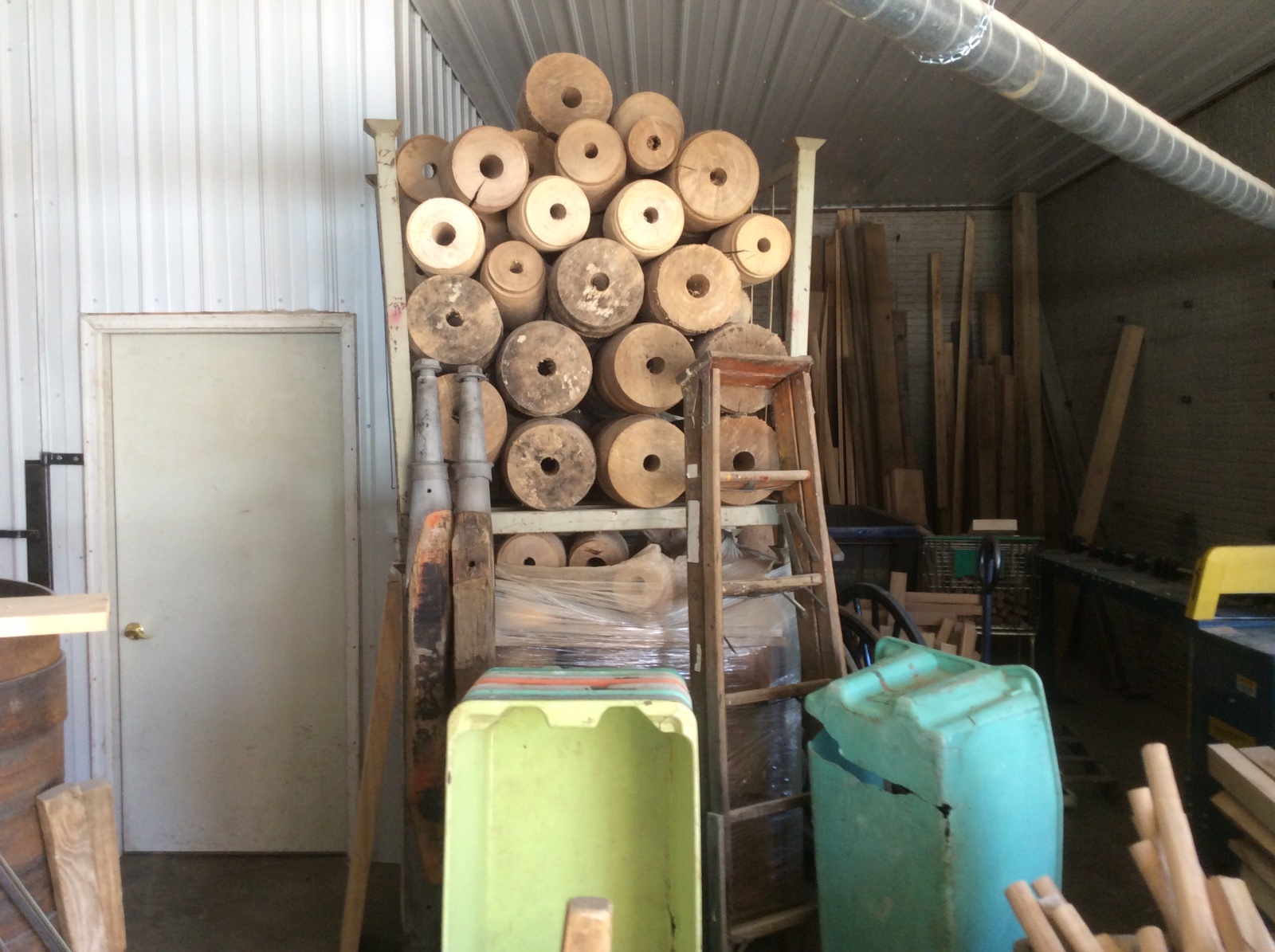

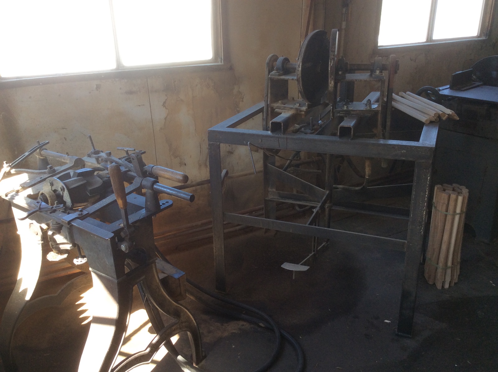

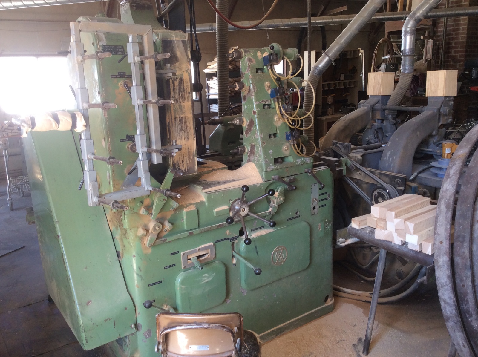

I’ve had several private messages with people amazed at the pictures of the operation. What makes it impressive , to me at least, they are not in the grid. There are no power lines coming in. Many of the tools have hydraulic motors on them. The ones that are electrically operated , are done so by power generated right on site.
I am pretty certain they never sent a finished wheel out missing a spoke !

I must have missed the answer to spokes to bare metal part. I have heard two thoughts on this. One if you powder coat the fellow the coating will wear and leave the spokes loose, the other if left bare metal they will rust and get loose? Is there a diffinative answer if you want to leave the spokes unpainted? Thanks.

Craig, I would never presume to know the correct answer. Some are happy sending bare metal into a wheel shop for wood install. I wrote what worked for me. I’m happy to get them back with that tough powder coat between the spoke and bare metal. Unless the spokes are loose, that powder coat isn’t going anywhere, and gives great protection, and because of the thickness of powder coat, a tighter wheel.

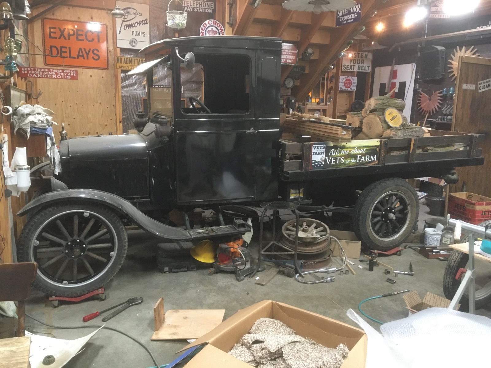

A photo of the stained and installed wheels. I will give them more color from time
to time to get them good and black. Hickory is slow to take color and will take many
applications. No peeling paint for me.

Oh good! I expect we can see the TT back to work soon? Looks like a very nice job.
I got the other side done tonight. Since it has sat for almost a year, I will
spend a little time fussing little details and get it fired up. Maybe go for a
good long run this weekend ?
I have lots of firewood to haul in, so yeah, ... we'll be back to work soon
enough !
