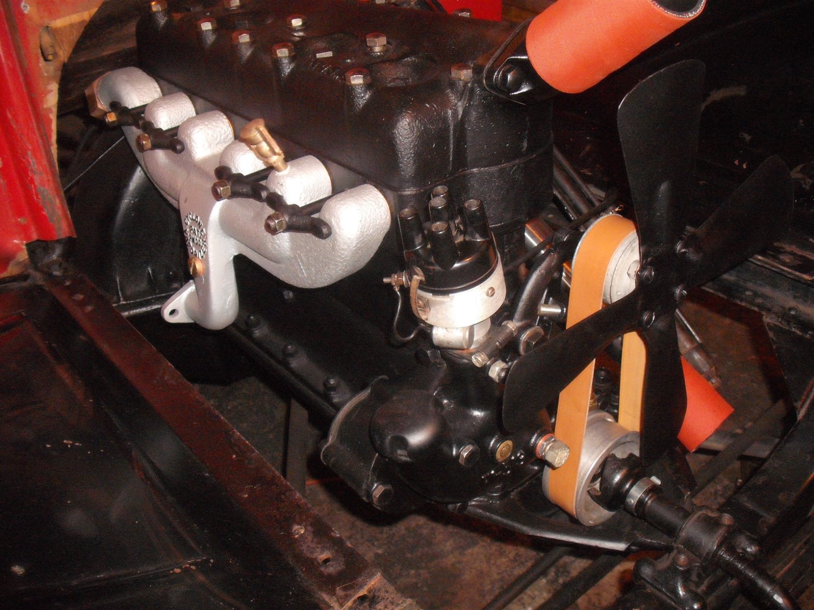

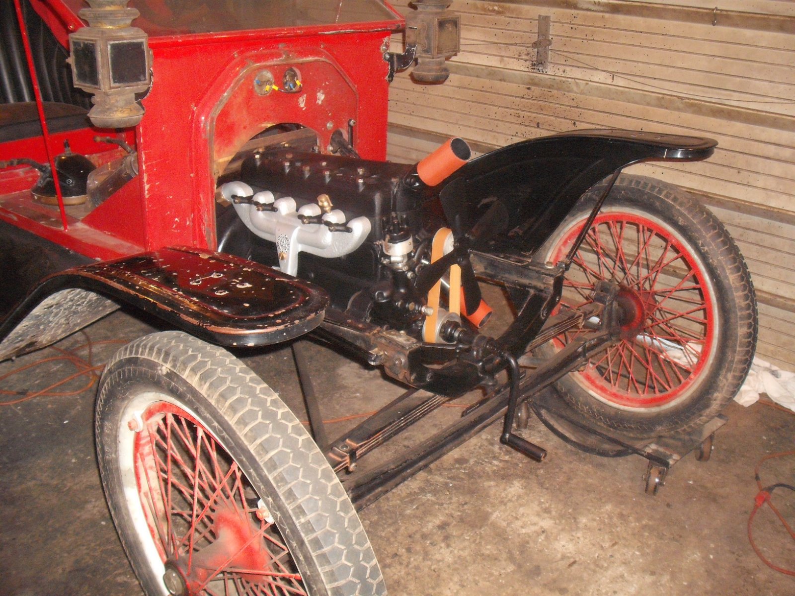

I would like to put a 14 radiator on a 23 frame, has anyone done this or can
it be done? Hose connections upper ,not line up, fan to large what is different
on the frames. Thanks

I imagine you can make the hose connections work as well as the mounting to the chassis. I think the big problem will be in the hood/firewall/hood former area.

I have the hood and former and firewall correct, would a low head be the difference in the space between the two hose connections.

Cylinder head outlet casting is different on a '23, brass radiators are lower, so the earlier casting is at a different angle. That's the only difference I'm aware of.

Thanks Rich that is what I was looking for. I think I will have to change the fan also, it hits the upper hose connector.

You will need to replace the fan bracket to the earlier "bent" one and put on a shorter fan belt. This might pull the later fan down to clear the radiator inlet. Note: the correct fan will have a smaller hub than the '23 fan. Not entirely sure what you're ultimately trying to accomplish, but the correct fan will also give you "the look" you're apparently looking for.
Also, going from '23 fan to early fan will require you to change the crank pulley from 3 3/4 dia to 3" dia in order to use the correct 23" fan belt, plus not overspeed the fan.

Sam, My 14 speedster with a brass radiator has a 27 engine with a high head. The only things I changed on the engine were the outlet hose casting on the head and changed to the bent fan arm. I have a later fan pulley using an earlier style fan blade and the large crank pulley. After it was all in place I used a piece of string to measure the fan belt and bought the size I needed. It all works well.
There really are no issues with the frame as to mounting the radiator. , other than a few small holes for the hood shelf being in different locations , they are all the same as to function.
have fun and be safe .........
