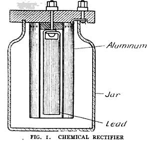

To produce a period magneto battery charger consider this.
Dykes motor manual mentions a Warner battery charger for the Model T. The Warner system uses a wet RECTIFIER to convert AC from the Magneto to DC to charge the battery. The device would either be mounted on the outside running board, of if you had a coupe/roadster it could be inside the turtle back.

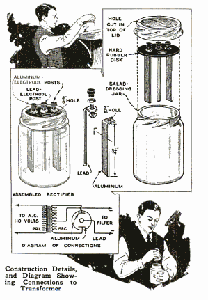

The electrolyte is a borax and water mixture. Popular Mechanics for 1924 and 1929 describe how to make such a RECTIFIER.
From an alternating current, such as the magneto, it is converted to D. C. with a light to control current/voltage. The jar’s two outer electrodes are aluminum, and the inner electrode is lead. The center becomes the negative DC voltage and the center tap from the transformer becomes the positive terminal for the DC voltage. (see from POPULAR MECHANICS, Oct. 1929, P655)
From 1909
From 1929
(I am not taking any responsibility for anyone attempting charging a battery with a magneto this way. This is presented to show others now long dead have looked for ways to charge a battery with a Model T Ford magneto .)
