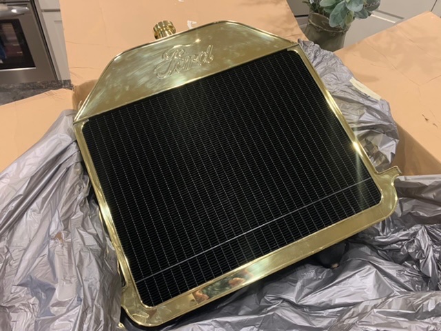

The 13T’s new radiator came in from Brassworks today. I’m thankful for their knowledge and experience to produce such a beautiful part of the T.
Darin

Those new brass rads sure look nice don't they Darin.
Piece of advice/suggestion...the area of brass from the gas pipe downward, being the narrow flat front trim piece and even the horizontal flat section where it bolts onto the frame...I learned to mask that section from the rest, and spray them with gloss lacquer. It does a great job of protecting it, especially the horizontal flat bracket section, which is all but impossible to really keep polished 'cause it's just plain hard to get at, plus the bolt/cotter pin gets in the way and likes to grab ur skin. The lower front trim piece takes a beating from the road grime also, and this really keeps it looking good. Do what you want, just a suggestion.

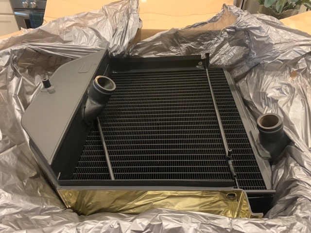

It sure is perty. I love mine. Did you notice the tag on the under side of the top tank?

Tim - Sounds like a great suggestion.
Keith - I did not notice that Brassworks tag/serial number until you pointed it out. Thank you.
This radiator is an exciting part to get in. It is a center piece of a brass era Model T and will, hopefully, be the last major part needed on this restore to get it initially back on the road. I know there’s a lot of parts in the future to keep the old girl on the road... but one step at a time!
