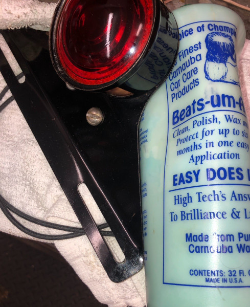

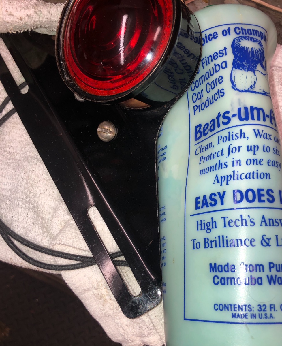

Post by DanTreace » Fri Aug 28, 2020 11:20 am
Like Frank posted, the best wax contains Carnauba wax.

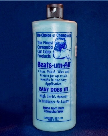

For years have used Beats-Um-All. You can't find it at stores, sometimes at car shows, but you can find on-line dealers or the mfg. for direct order. Isn't cheap, but is pure Carnauba wax. Works on all finishes. Leaves no white residue.
Just used it on this NOS aftermarket tail lamp. The old enamel was dull and dirty, but have learned over the years don't scrub or use grit polishing compounds as you will streak and scratch the old finishes. Just a little wet on the rag, and pure wax to clean the surfaces, then lightly wipe off for a shine and preservation. ;)
